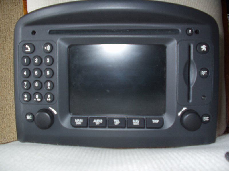

I've got a Ducato Connect Nav+ that I considered fitting in the Stilo for the "phone home" function. It can send a text message of the vehicles GPS location. I though it could work as a tracker if there was a way to program it remotely. Problem would have been making professional looking front panel though.

I think any of the Fiat/Alfa Connect Nav+ units will fit in the carrier and the wiring would be the same for all of them. Making a suitable front panel would be the only problem.
