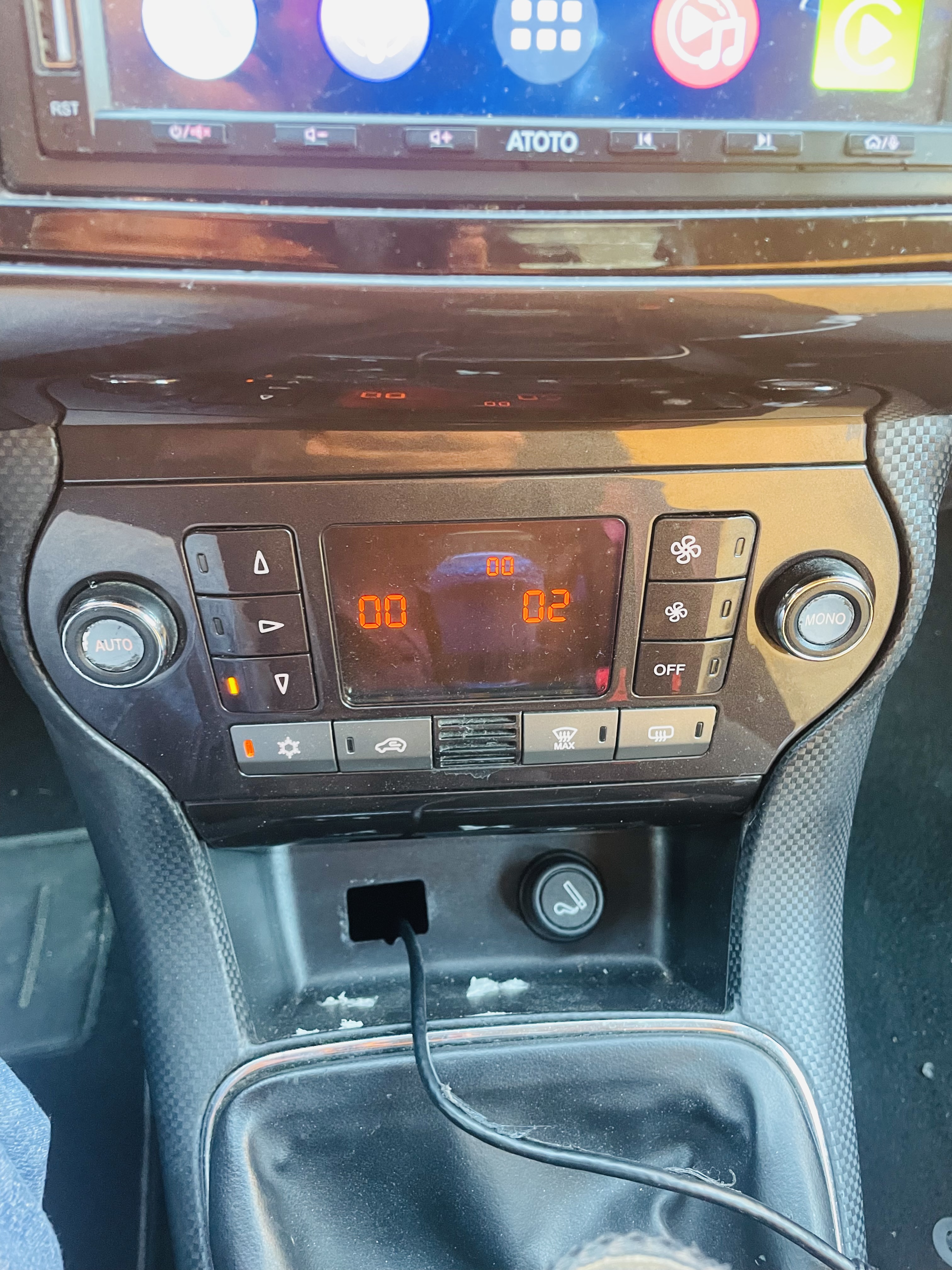

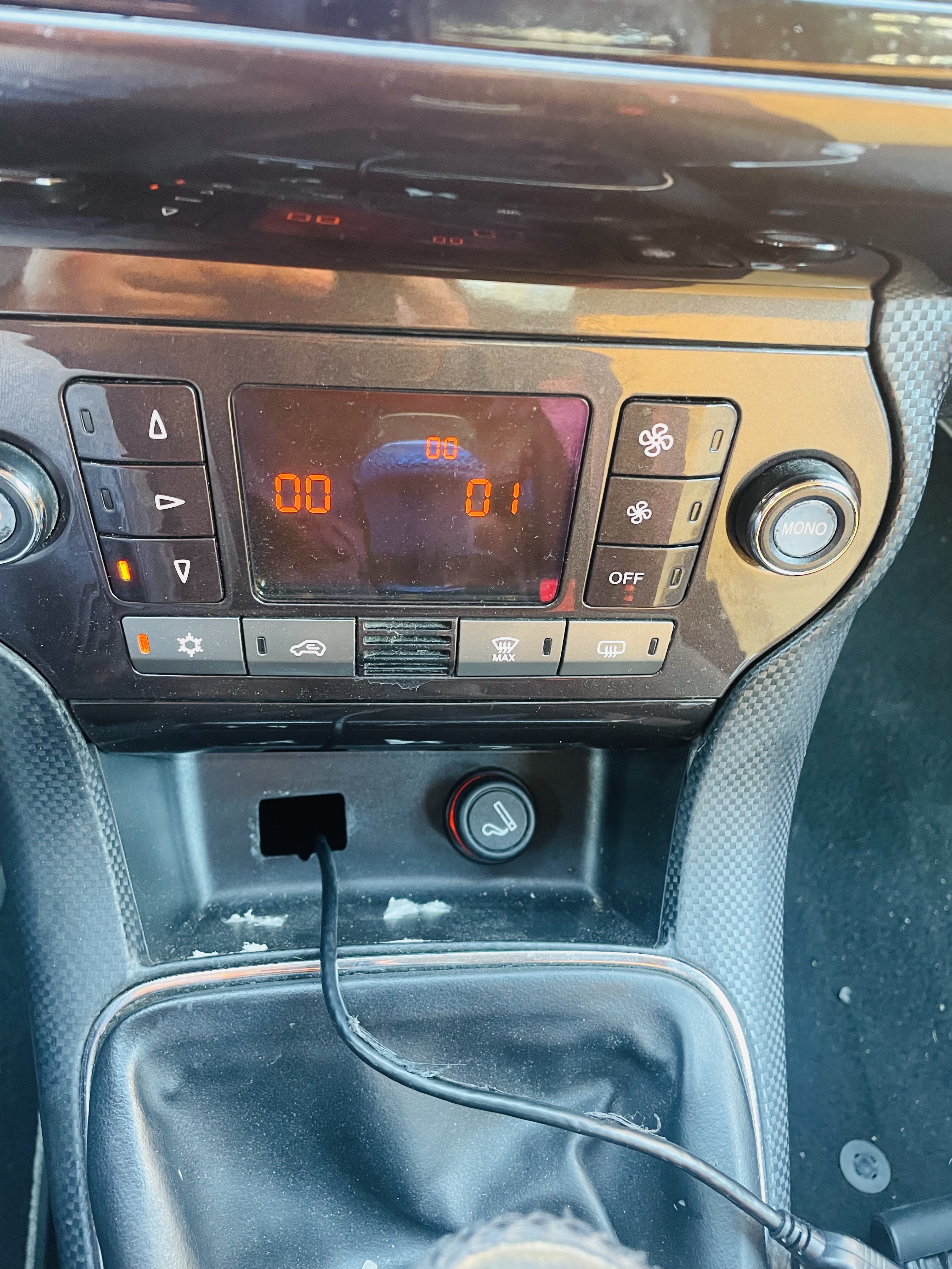

Hi
I performed these steps for reset.
But passenger side was first with 02 (not blinking) and after some seconds passenger side was with 01 blinking all the time. And then there was some sound inside ac unit like it was starting again
BUT at the end same problem is still existing
Can you please see attached pictures and guide me with next steps

Airflow control flaps are operated by an electric motor and a plastic link that usually breaks. Most likely, this is the problem, as the solution is quite laborious, the entire dashboard is removed.
