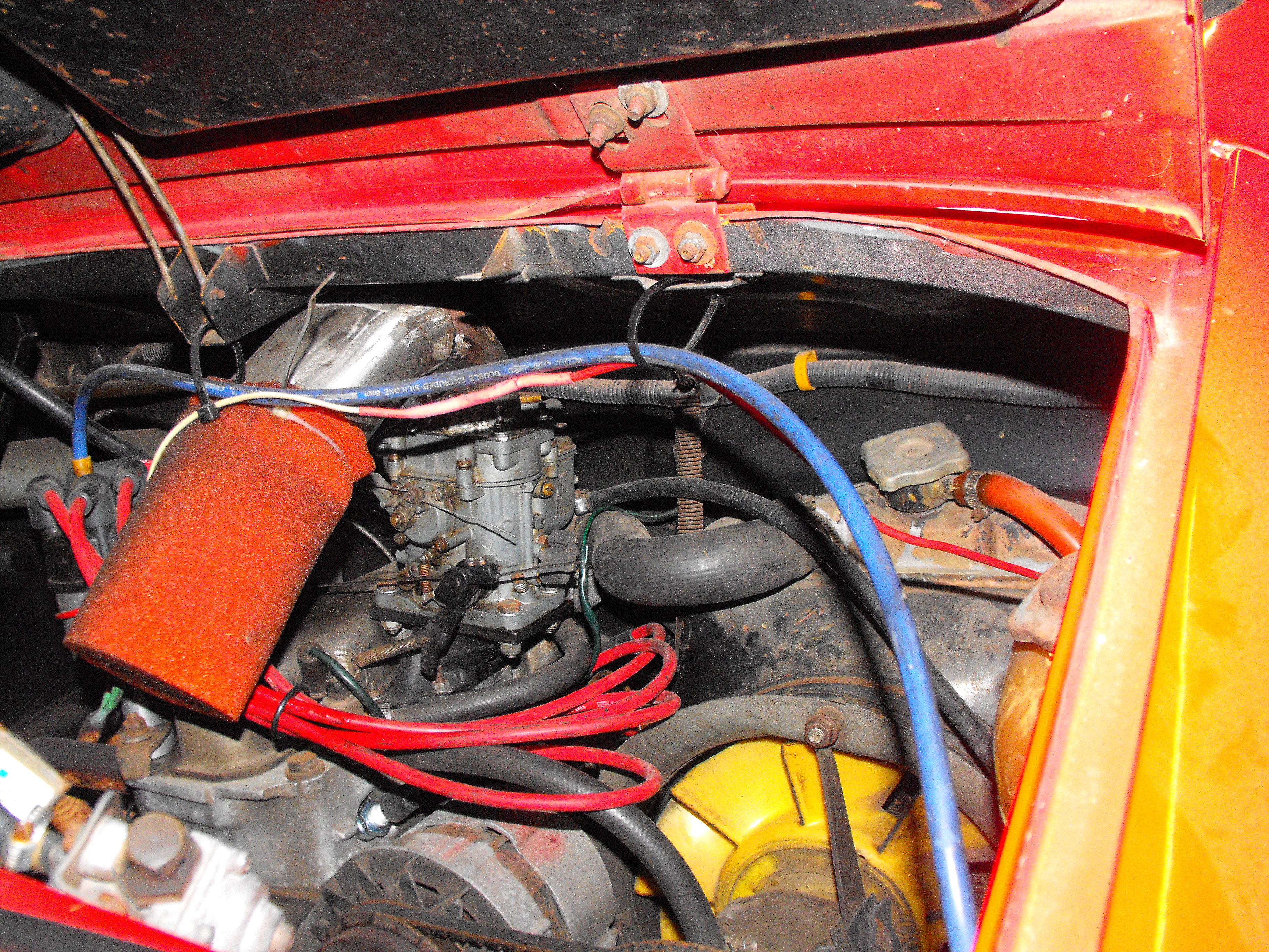

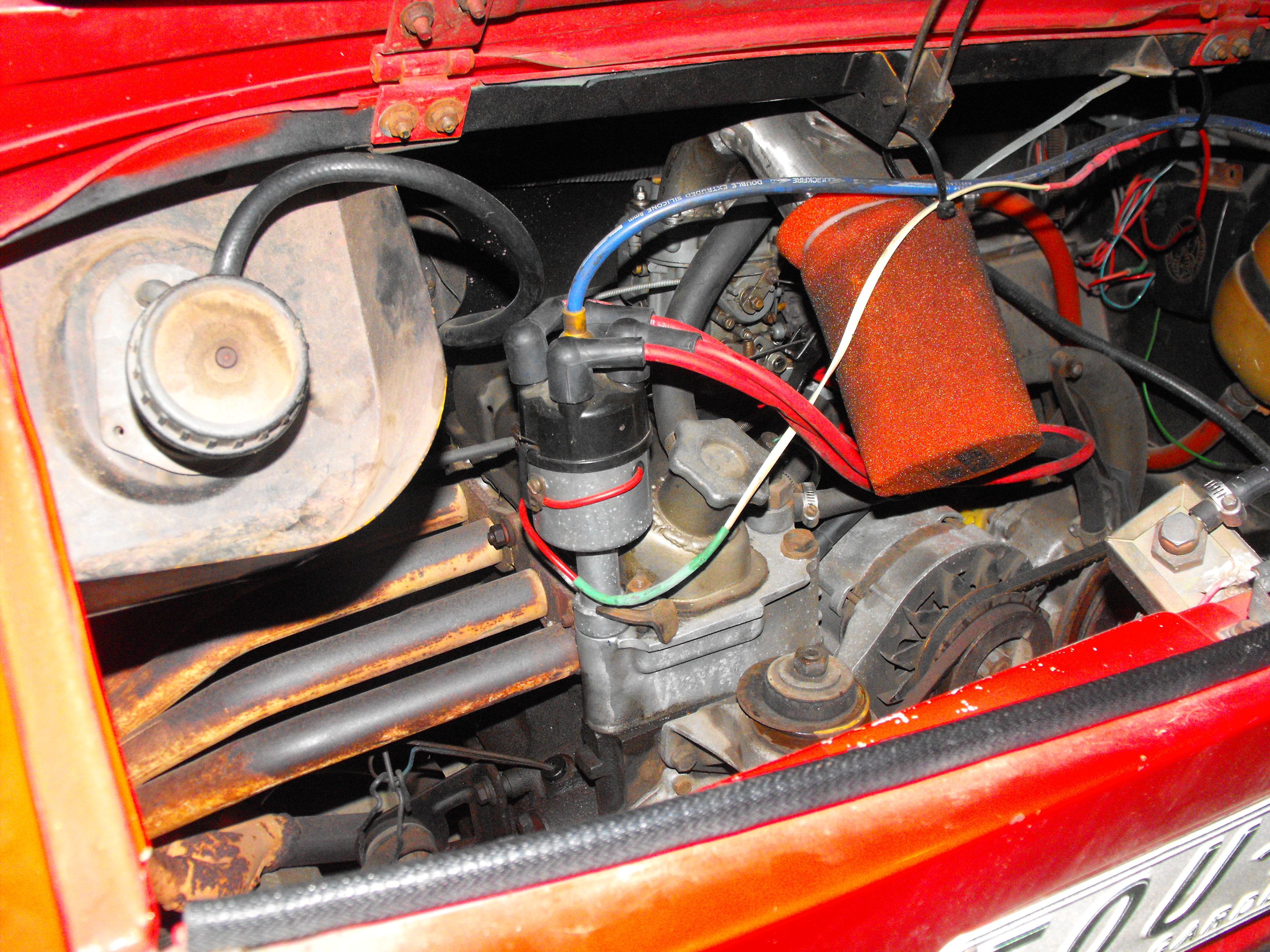

Before fixing the gearbox issue, needed to get the car mobile. Symptoms were extremely hard starting, and running rough between 2000 and 5000 rpm.
Pulled the Ducellier distributor apart, and reshimmed the shaft as it had several millimetres of up and down play, thinking that it was causing issues for the electronic ignition sensor. Probably 8mm worth of shims in total. Put in a couple of copper washers too, thinking they may wear instead of the aluminium distributor housing. Also changed over the distributor cap and rotor as they were showing signs of wear. I have a preference for the Ducellier distributor over the Marelli one, it seems to have less slop in the
bearings. The cap also seems to have a more positive engagement when locked down.
Built a test jig with spark plugs, coil and mount for distributor. After hooking up power and spinning the distributor shaft with a drill, found one of spark plugs was sparking erratically - ah ha! Replaced the dodgy plug, and put everything back on the car.
That did not fix the problem with bad running. Hmmmm, on to next step.
Pulled the carburettor apart checking for blockages, and reassembled. All nice and clean again.
Nope - still no good. Running out of ideas. :bang: After some head scratching and reading through a few articles, thought it could be a vacuum leak. But I'd already replaced the manifold gasket as well as carburettor gasket. Where else could there be a leak? Finally figured out that the port which I'd taken as a EGR port, was actually a take off for a vacuum advance distributor.
Doh! It was connected to the air cleaner, providing ready access for air to bypass the primary barrel in the carburettor. Weird thing is that the car has been running OK in this configuration for several years. Quick scrummage around in the garage for a bit of rubber to block the port.
Finally, with the battery charger switched to maximum boost, leads connected to the car, looking like a garage version of Dr Frankenstein Lab - THERE WAS LIFE. Albeit farting,spluttering and popping, there was the familiar 850 sound missing for so long. While the car was starting at least, it was still misfiring, with nice flames shooting out of the exhaust. Back to the drawing board.
Last roll of the dice. The car has been sitting around for more than a year, maybe the petrol is off? Is this just a urban myth? According to some articles on the web, petrol can oxidize in the tank over time, and volatiles evaporate off. Jacked up the car, unscrewed the tank drain hole and dumped the petrol. Ran the electric pump, to check the tank was empty, and noticed petrol kept circulating through, with nothing coming out of the bottom drain hole. WTF? There must be a pot or baffled area which the pickup sits in. Took off the return line and pumped the tank empty. Also removed the main jets to empty the bowl in the carburettor. Out with the old, in with the new - some of Mrs Shell's best brew. Unfortunately it was also 11:30pm, so thinking of the neighbours had to wait till the next morning.
Woo hoo - problem solved. Starts nicely, and the misfire is gone!
Next job, do some tuning of the jets to stop the plugs sooting up, eradicate a little hestitation when flooring the throttle, and maybe some better economy as a side effect.
