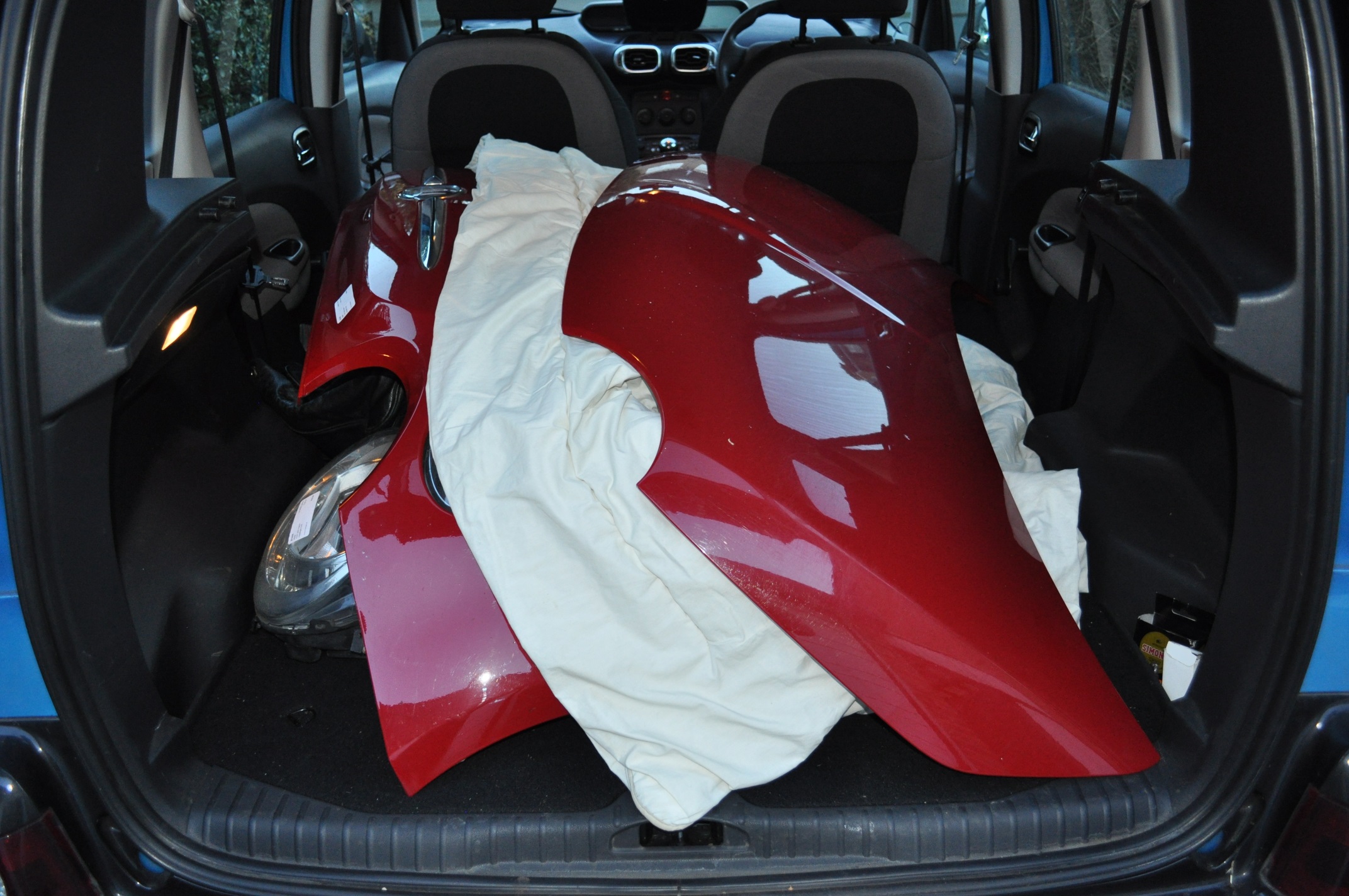

They also had a bonnet - it's in pretty poor shape, faded & lots of lacquer peeling but it was £60 and I was there with a big enough car so I took it, it'll certainly do for now. Also a pair of undamaged front lights for £50 - those might end up on ebay, we'll see how everything lines up.
Not sure the red is quite the same shade, we'll see - super happy with the price either way though, I even managed to scavenge the missing screws needed for the top of the bumper and some I was missing from the undertray.

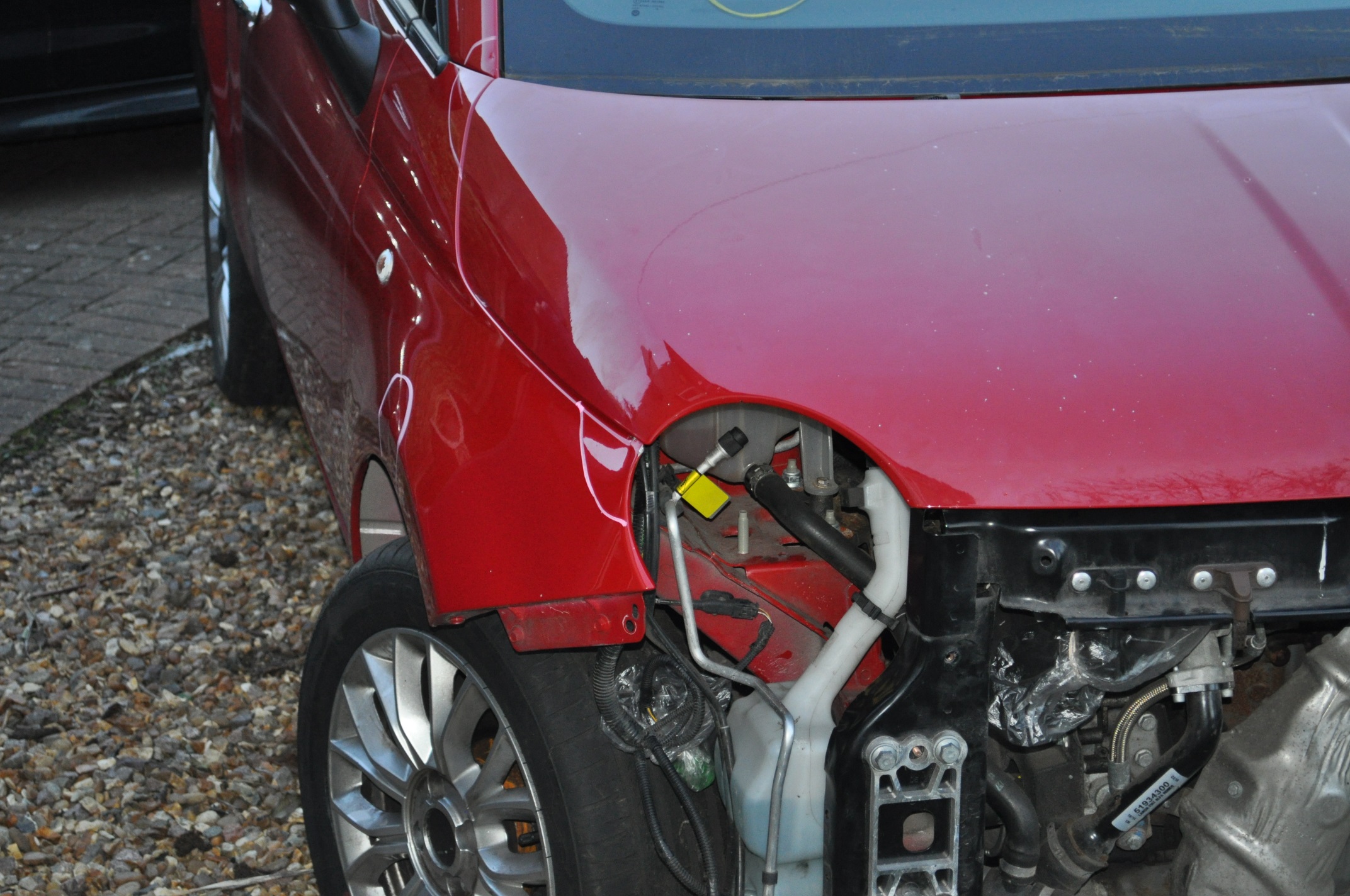

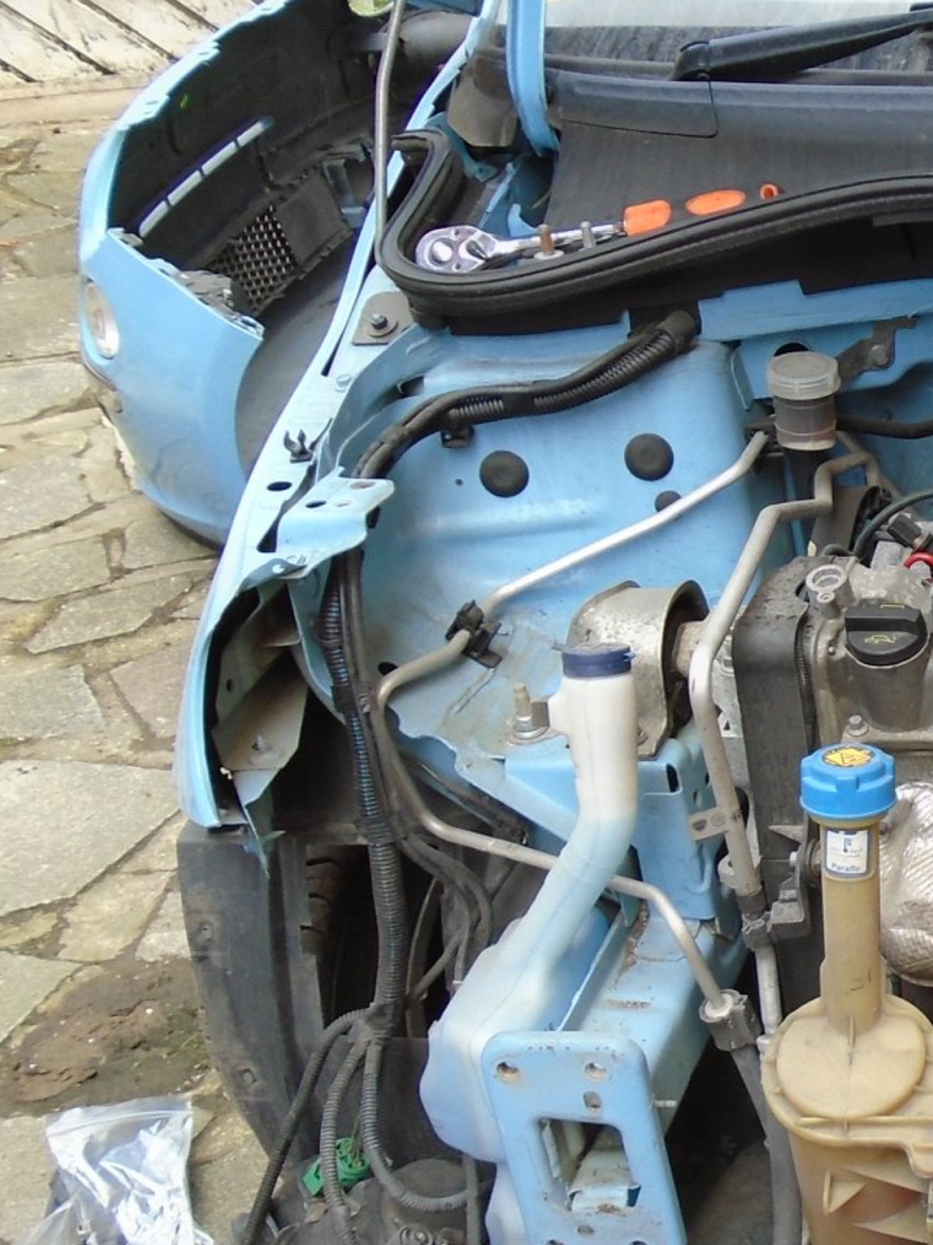

* fit new hinges - these are currently only loosely screwed down, it's very easy to adjust them in situ if you take the wipers and scuttle panel off.
* test fit new bonnet - it's got loads of stone chips and a lot of flaking lacquer - I'm sealing these in bit by bit by applying a very thin lacquer which gets sucked into the delamination stopping it getting worse. Ideally needs a respray.
* adjust wings slightly - they've both flared out towards the top of where the light fits as they were shunted upwards by the crash - the driver side is worst, I'm pretty much at max adjustment, next step is to call a dent removal specialist to see how they can help, this wasn't possible without a bonnet in place to give a guide. if the problem can't be corrected I might be looking for a pair of wings.
* tried to correct the bolt distance of the rail flanges - pulled it in to 940mm with a giant ratchet strap but it just went back to 949mm as soon as I released it despite leaving it on for half an hour. yes it's a monster ratchet strap, anything smaller would break!
I really need a photo of the wing edge/front with the bonnet open on a car with a totally undamaged wing. I'm not sure what shape the metal should be where the bonnet closes over it.

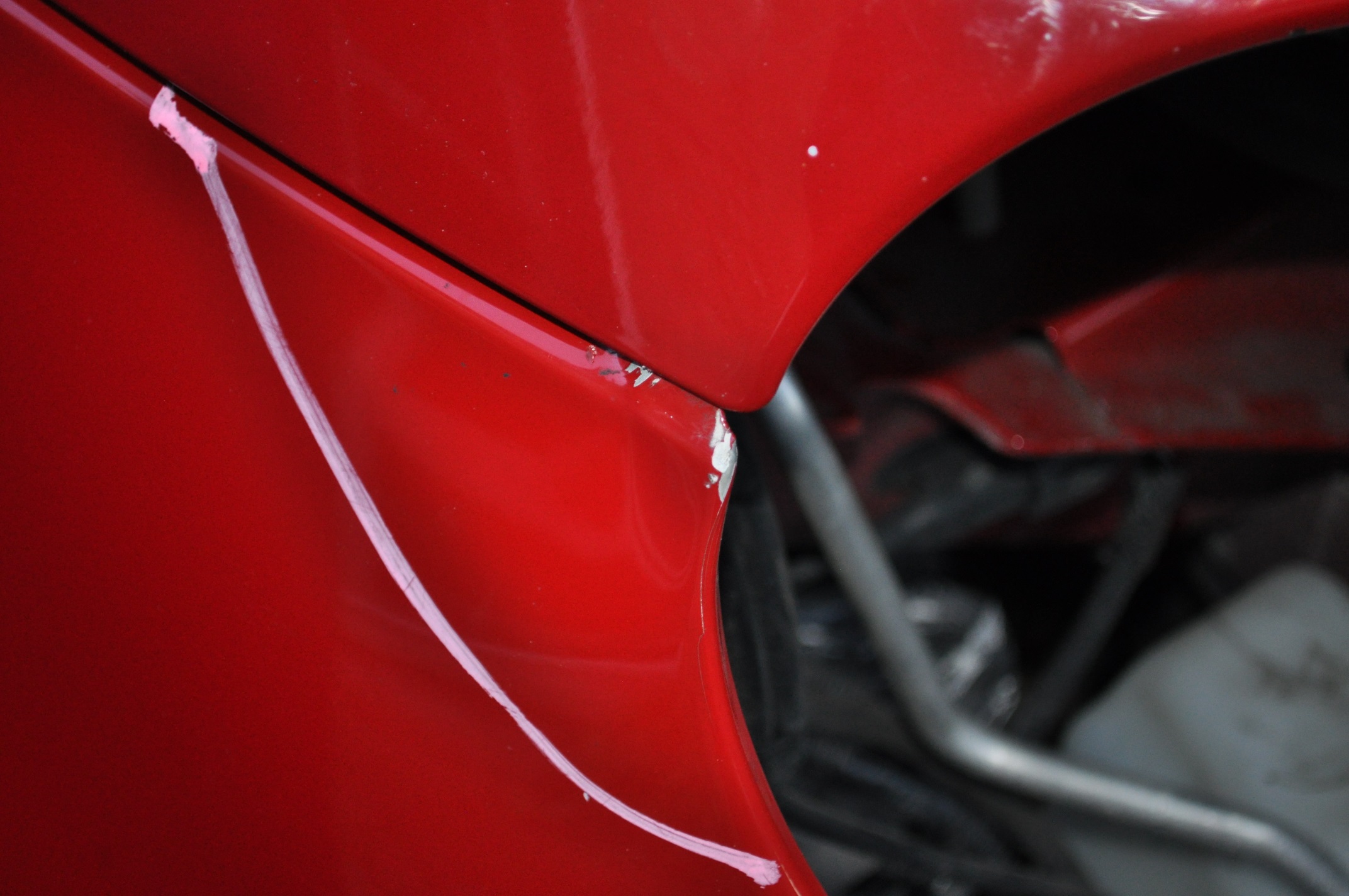

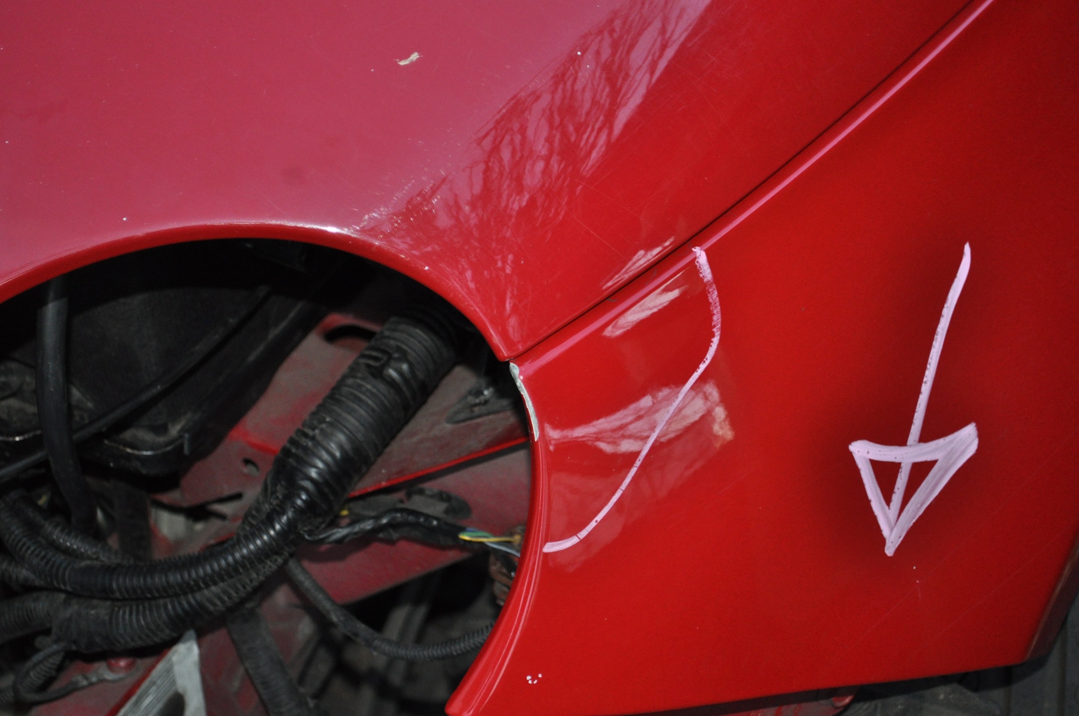

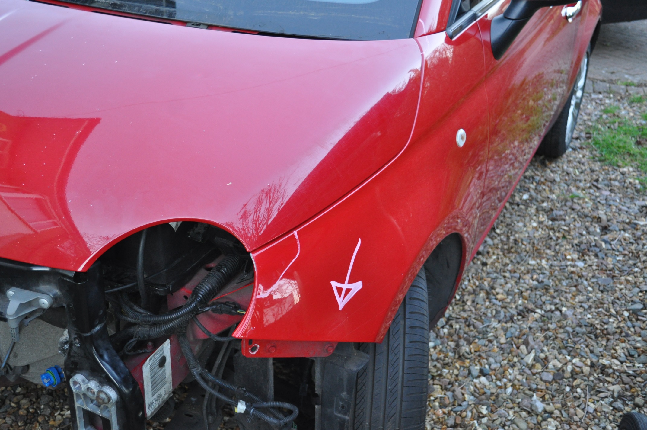

One problem, I did find the clips on the edge of the scuttle cover were both broken. They're white ones which push over an exposed screw thread. Someone went crazy with some black sealing rubber - I found all the clip parts but there's no way superglue is rescuing these.
What are they called, is there a part number? Might be a job for Fiat parts department. Edit: Part number: 71 752 832
The nearside one looks ok. Once you get the wax pen marks off and dab some paint on that edge it will be barely noticeable.
I had very similar with one I’ve got. I heated it up a bit from the inside with a blowtorch and then (wearing gloves), pushed it out from inside. I then got a glue dent removal tool and made it pretty good. Not perfect but certainly doesn’t warrant a new wing.
If you get a block of wood under those tips and hit with a rubber mallet you can flatten them down sufficiently. Again, once you’ve got some paint on them that will make a big difference.
Try fitting the headlights and you will see what sort of gap you have.

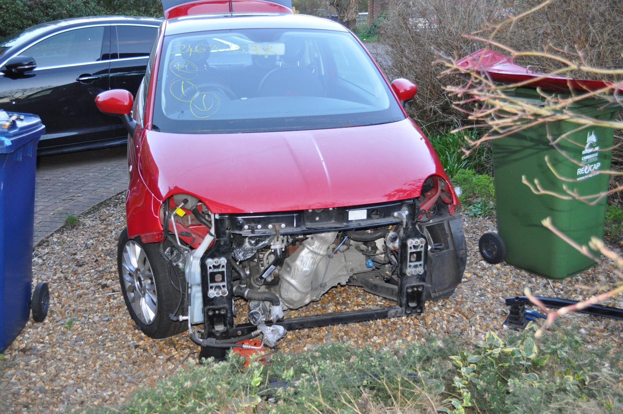

Just hung the lights on (unbroken from scrap yard) as they still have the small hook clip - aside from drivers wing it looks really good, bumper to although it was too far back as I'd pushed it as far in as I could to hang without falling off. Slam panel position is about 5mm too low all round as it was just a rough fit and the combination of that and the drivers wing stops the bonnet completely closing.
Plan:
sort wings out
readjust bonnet hinges, wings & bonnet bolts to line up - tighten down
clean fan & radiator pack, fit intercooler then radiator slam panel, reattach hoses as each is fitted, attach wiring for fan & horn
fill coolant & check for drips.
put jack under slam panel to keep in position
attach crash bars to slam panel, fingertight all bolts.
fingertight bolt fit lights, attach wiring
jack up the slam panel a bit so the bonnet latches correctly & adjust rubber bonnet stops
check bonnet horizontal gap vs slam panel top edge is consistent across bumper width and that lights line up well vs bonnet/wings

I highly recommend the scuttle removal & fingertight hinge bolts thing - they currently look like theyre in crazy positions vs where they were once fitted on another car and where mine were (pen lines), but the end results are great - only test & tighten the bolts when holding the bonnet open from the middle - as soon as you put it on the stay it can pull the hinges out of place again.
Also I've ended up with a single horn and a dual horn. Can't make my mind up which one suits the car more, I'm sure my neighbours are not appreciating the tests. I was going to regas the aircon myself but the local F1 autocentre are charging less than the regas kit costs and no messing around with a canister deposit.
A days work then[emoji3][emoji3][emoji3]
Don’t forget you do have some side to side and up and down movement on the bonnet catch.
I would suggest getting that right, or at least shutting before fitting the bumper as if for some reason you shut it but then can’t open it, you’re in a world of hurt getting it open. Never happened to me but I’m sure it will one day.
