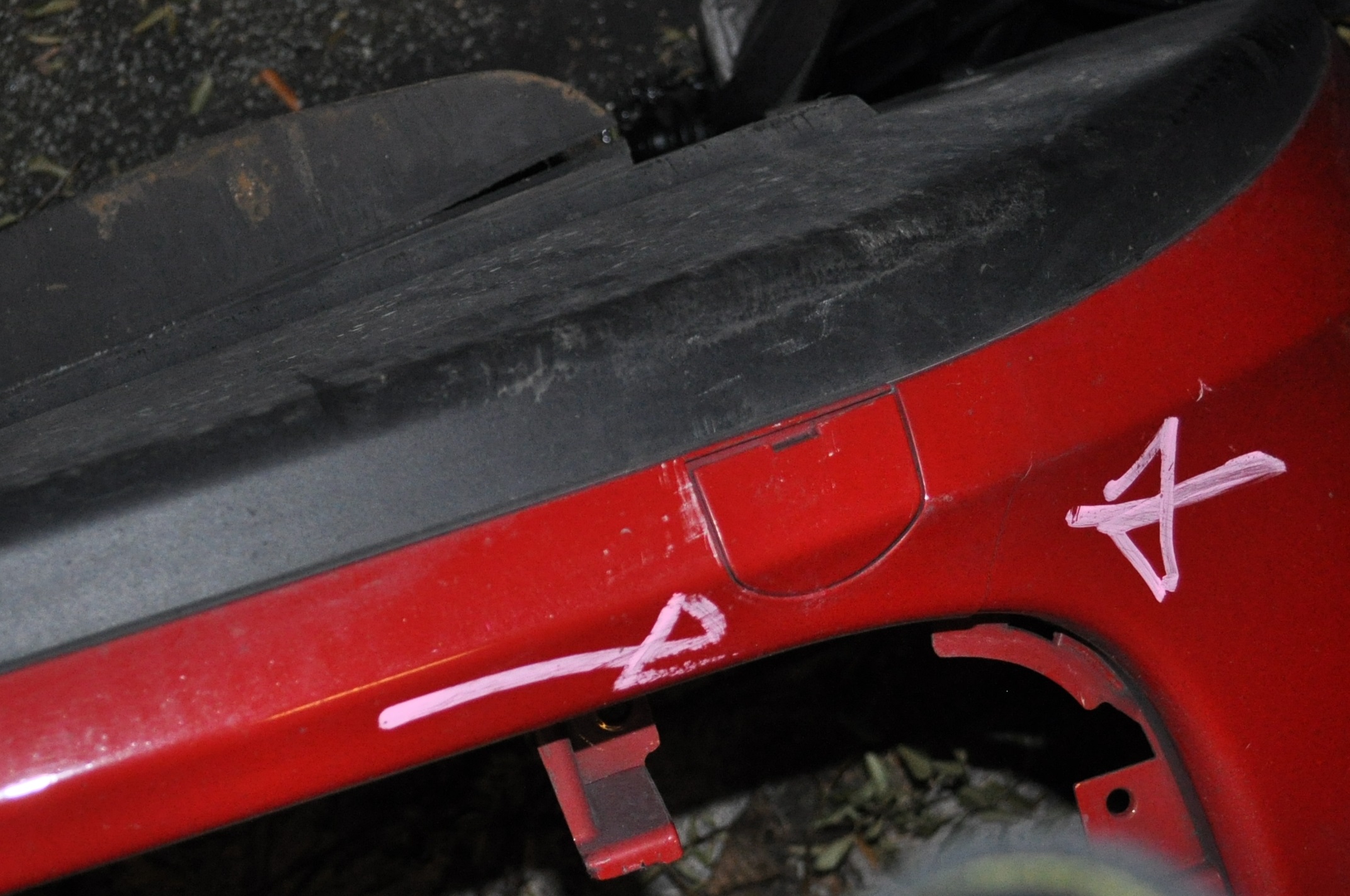

I've been looking at that new bumper but not sure what to do about the lack of the black section at the bottom. I took a close look at mine today and it's actually all the same piece of plastic as far as I can tell. I'll get a photo tomorrow - hoping the weather will hold so I can get that slam panel off and get a better look at the upper rails. The subframe is definitely perfect, the damage to the lower crash bar was absolutely minimal - the tubular section squashed and moved up a bit, but it still sits perfectly flat on the ground.

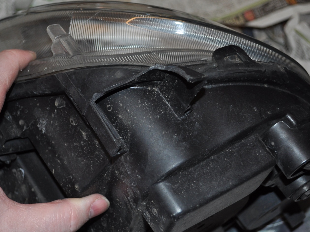

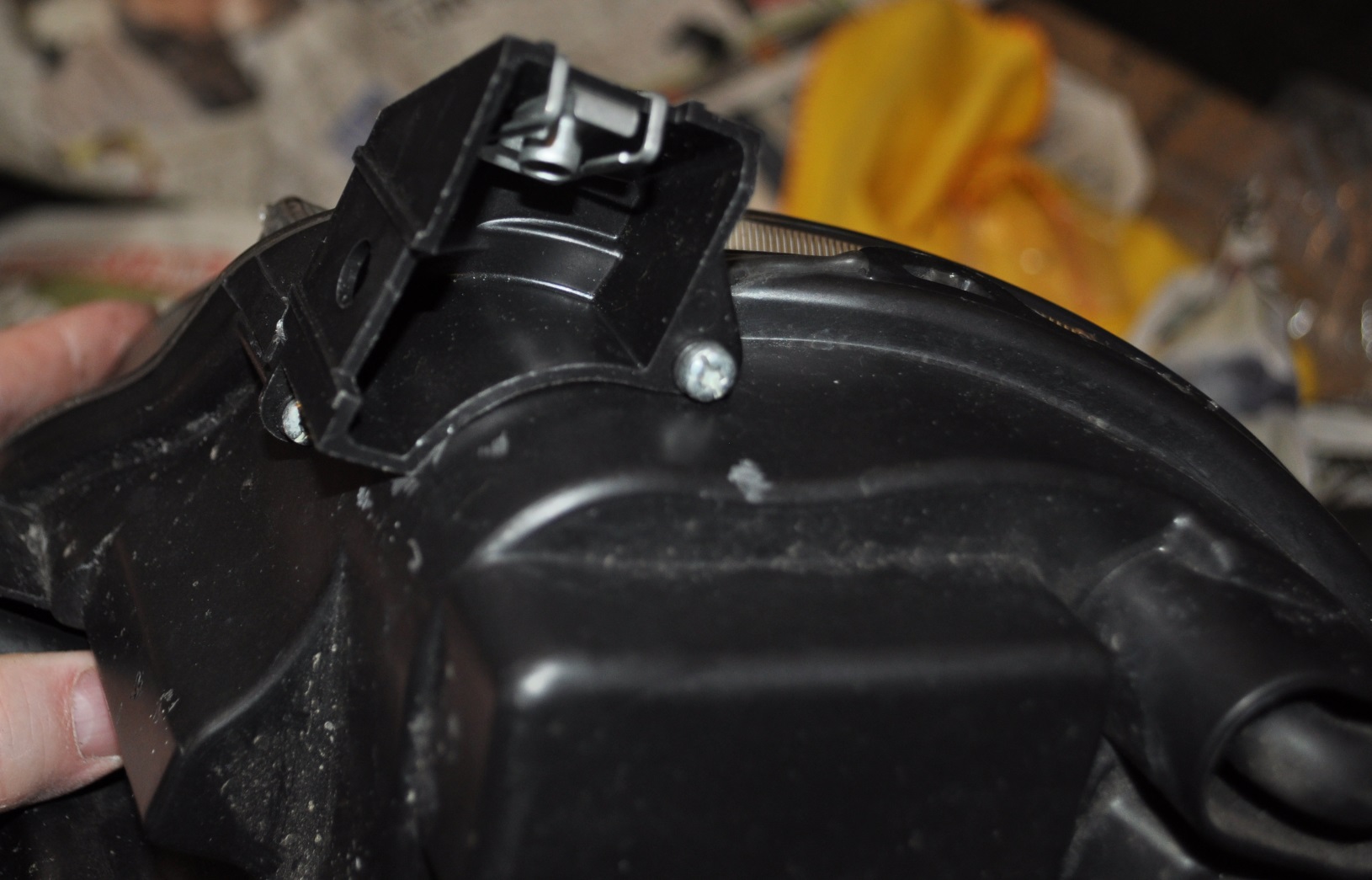

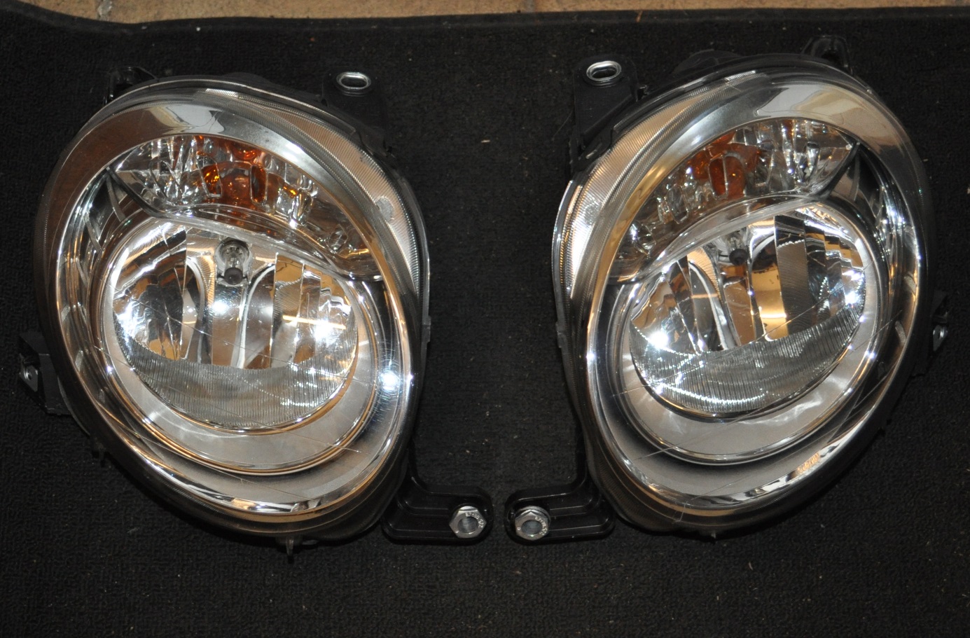

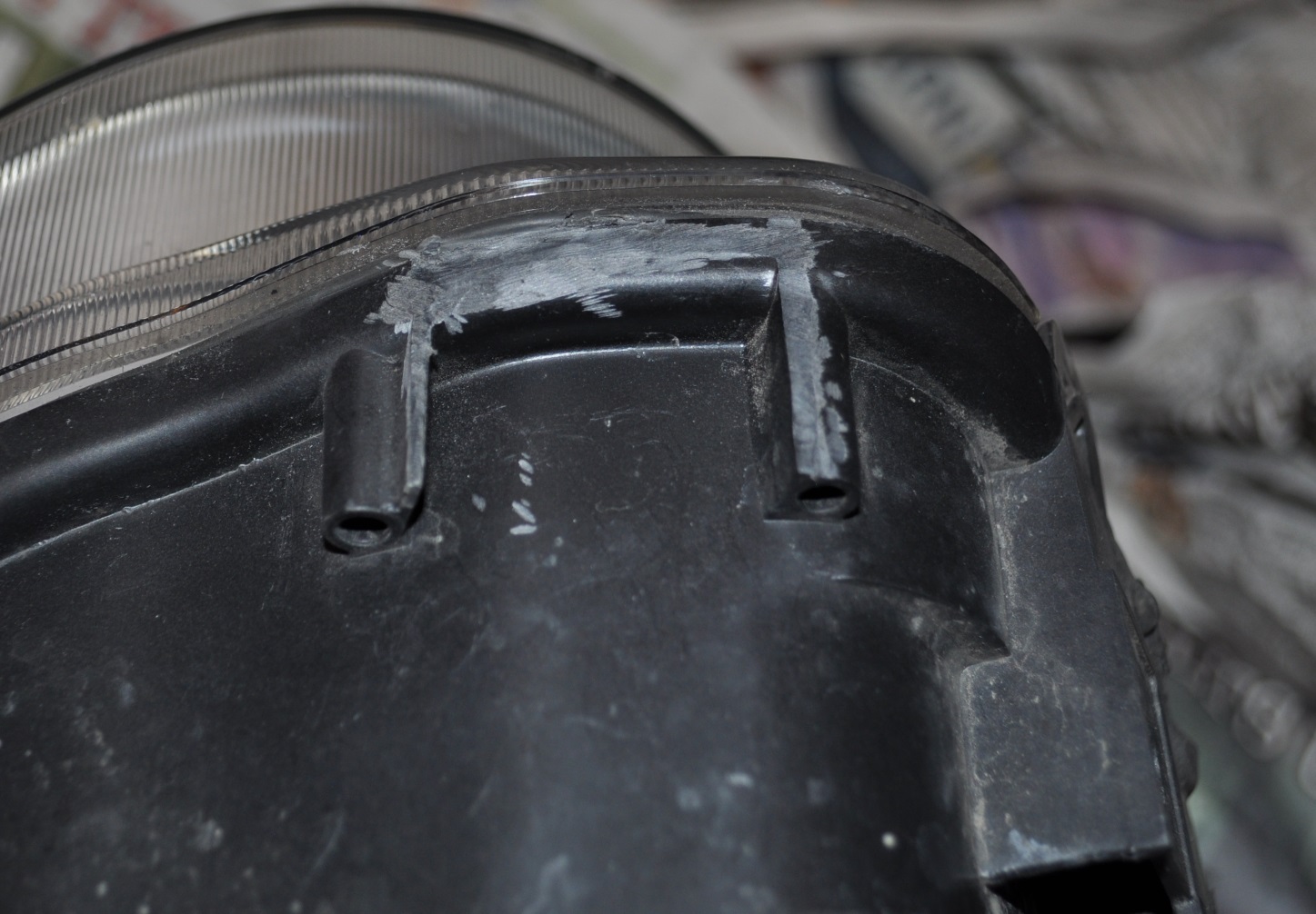

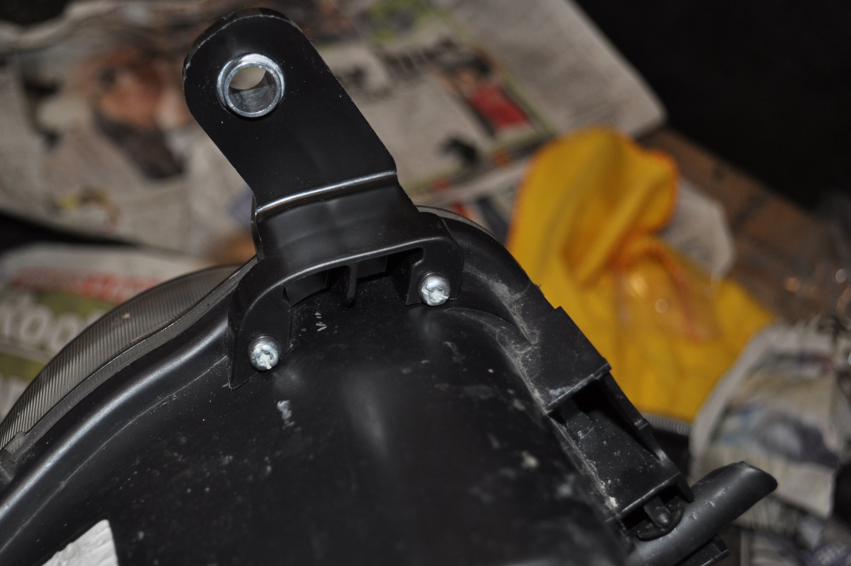

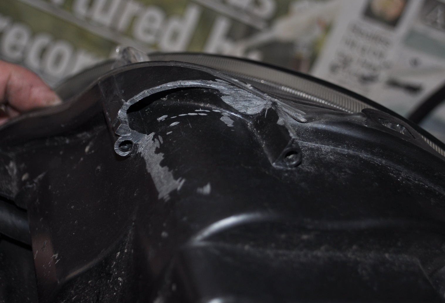

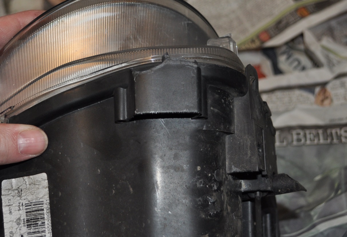

Also had time today to repair the headlamps - I've created a set of pictures for each lug in case anyone is a bit lost like I was at first. When doing the second one I found one of the screw holes hadn't been pre drilled, of course the one you can't get at easily with a drill. I ended up going to a local tool shop and buying a 15mm long 3mm bit so it could be drilled straight. Used a dremel with a standard cutting wheel to remove the excess plastic, not the prettiest but it did the job.
Added a photo of the bumper too - the black and red parts are the same piece of plastic as far as I can tell from the back, confused.

Yeah that's what I was thinking - but the new bumpers on ebay are all seem to be painted a single colour so I might have to hold out for an original one. The texture is slightly different too. I'll ask one of the sellers and see if they can mask that off when doing one.

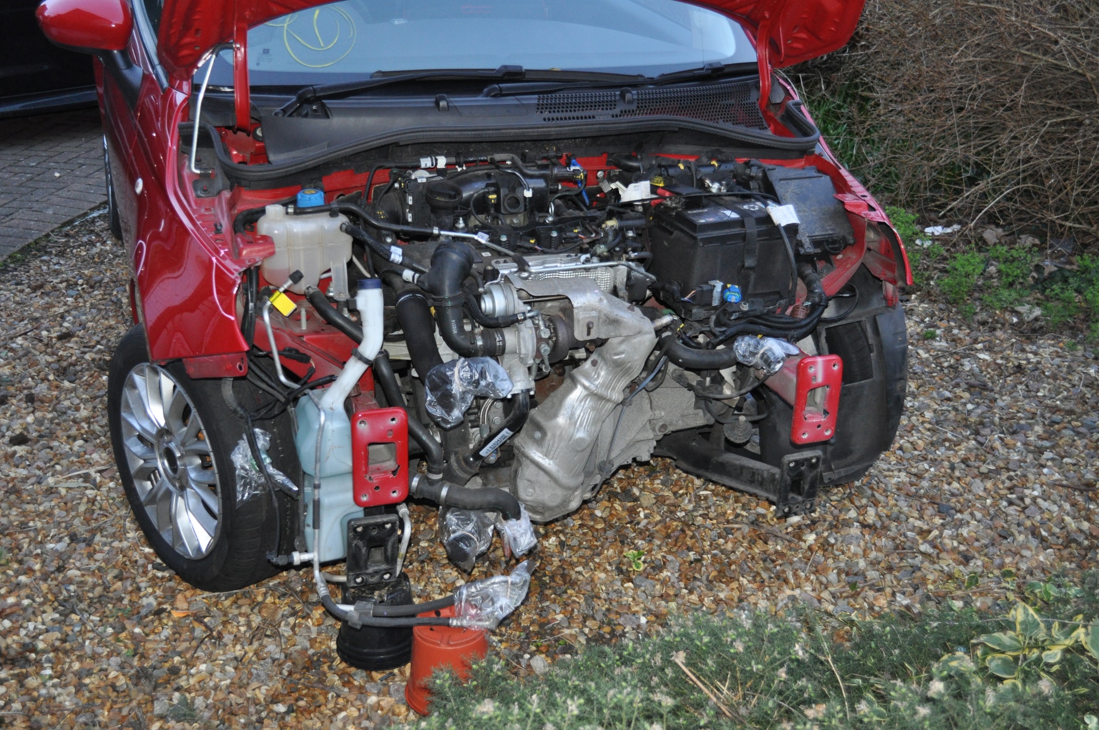

Didn't get too much done today, but:

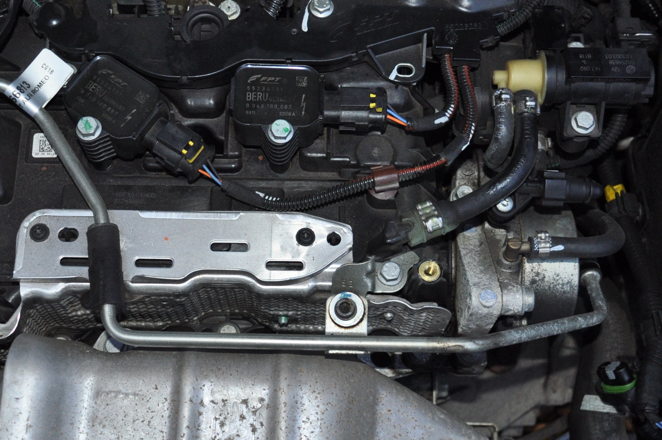

- Fixed the air cleaner mounting nut which had stripped from the hole - now fixed in place with Araldite, that won't be going anywhere.
- Measured all the hoses where clips need replacing to make a shopping list
- Removed the bent slam panel, stripped it of parts, happy to find the brackets bolt on which means I probably don't need to get the new one with the unattached bracket on the intercooler welded - the bolt is probably missing or sheared.
- Straightened up the passenger wing which appeared to have very minor bending to the inner edge.
- Removed the riveted in bumper clips from the wings & painted the hole edges.

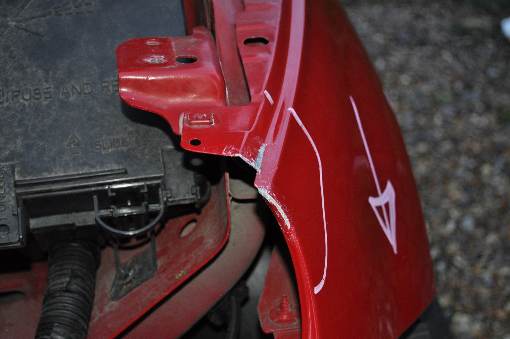

I am starting to wonder if the wings are both bent outwards a bit from the correct curve where the headlamps shunted upwards into them - the bonnet doesn't like up properly at all width ways, but then the bonnet is crumpled and sits back by at least 5mm anyway and not a great guide. If you look at the picture of the straightened one you can see it's been yanked outwards a bit from where it was when painted - see the clip location. I think all I can do here is fix the bonnet hinges, get an unbent bonnet and see where things sit and how much adjustment is available just loosening bolts and 'encouraging' it a little.
Could someone help with a close up photo of the wing with the bonnet open where it sits next to the headlight please so I can check what I've done so far?

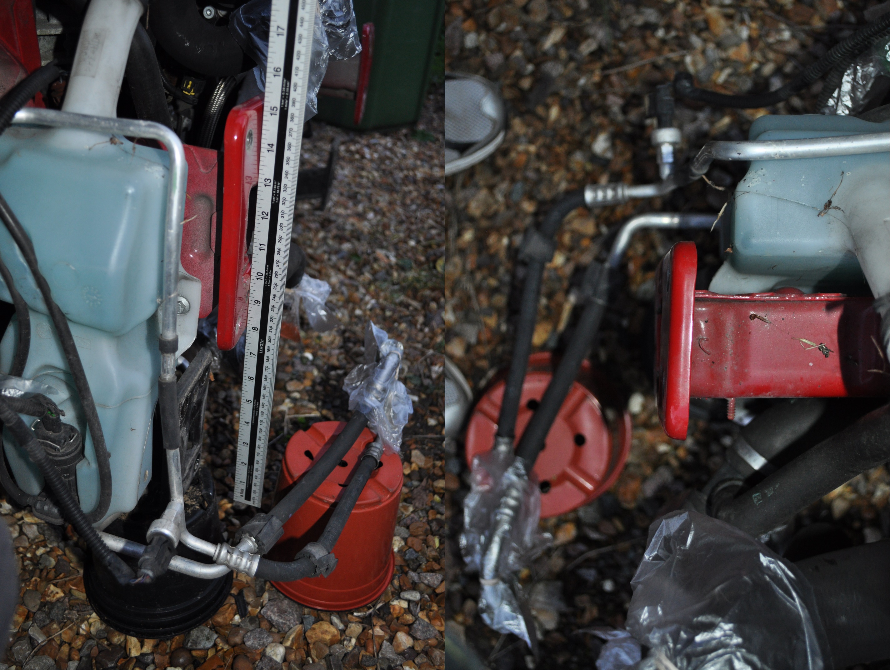

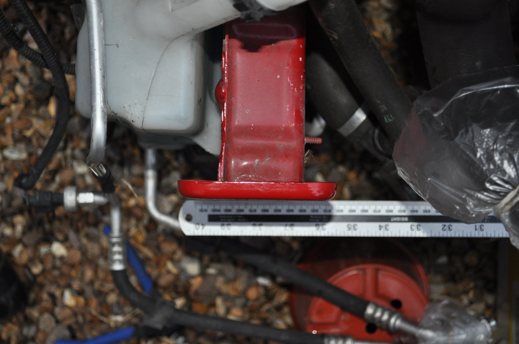

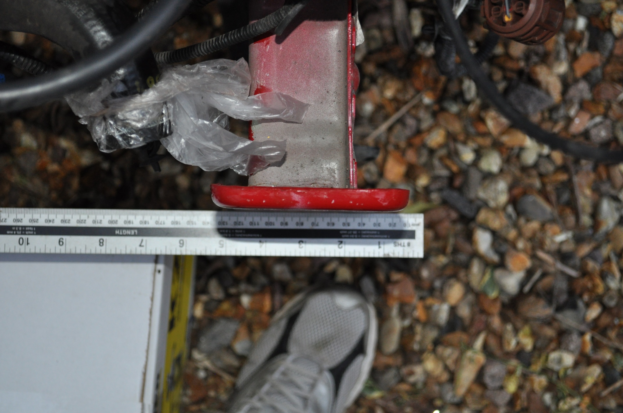

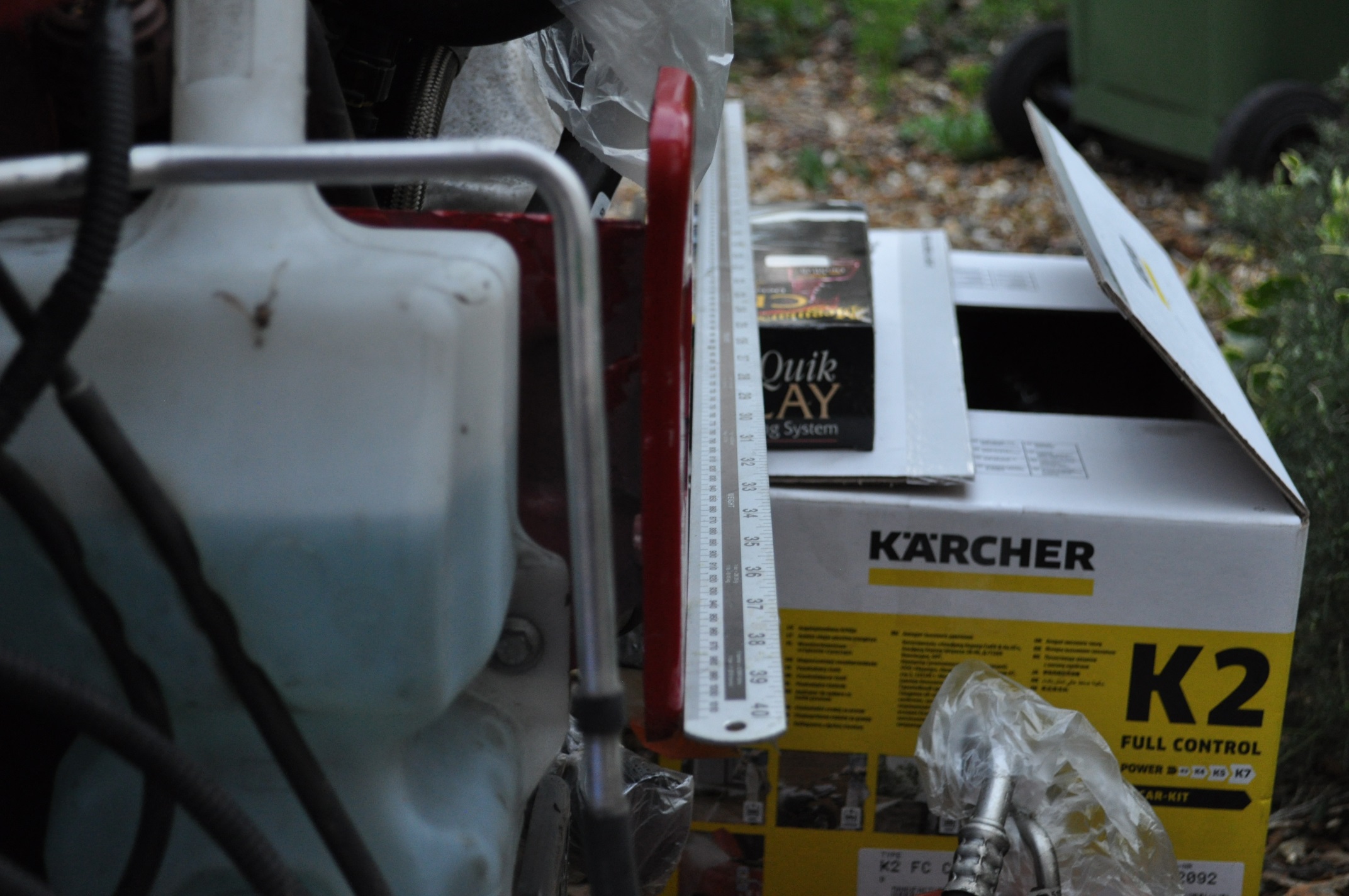

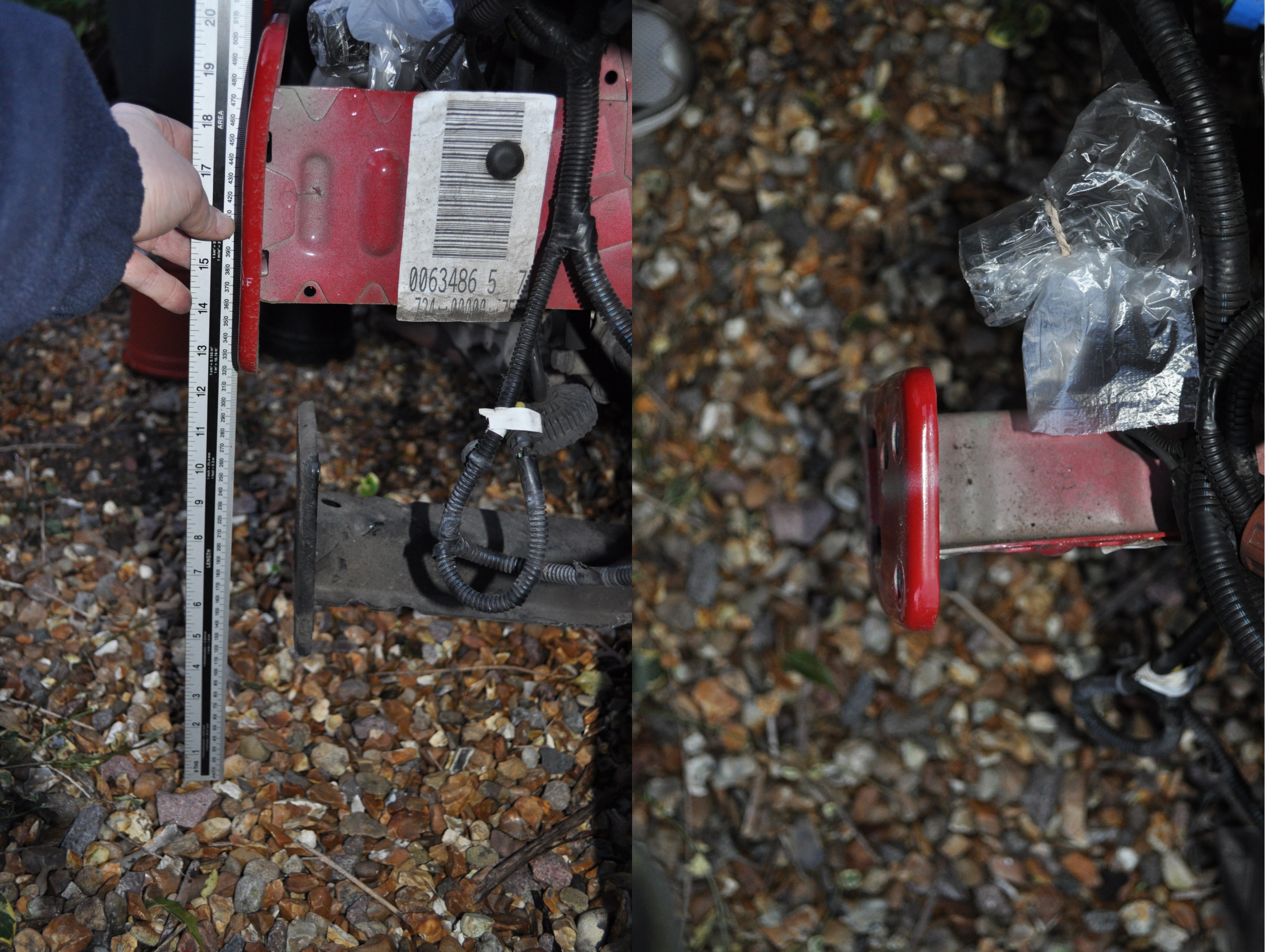

Some good news on the upper rails as hinted at above - I've got a spot on measurement across the outer holes width ways and it's the welded on flanges which are bent rather than the box sections - plan is to remove the battery tray (which needs straightening anyway) and the washer bottle and having a go at them with a big hammer until they're 'close enough'. A very small amount out of place doesn't look like it will make much difference to bumper fitting accuracy as there's loads of room to adjust with the bumper bolts etc. Weld may be damaged on one edge of driver side flange - some paint had cracked away where it bent, need to take a better look at this and potentially get the weld ground back and redone.

Should I replace the hoses all those clamps came off or leave them? The outer rubber surface isn't broken but still bears the marks of the overly tight clamping. Going to shop for clips and an air filter tommorrow, and a BIG can of paraffin or similar as I've read it's good stuff to clean out intercoolers with.

I’ve never, ever got a bonnet perfect. I try and avoid replacing hinges as even if they are slightly bent you need to get the bolts in the exact place on the car. A bit of manipulating of the springy bonnet ends once the bonnet is on will help.
Once you have the bonnet on and closed you can adjust the in and out of the wings by loosening the 10mm nut under the tip where the front panel bolts down and the first bolt half way along. That gives you a few mm each way for adjustment. It’s easier if you do that with the headlights out.
My hinges are bent enough that the bonnet damages the windscreen pillar, when closed it sits about 5mm too high and too far back, worst on driver side. I don't think I have any option other than replacing it, plan was to line up the new ones using the paint as a guide.

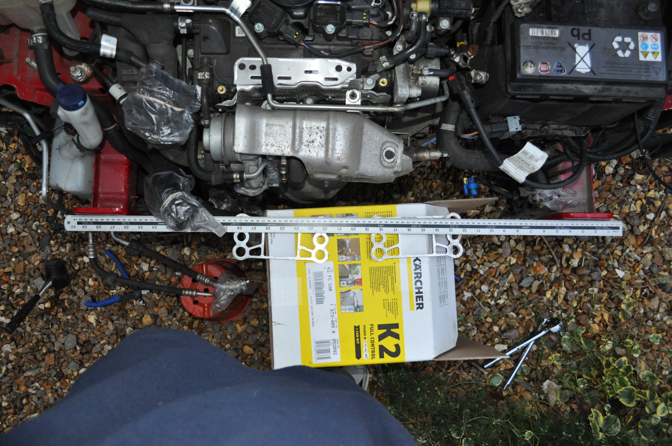

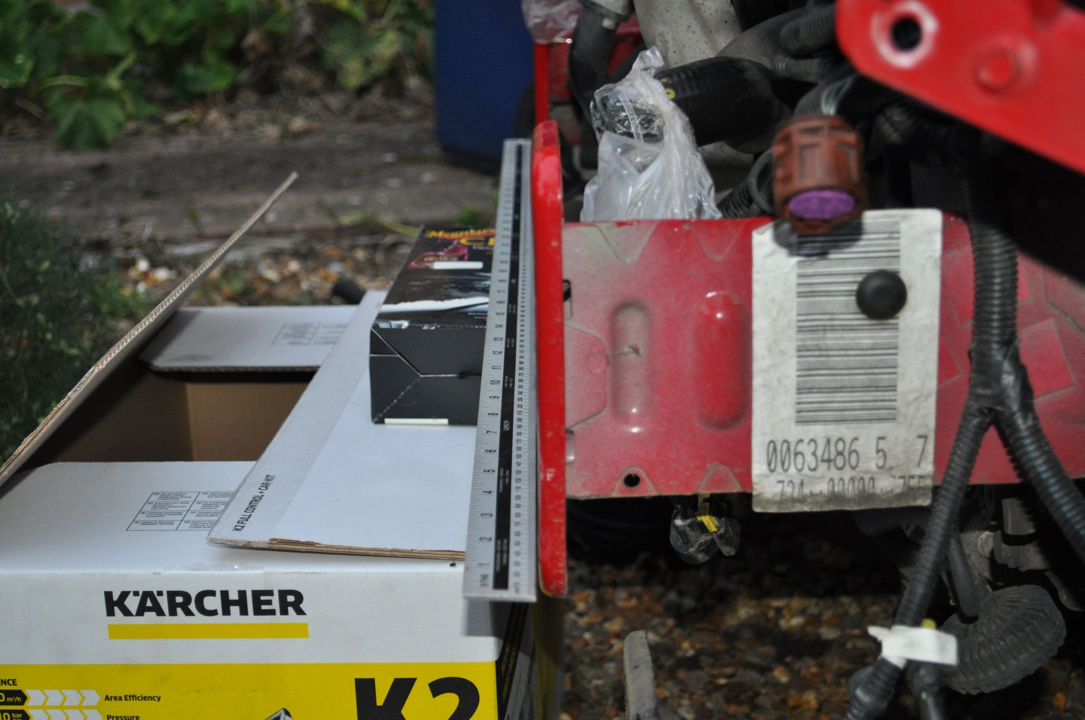

* Removed & straightened out the battery tray.
* Straightened the rail flanges.

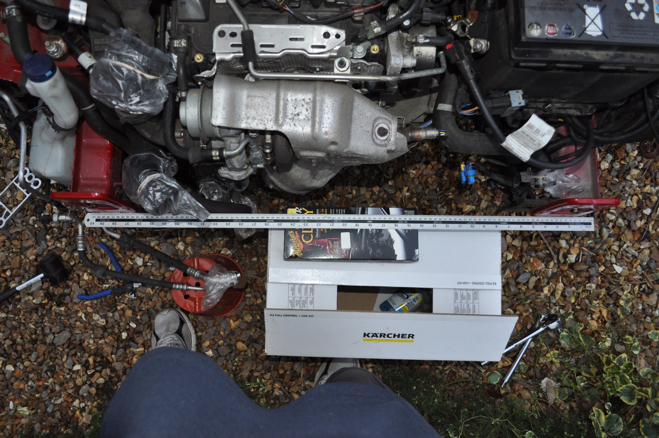

The flanges are not perfect. I tried the hammer method and it took ages to achieve anything and I ended up with a lot of glancing hammer blows leaving marks here and there on the frame paint, and it started to round the edges of the flange. There's a slight convex curve in both of them on the left side which would need some kind of massive clamp bar to force out.
However - I did find a solution! Took the old upper crash bar and used it as a giant bolted on lever - it did bend just as much as the flanges did but it lasted long enough to do the job. I've uploaded photos of the current state, while the curve can't be completely removed I do have straight bolt holes from left to right on the lower and upper hole sets, so I think I'm good to go with attaching the slam panel.
I'm going to strip the panel so I can clean it and the various parts up, it should be interesting to see how well it lines up.

Looks good to me. It’s more getting the holes lined up on both sides so it’s perfectly straight. If it’s not you get an uneven gap when the bonnet is closed. Use a trolley jack in the middle of the front panel and look through the holes in the panel to make sure they are equally lined up.
Do you mean vertically or depth? I'm pretty sure L/R are spot on as I still have the 945mm at the holes. I'll see if I can find the time to strip the new slam panel tomorrow for a quick test fit.

Yes, vertically. Also if it’s too low you won’t be able to close the bonnet.
