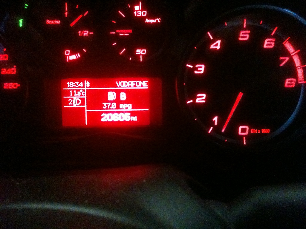

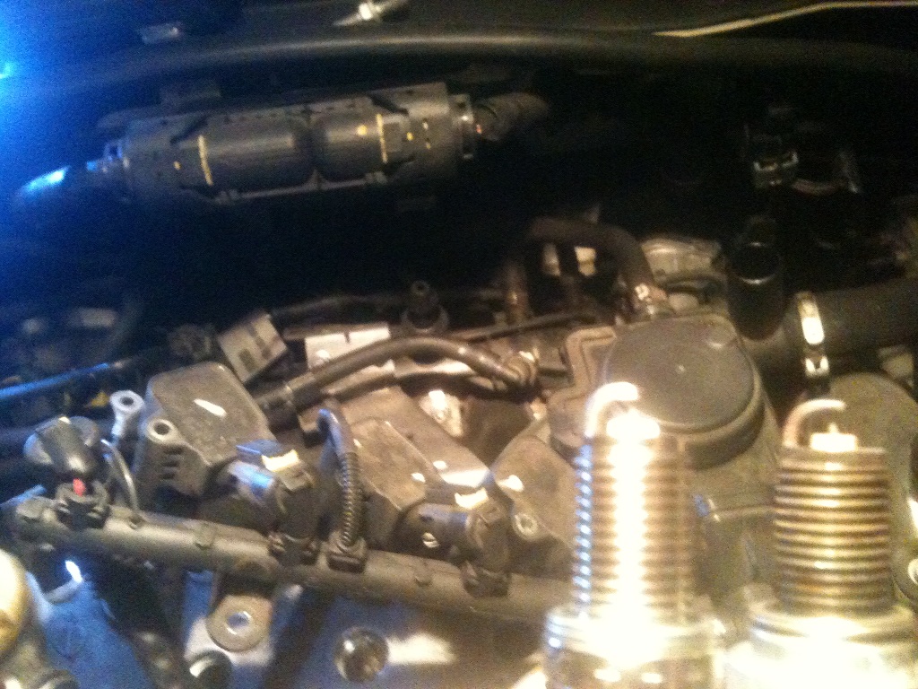

I put in a set of Denso iridium plugs to replace a OEM set (NGK Iridium) in a T-jet engine in a MiTo (same engine in the A500) that were in since new & have done 20K miles. The garage where I bought the car didn't replace the plugs as agreed as part of the service when I picked it up.
I've no hard evidence as such but have noticed that the average mpg readout is now showing an average of 37mpg :) whilst before it was giving around 33.4mpg (the A & the B were the same). I have not changed my driving style but with the turbo it's hard to notice any difference in performance. Note that the tough version (VX) is not available in the T-jet model.
I will know over the coming weeks if the improvement is representative or not.
If anyone was looking to upgrade to the IX22 or VX22 in a 500 1.2 or preferably a 1.4 make sure that you increase the set gap from 0.8 to 1.0 carefully.
