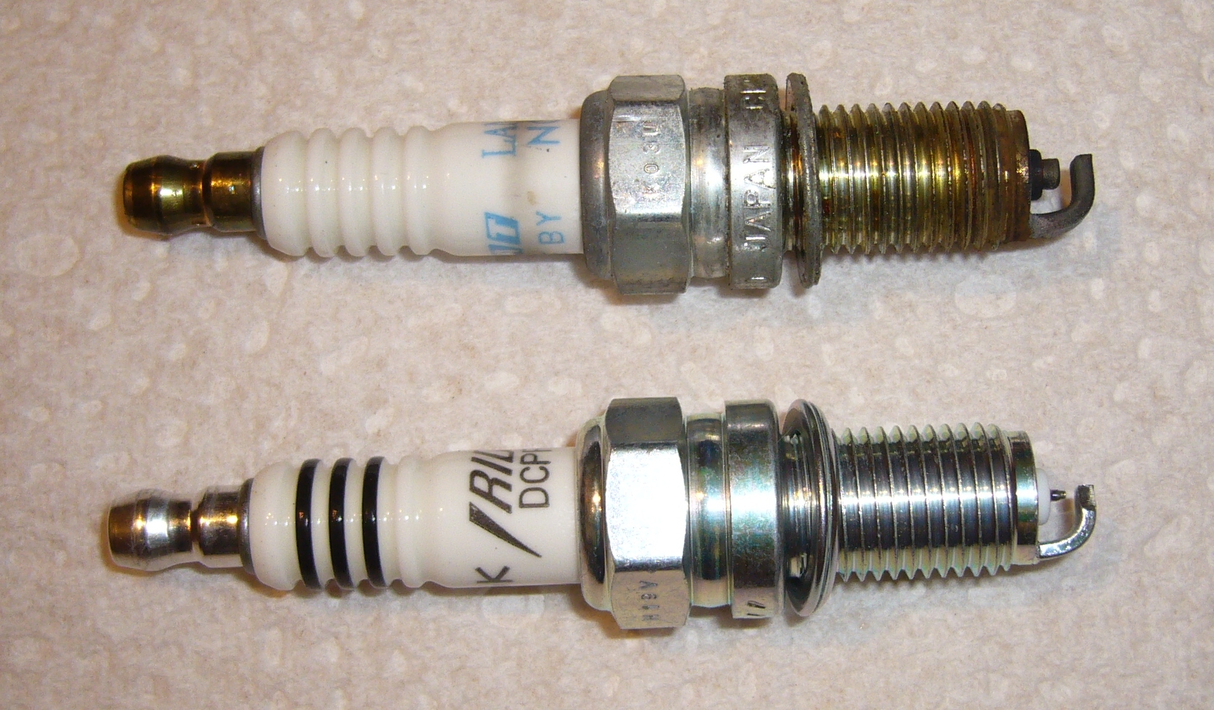

The deed is done & with a bit of selective assembly, I managed to get 3 of the four plugs optimally aligned (y). Initial impressions are favourable & if all goes well over the next few weeks, I'll get another set for the 500. I suspect the advantages of having Ir plugs will outweigh the benefit of the 500 projected tip design & in the Panda they run just fine with the factory set 0.8 gap (which should put less stress on the coil packs).
Picture attached for those who missed it in the Panda section.

The 500 is now noticeably rougher than the Panda when pulling away at low rpm, so I pulled one of the plugs for an inspection this morning, and at 13000 miles they're basically shot. The projected tip design looks like it gets a bit more themal stress (see comparative photo with the standard tip plugs used in the Euro4 1.2 engine).

Ethanol attracts water & this will cause any unprotected ferrous parts in the engine to corrode. If you look closely at the spark plug pics I posted earlier you can see where the rust has formed, and no doubt some of these rust particles will have become dislodged - another justification for more frequent oil changes.
