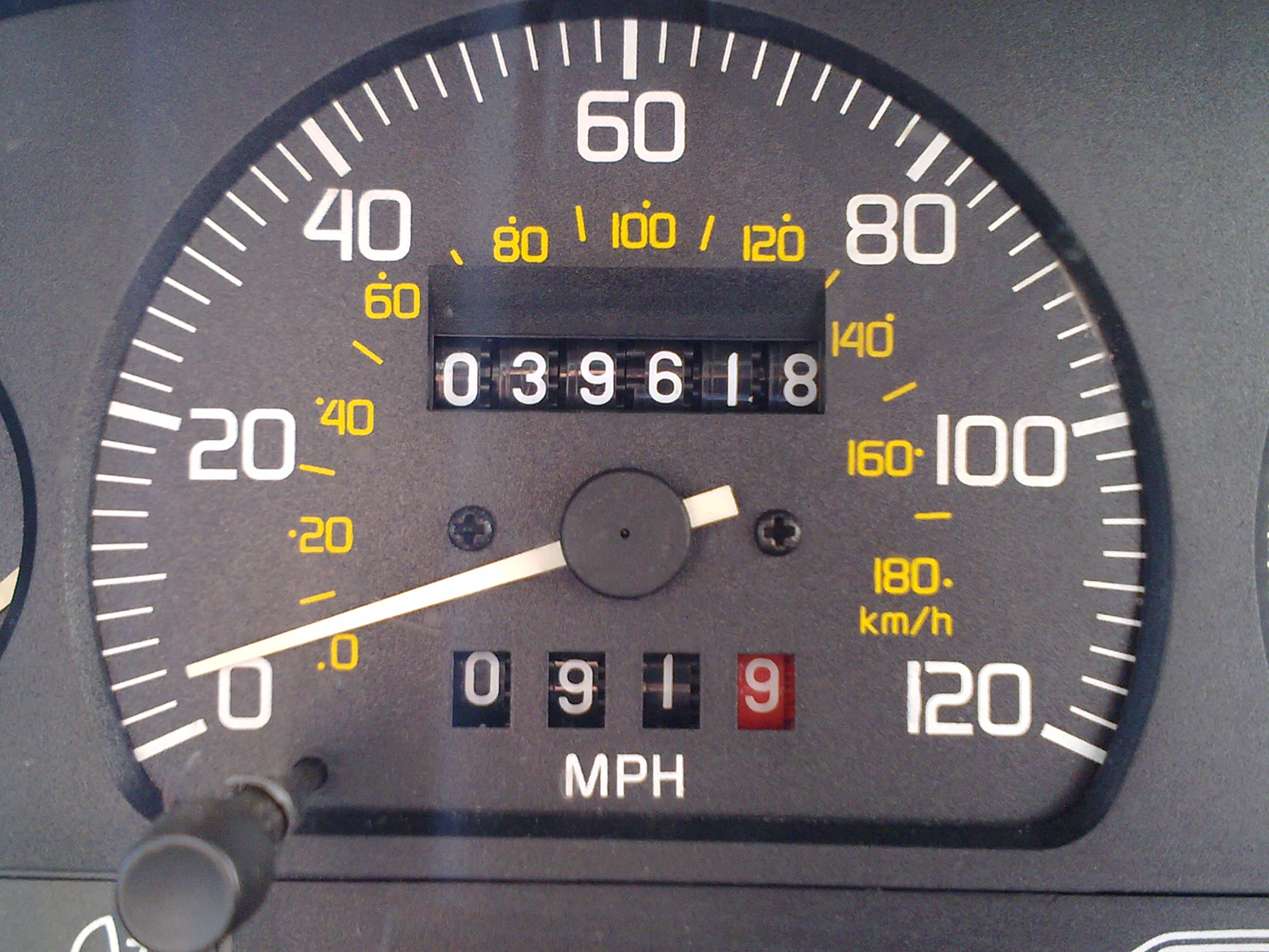

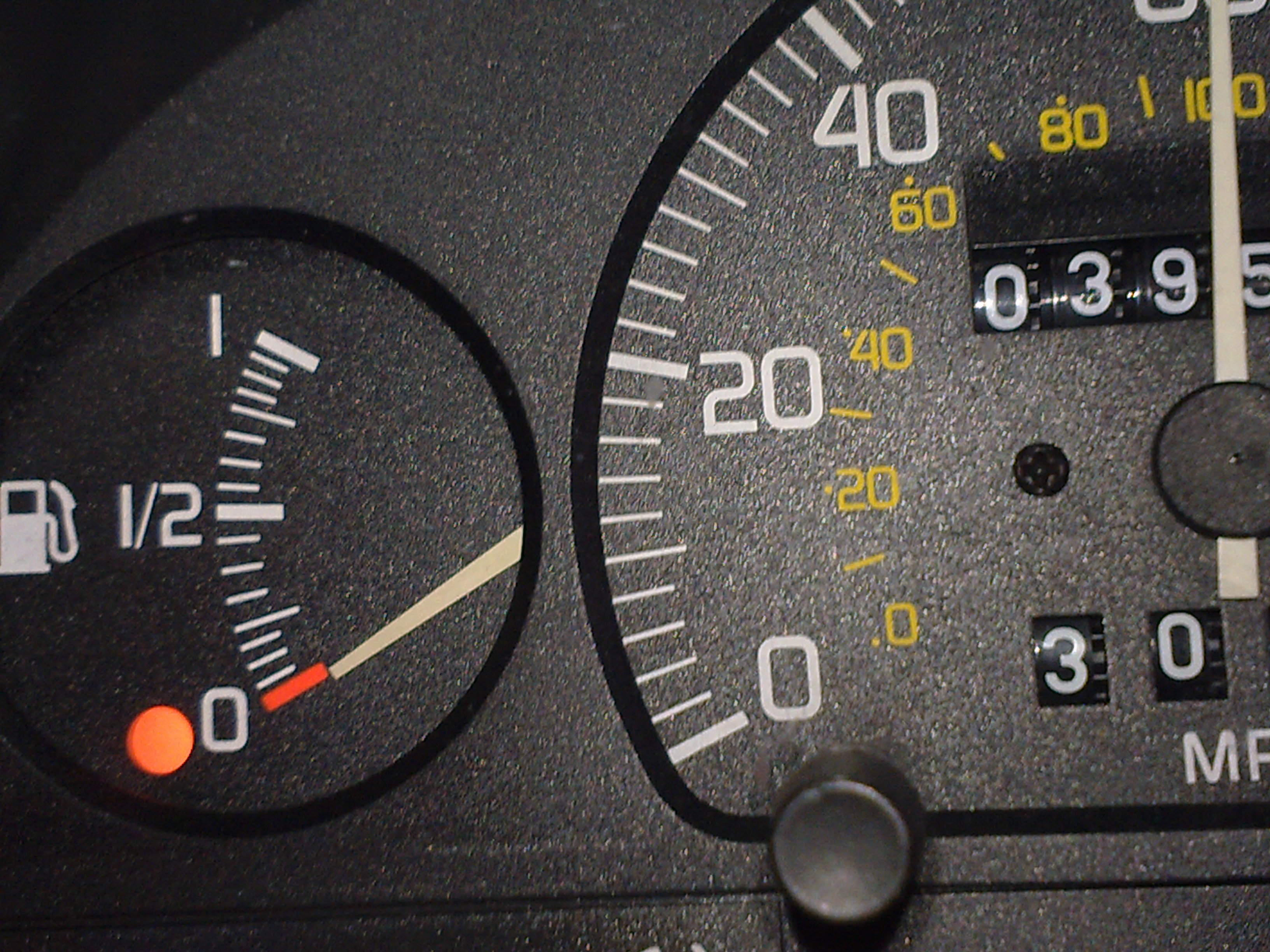

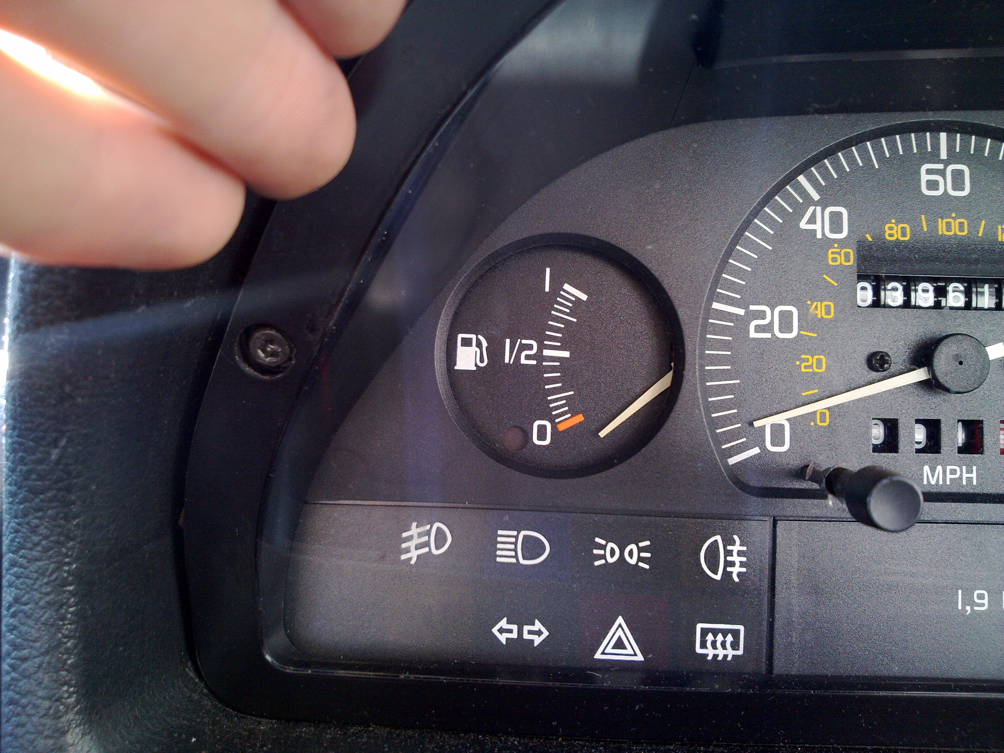

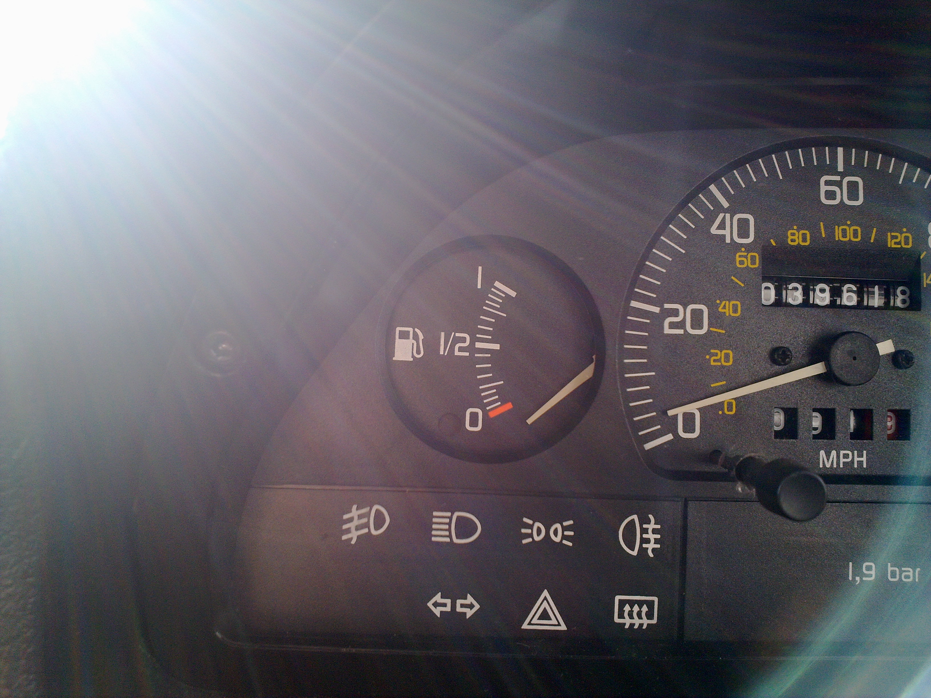

That first picture was added by mistake - it was taken on Sunday after a long return trip. Was bricking it for the last part, thinking I'd run out of fuel on the motorway, but thankfully I made it to the petrol station with fuel to spare.
I found out I can go (over?) 40 miles from when the fuel warning light comes on. :)

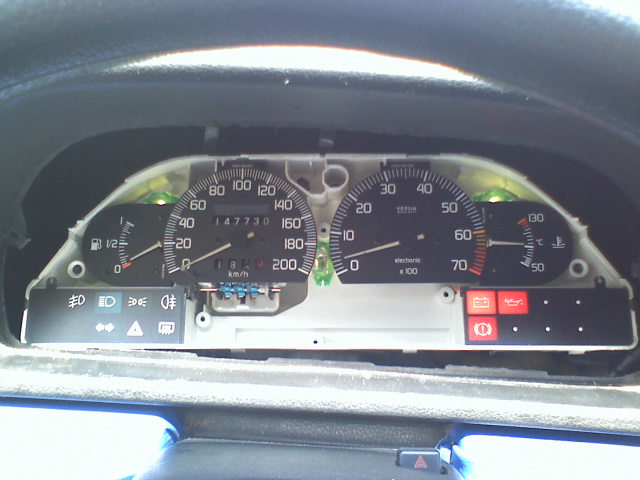

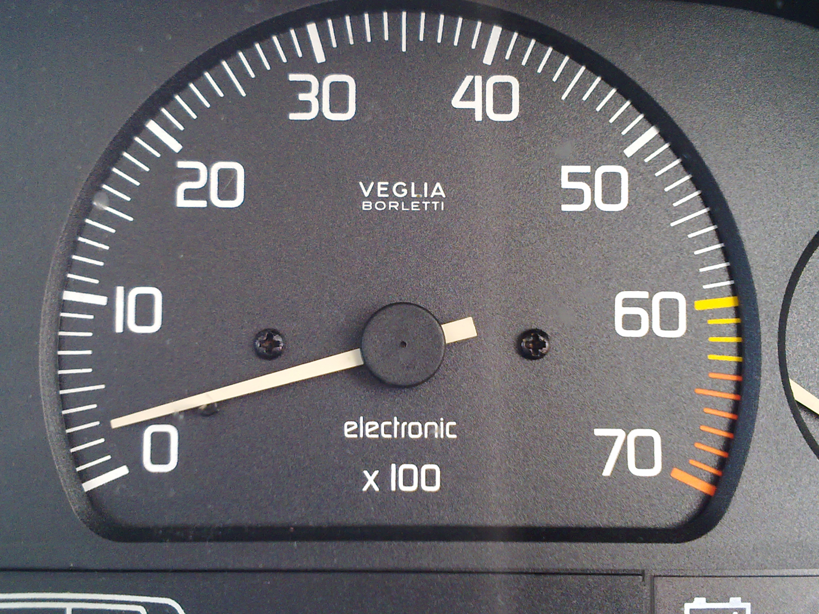

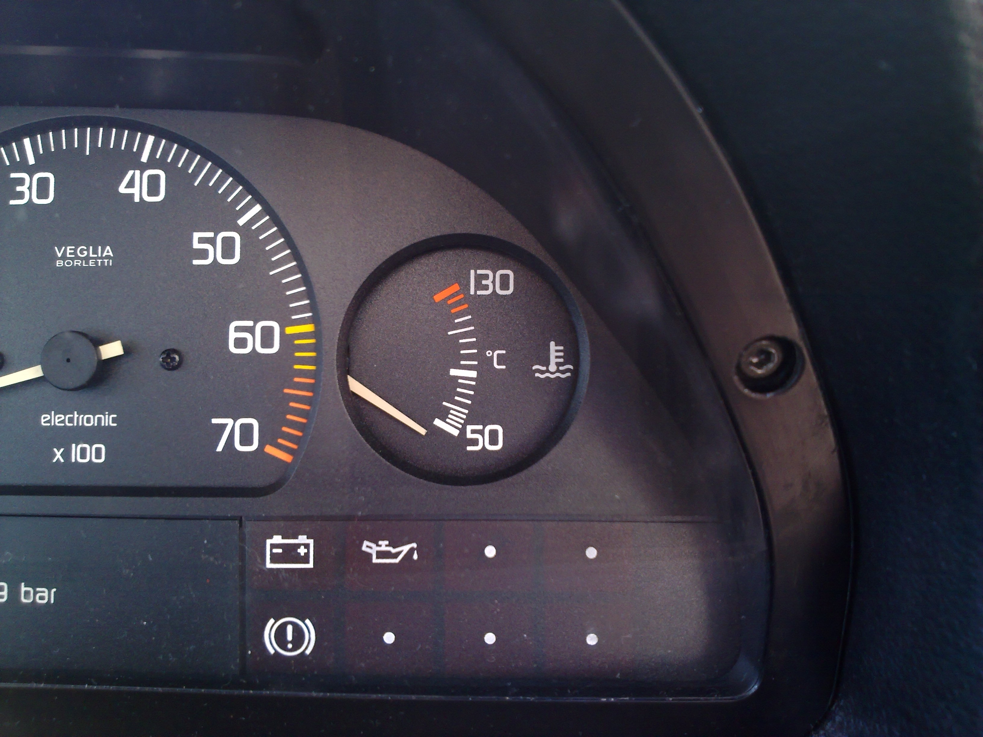

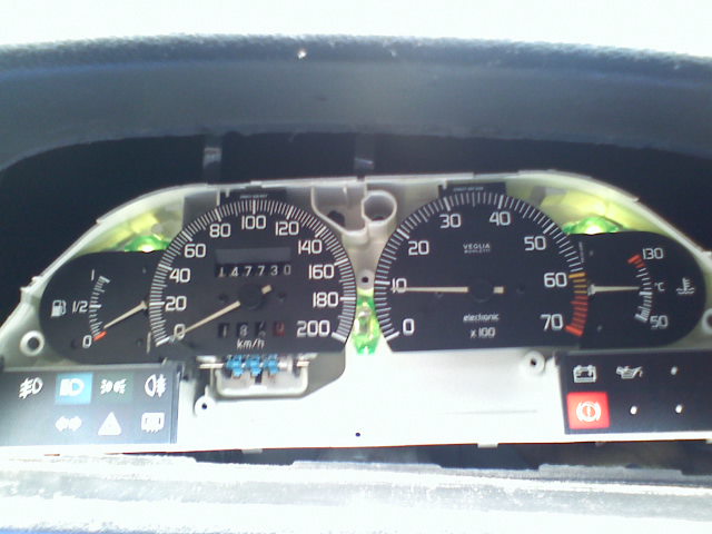

OK, time for some feedback...

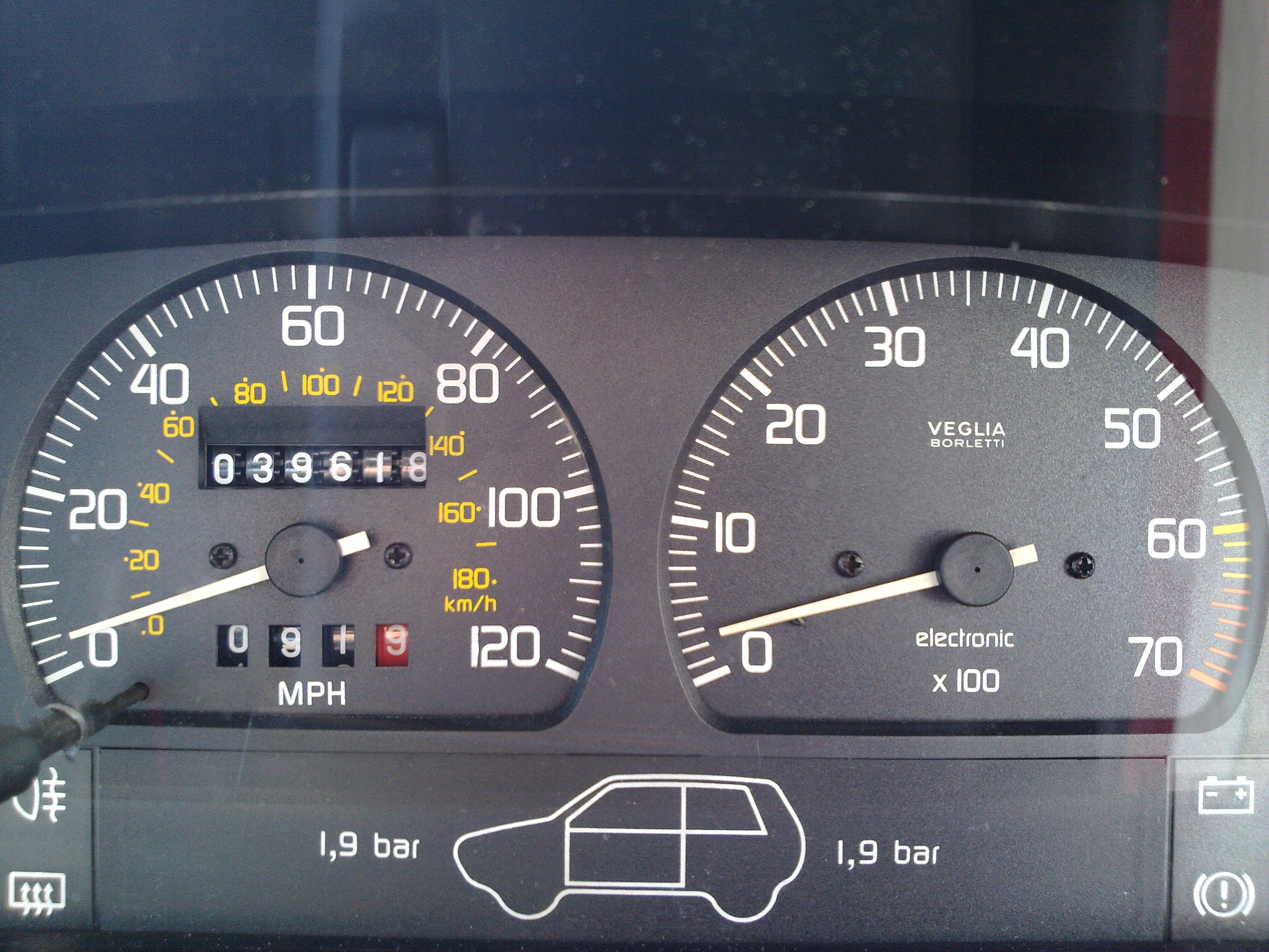

I spent a few hours trying to set up my speedo, cable, and drivegear.
Think I did it all right, but speedo just refuses to work. Everything else, including revsmeter is working superbly. Also, I checked cable&speedometer with a electric drill :D, it works. So, problem is in drivegear... :mad:
It rotates the cable, but so slowly that speedo wont even register it. Ugh.:mad:
Here are some pics (work in progress obviously ;)):
As you can see, engine idles at about 1000 rpm. Is that ok?
Also, you can see that everything but speedo works (n). I am SOOO frustrated! Don't know what to do. I spent 3 hours setting it up, strached my hand badly, blah blah... :mad:

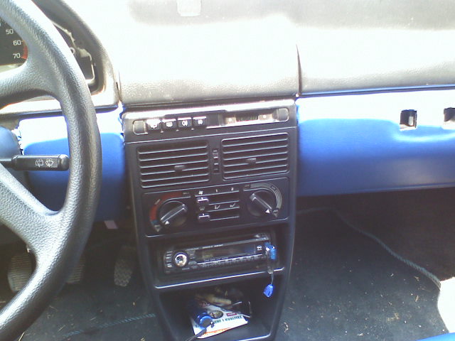

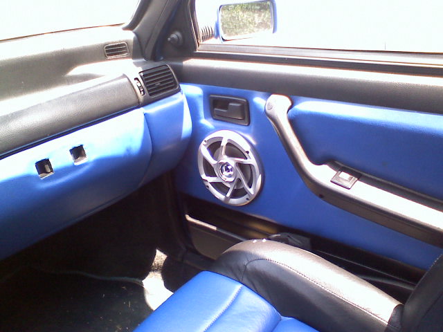

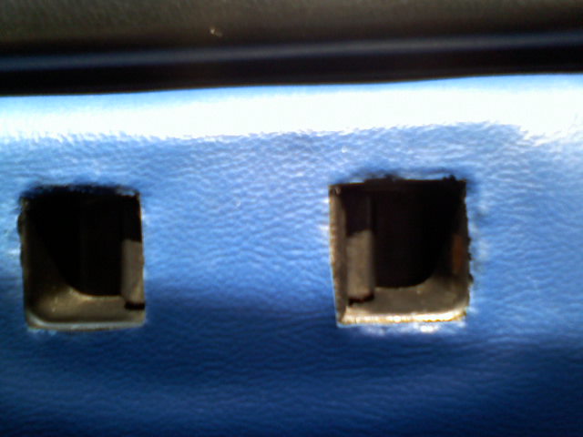

Take a look at this pic. I need ideas, all leather interior is done superbly, but this is the bad spot. How can I make this edges look nicer? All ideas welcome :)

I guess that the old, broken drivegear has chewed the ring on the differential that drives the drive(n)gear? :(
When you rotate the drivegear by hand (with a small screwdriver or similar), does it feel positively engaged with the diff or does it jump teeth easily?
If it jumps teeth, is the metal collar that goes on top of the drivegear properly located (vertical) - I think it has a small hole for the screw that holds it - is the screw in that hole correctly? If not, perhaps the force of doing up the screw has broken the ring that retains the metal collar in the housing :cry:
Either that or a chewed gear would mean a differential-off job to fix. Might be possible with the gearbox in place, if there is enough room to remove the housing. Don't give up ;)
As for the blue leather picture, I have no idea where that is, so can't suggest what might be supposed to fit in those square holes :eek: Can you give us a bit more context, feels like one of those games where you see a tiny part of the photo and have to identify what the photo is of! :D

Hopefully, it hasn't chewed the inner gear that spins drivegear itself. That would be disaster :mad:. Furthermore, all inside gearbox is made out of metal, while drivegear is made out of plastic, so I hope gearbox is intact.
I will come out now, and see if it moves, following your instructions. Will post info later today....
As for the blue leather, we're moving on to new game...
Here are two pics, find the piece on them! :D
J/K of course, the part in question is opener of the cassette/glove box...
Now you can see it...
Went down, tried moving drivegear.
Totally stuck :(. Can't rotate it, cant pull it out again, nothing :(.
I believe I screwed it too tight (while missing the hole for screw), and bent something....
I am one really sad panda now. I have no clue how am I going to pull it out.
