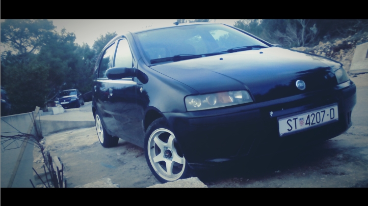

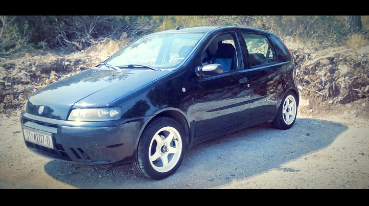

1.5 Bended/negative camber on right wheel
While it had stock wheel's it was unnoticeable at all, until i switched to new alloy's.
It's like 5% of negative camber not really noticeable on close, but when you look from far away or full-lock its pretty much noticeable!
( i don't know history of this car, might had accident maybe not who knows )
It's also scraping on full-lock
- If you go above 60km/h and slam hard on brakes, car slides to the right! could it be because of this too?
Where to look up on this one, ideas?
