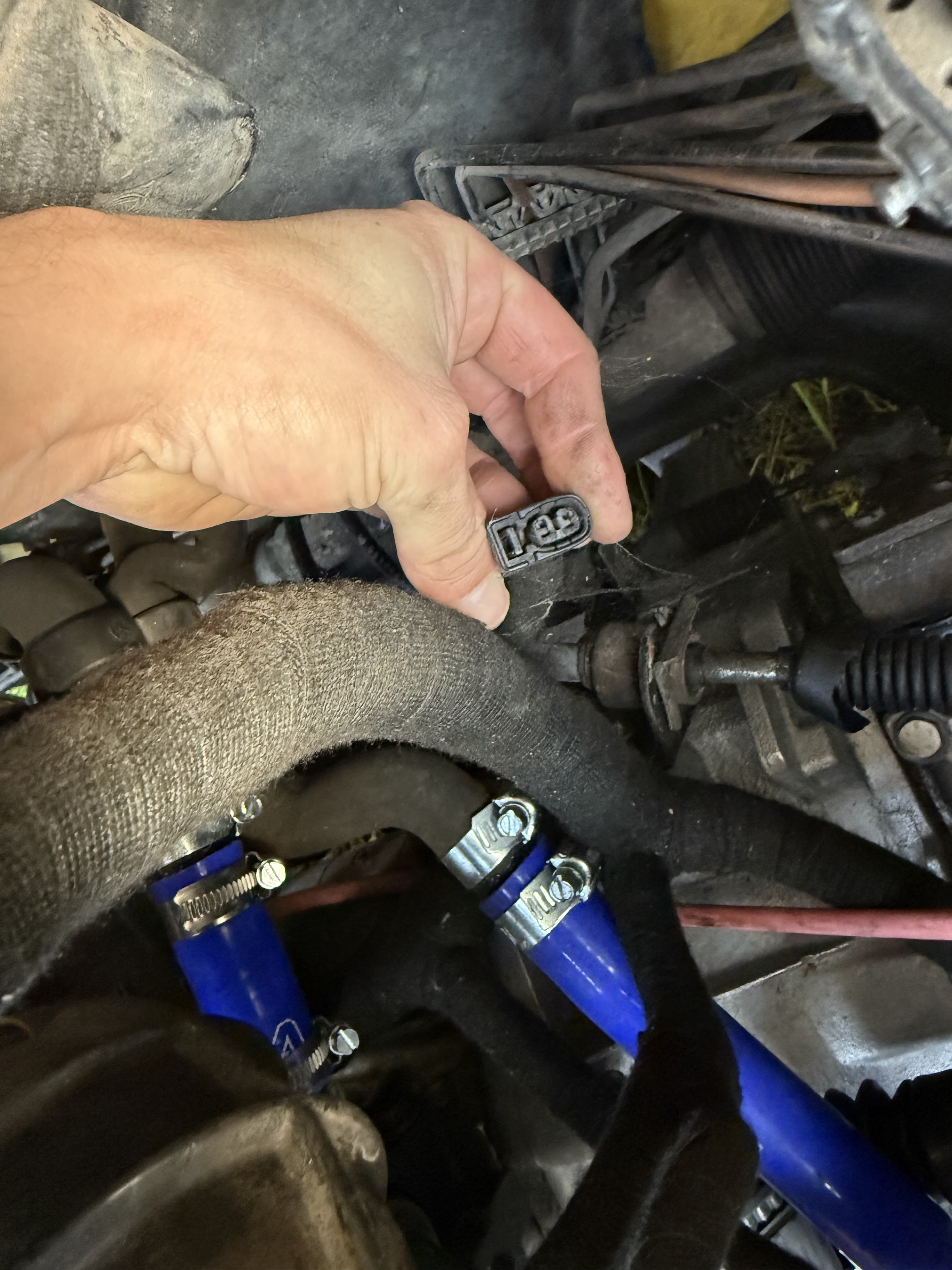

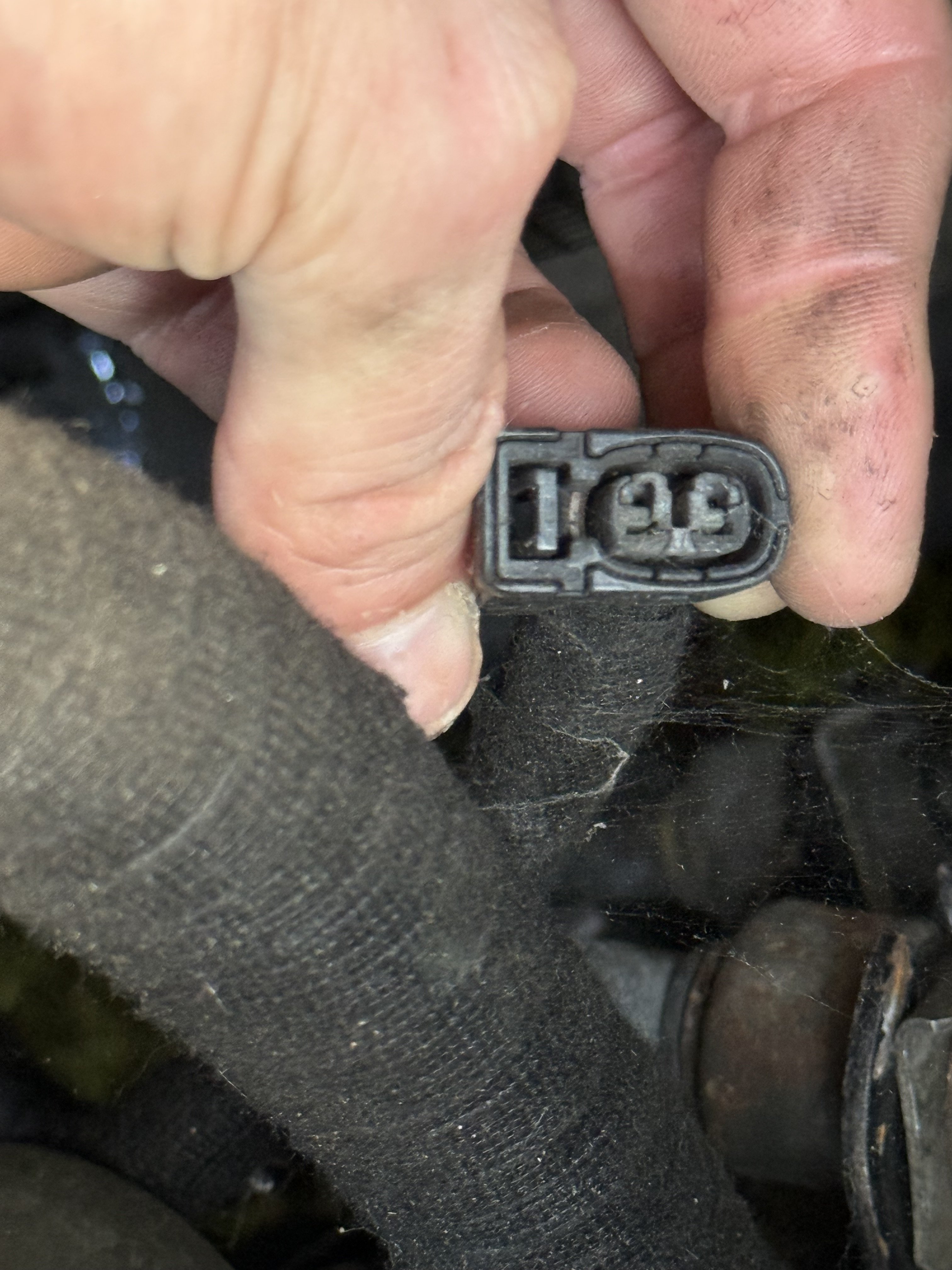

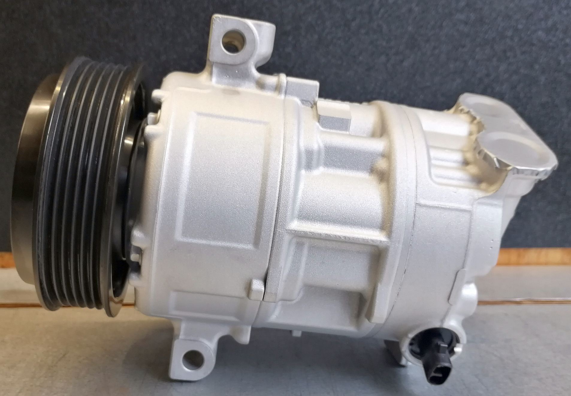

I swapped the original engine due to bad head gasket, it’s a 1.2 16v out of a mk2b. It’s the same wiring loom that was on the engine I just can’t seam to find out where this connector goes, it comes out the main loom from the back of the engine, it hangs around the gearbox area I thought it went onto the gearbox but there nothing there for it any thoughts?

I have a red and yellow connector by the starter end of the gearbox that is unused on my 16V 1.2 A few people have wondered about it. It might be for the speedo sensor for cars that do not have ABS.
But that connector is totally different to my one. I will be under the car in the next few days for my alternator so I will check the knock sensor plug

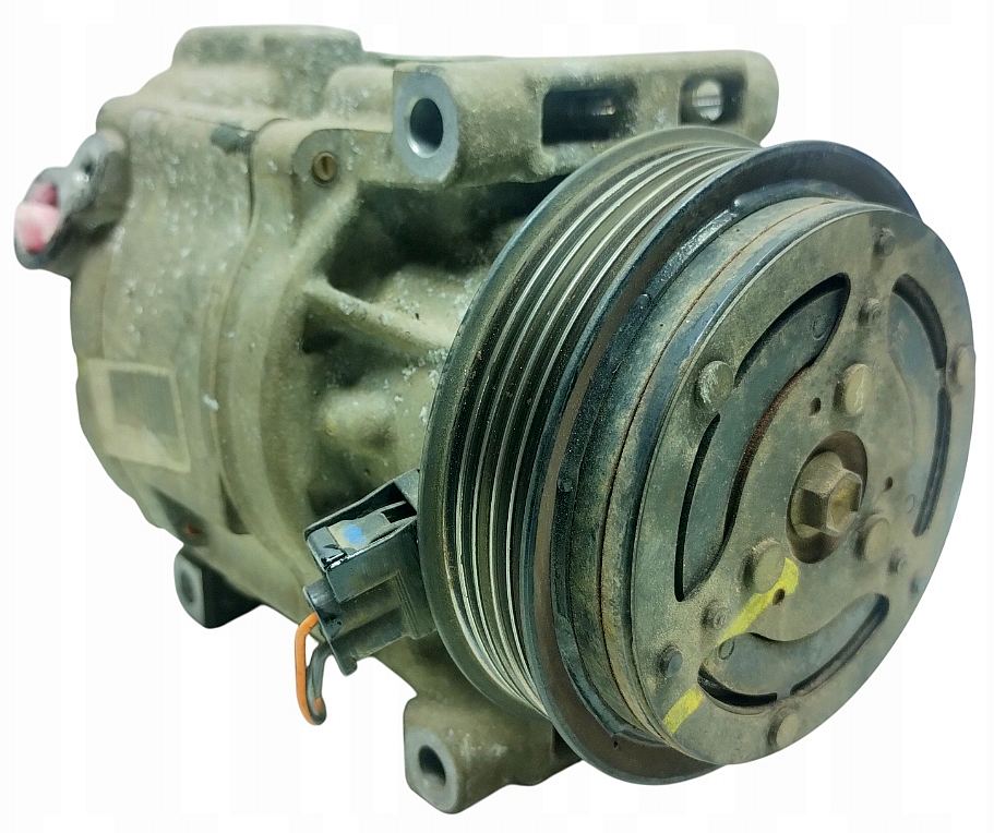

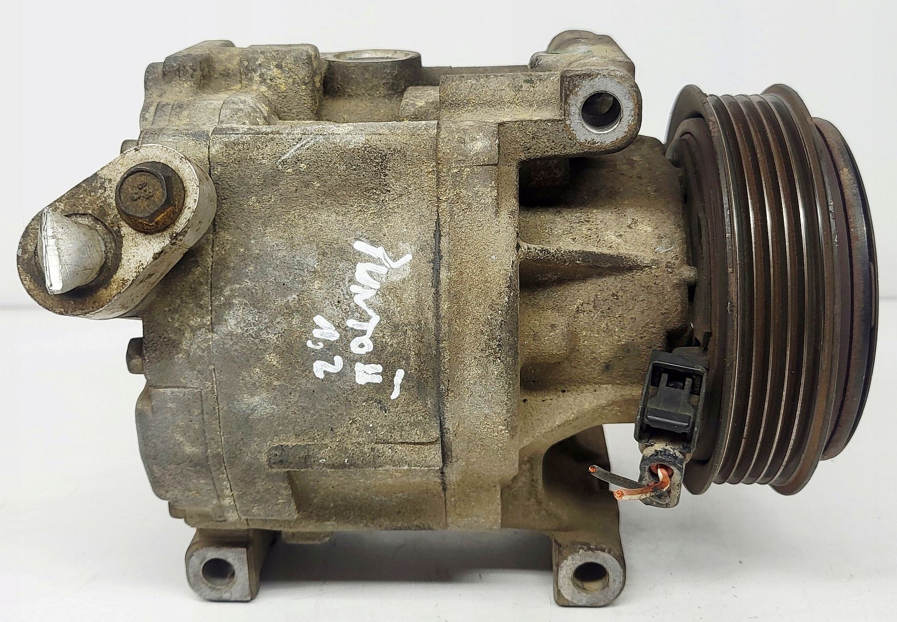

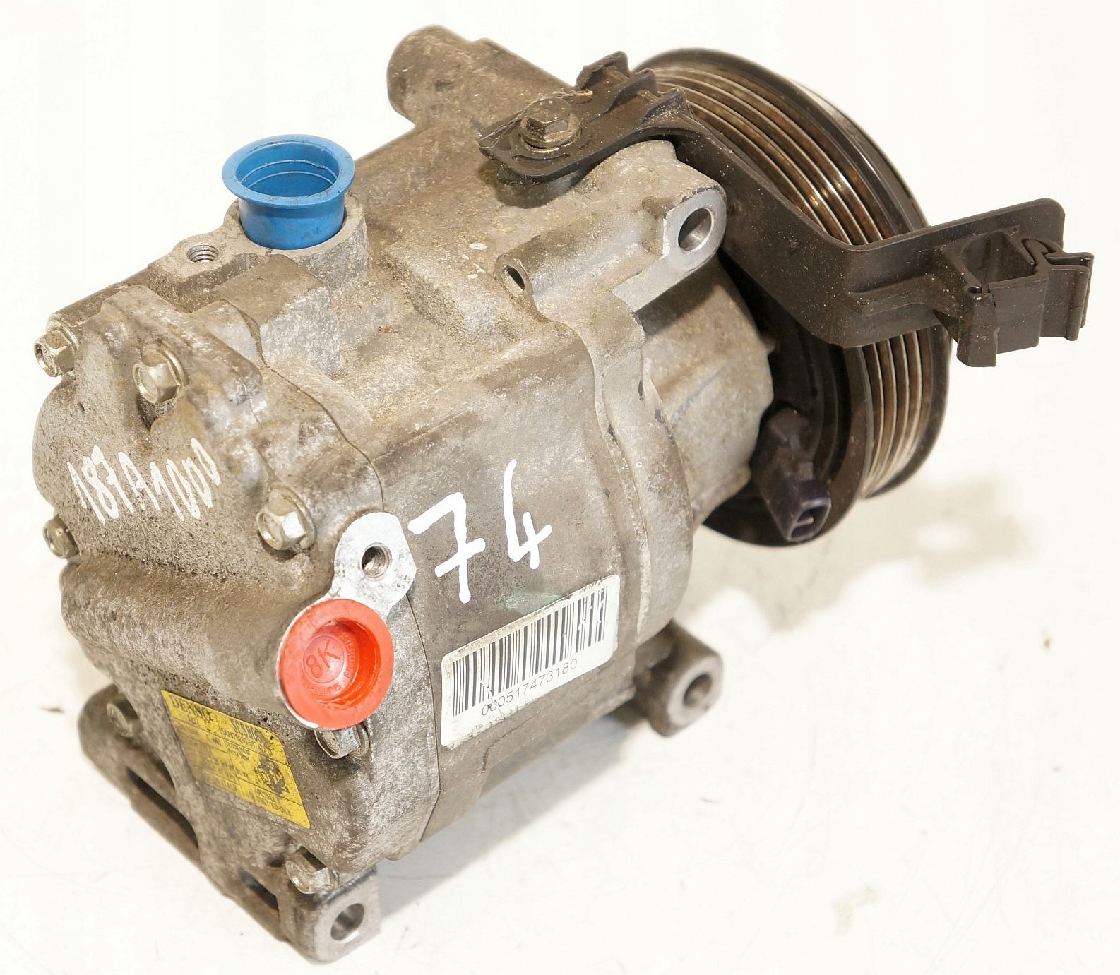

Google Images, example search...looks like an A/C clutch connector. Unusual latch placement (on the shorter side, not central tab).

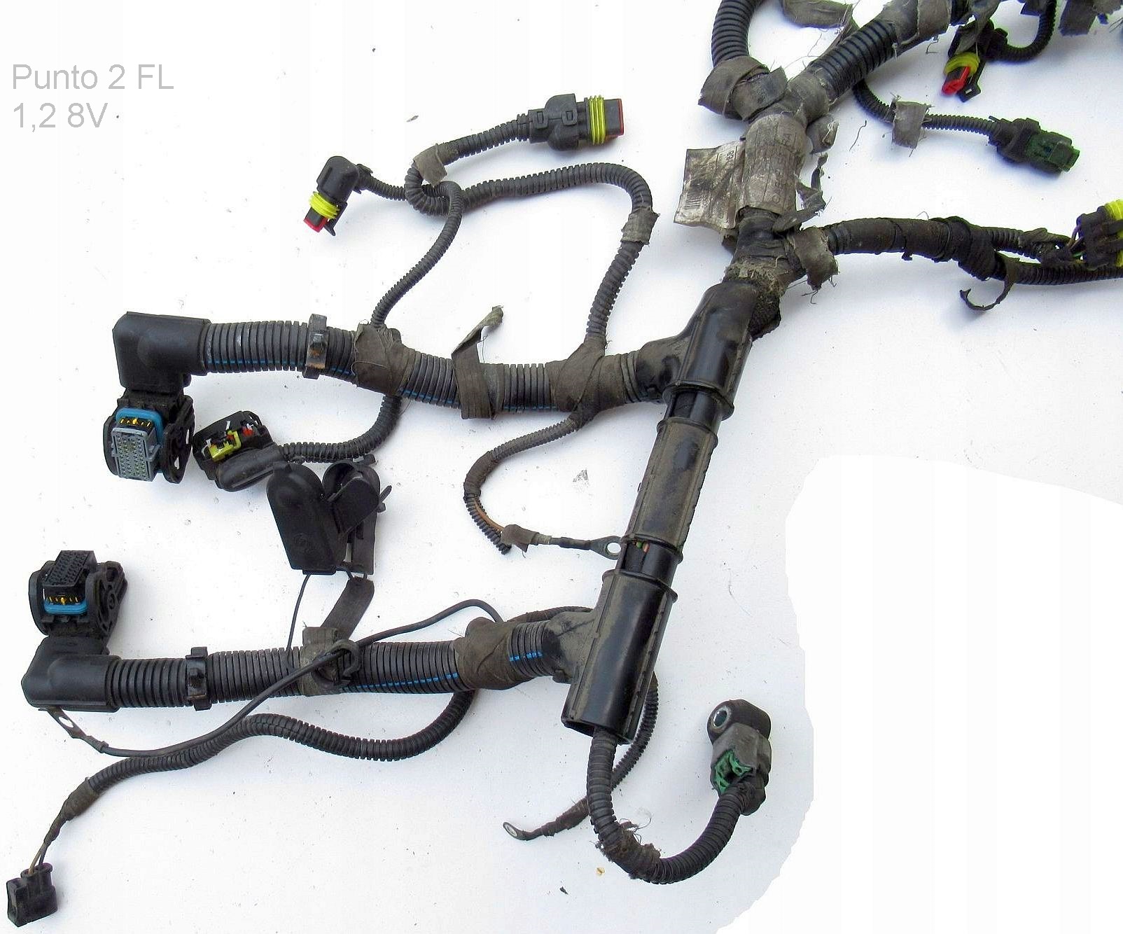

Example engine bay wiring loom/harness, Punto 2 FL 1,2 8V. But we can see the "mystery plug" on the left and knock sensor one the right bottom.
Gearbox speed sensor ("impulsator") is a 3-pin device (so that's not it)...
