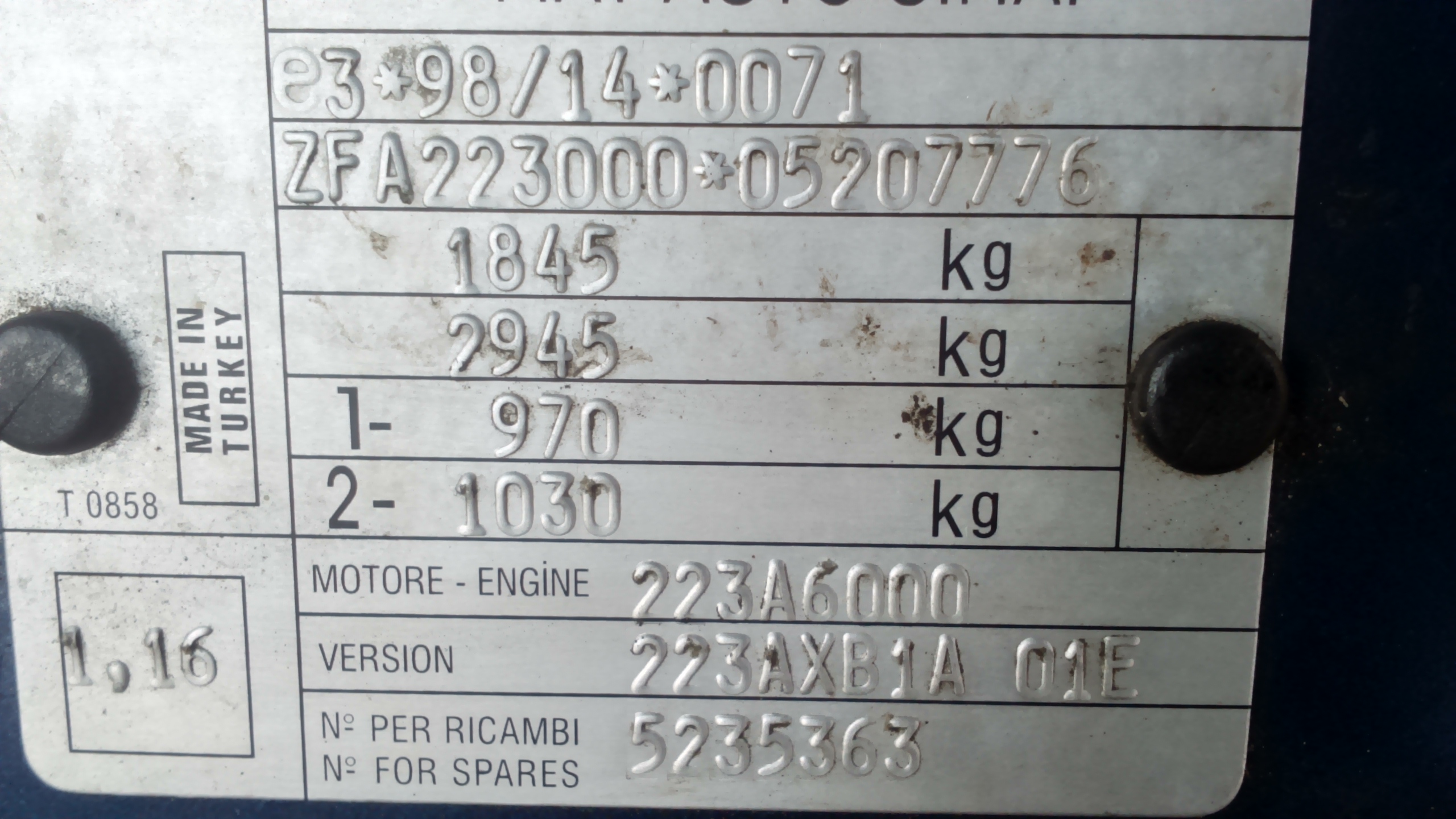

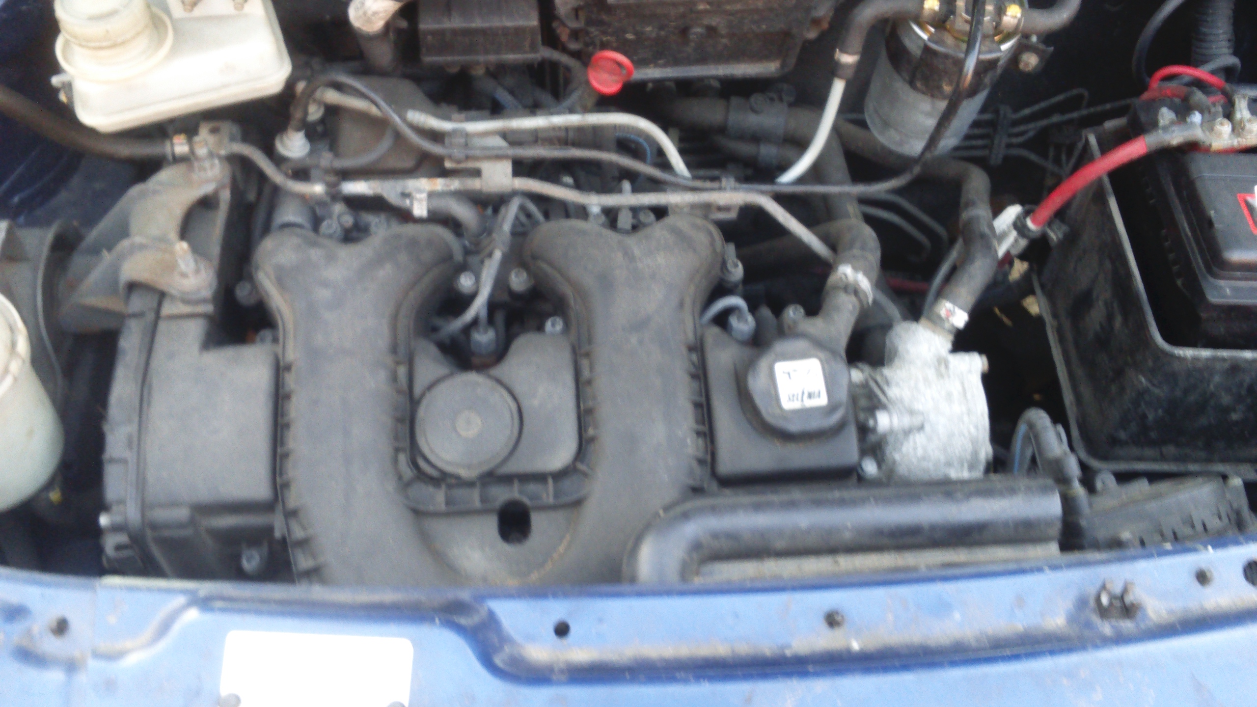

hi varesecrazy thanks for the reply, sorry if im being a pain with this,
the year of make is 2003
its a 1.9 d sx doblo
i believe it does have a french engine, but i have included a pic of the engine plate if it gives you any further info on the engine details,
i can do most mechanic things within reason but this is baffling me lol, it sometimes runs lovely but then you can always tell when its going to start playing silly buggers because the rev counter starts going up and down and the engine speed increases and decreases on its own,,
i really do appreciate all the help

Dont feel bad about asking :)
We just need the full info to be able to help ;)
Murfman seems to have told you all about turbos on a car with no turbo..?

These french motors dont use the standard FIAT common rail tech.
From the posts I have read on here there is a Lucas pump.. or another brand as an option.
Figure out which you have and SEARCH that.
To find the correct info on here ;)
