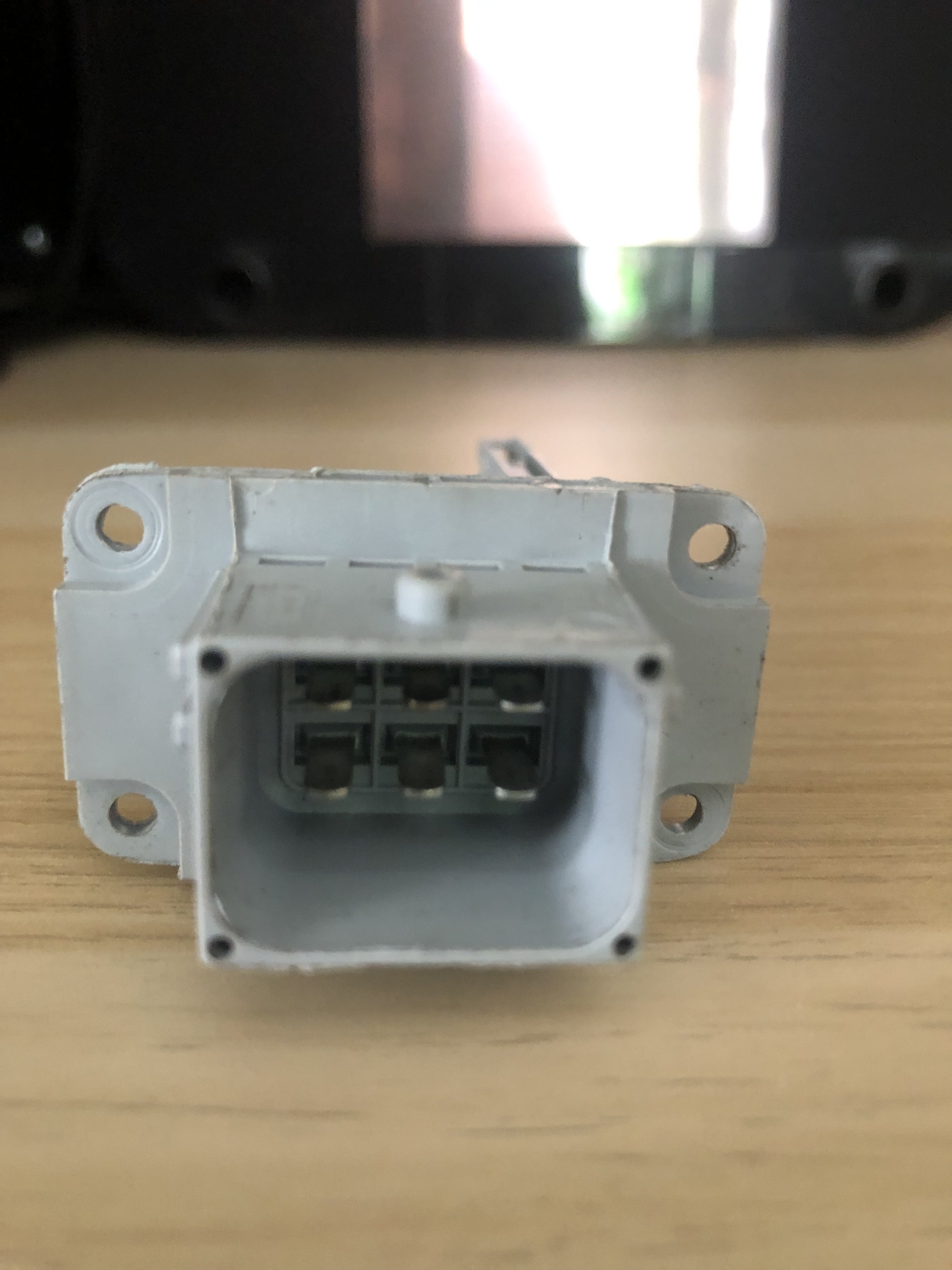

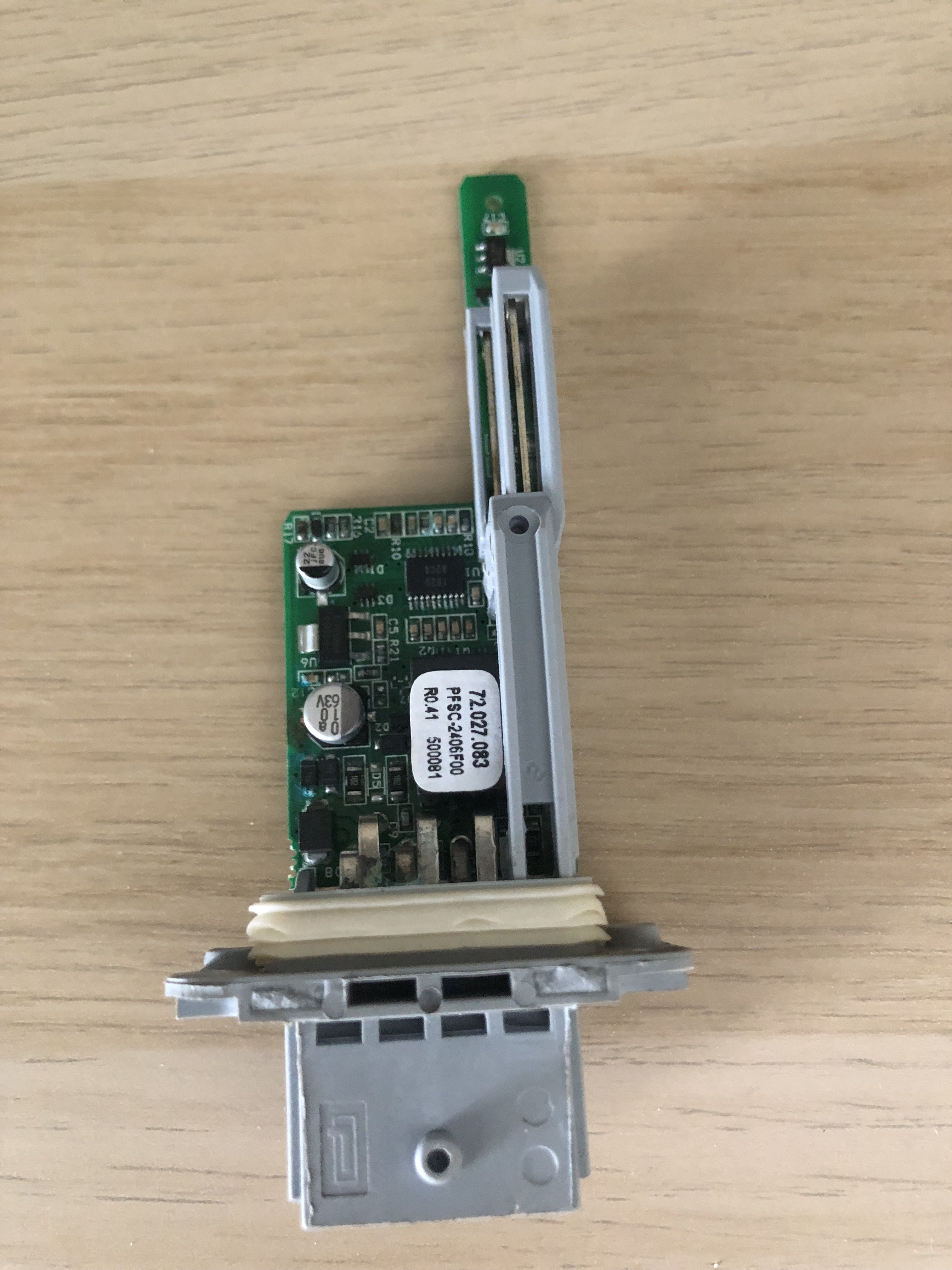

All sorted and working fine now, I did not need to remove the regulator and motor in the end. The replacement part I got today I noticed 2 screws on the 6 pin block removed them and inside is a circuit board ( I have added an image below it may help someone in the future). I changed the plug and circuit board with the one in my car with the regulator and window in place. Connected the 6 pin cable from the car and working no bother. So I guess I will be putting the remainder regulator and motor on Ebay now and get some cash back.
Also not sure if it is or not but mine has the comfort windows which may be why it has the 6 pins and circuit board.
Thanks for all the advice and guidance.

Apparently it is what they call them when you do not have to keep your finger pressure on the button for opening and closing. It is standard now but there are 2 different types of regulator and motors for this model. Autodoc describes it as Combi Switch Function:with comfort function.
