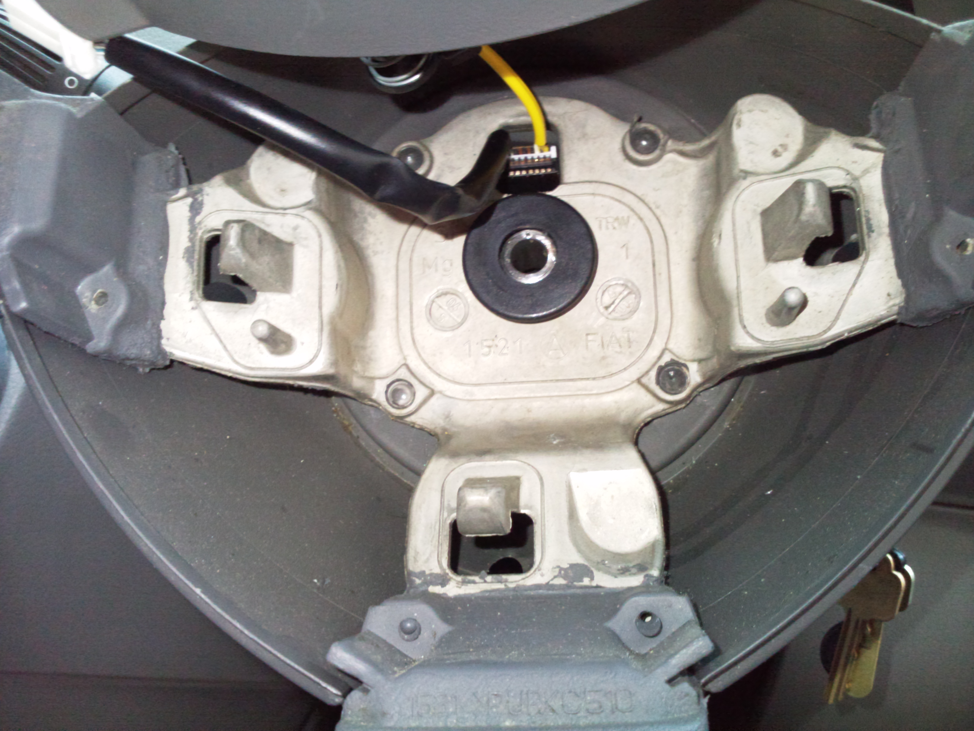

Your clock spring has probably had it by the looks of it. If it has DO NOT drive the car unit you've replaced it, as you'll risk the airbag going off!
As you've suggested though, pop the airbag off an check it's not a loose connection under it, hopefully it will be for speed of repair, and cost.

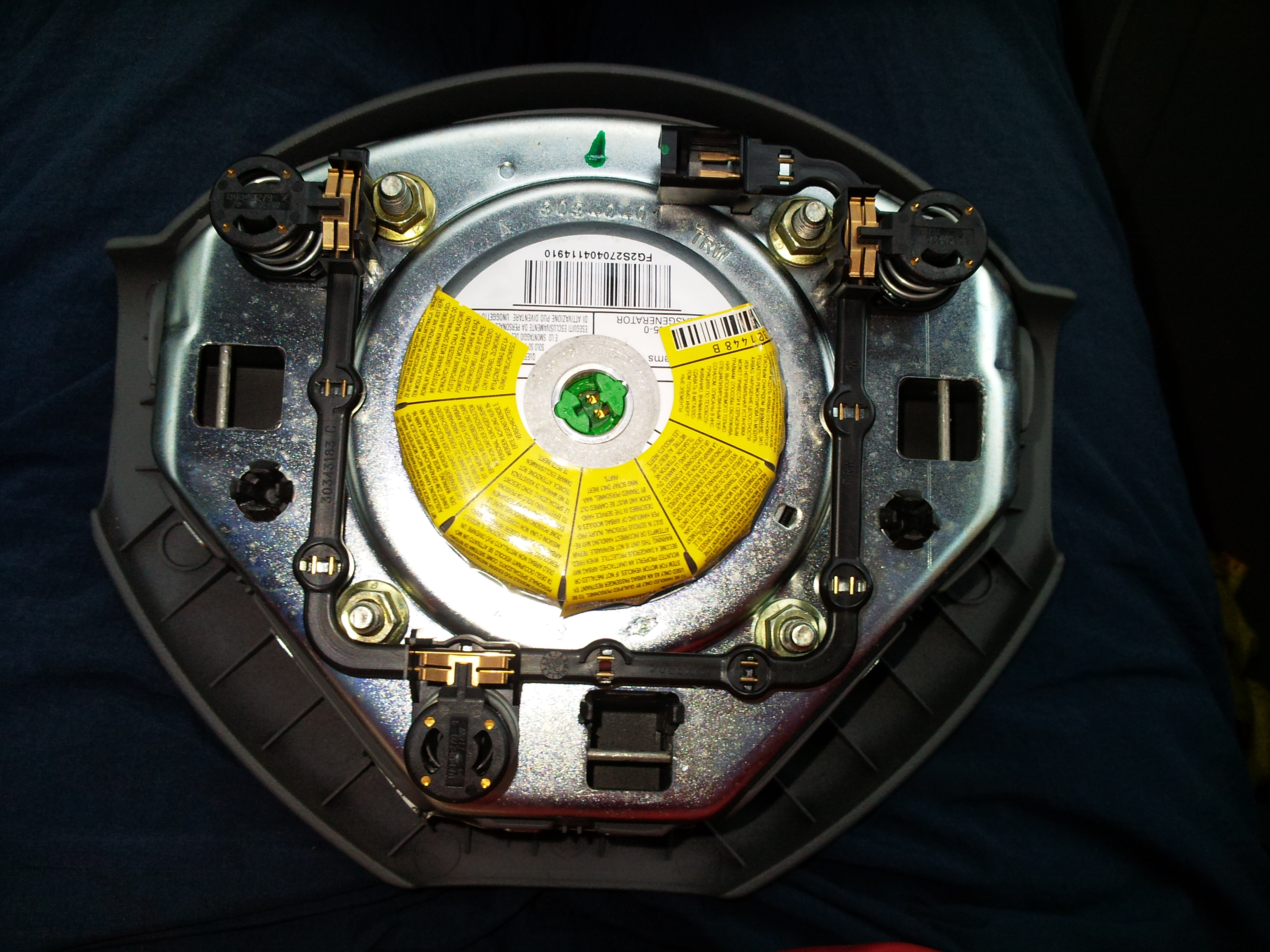

Well you'll be please to know refitting the airbag is a simple case of pushing it into place :p
When you've done one clip you'll realise how the rest some off, and will find it fairly easy. There is a bit of a knack to it, You need to get the angle of the screw driver just right (y)

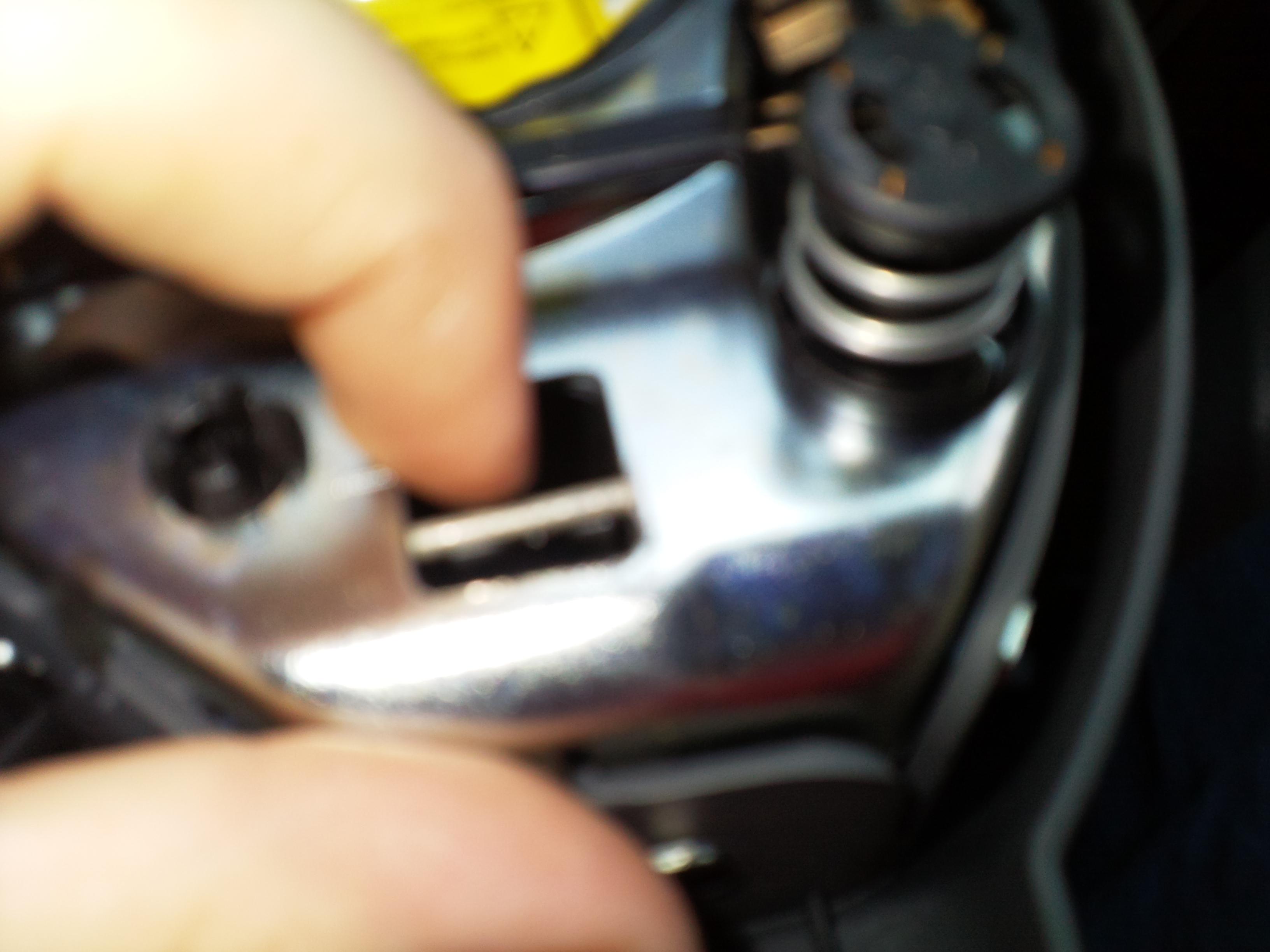

I'm Assuming, looking at the clip, there are two metal bars
I'm assuming I need to pull the whole thing "outwards" past the edge on the left
U see the hook arm on coming from the right hand side to hook over the pin bar. U need to place blade of the flat driver in between and not lever it but to turn it clock or anti clock wise and it should get clip to pop. Need a sharp enough driver.

U need to place screwdriver where I've marked the yellow line. Hope this helps
No force needed as they pop quite easy. Just need good angle and good driver placement.
thats the airbag removing tools compared to normal screwdriver.
