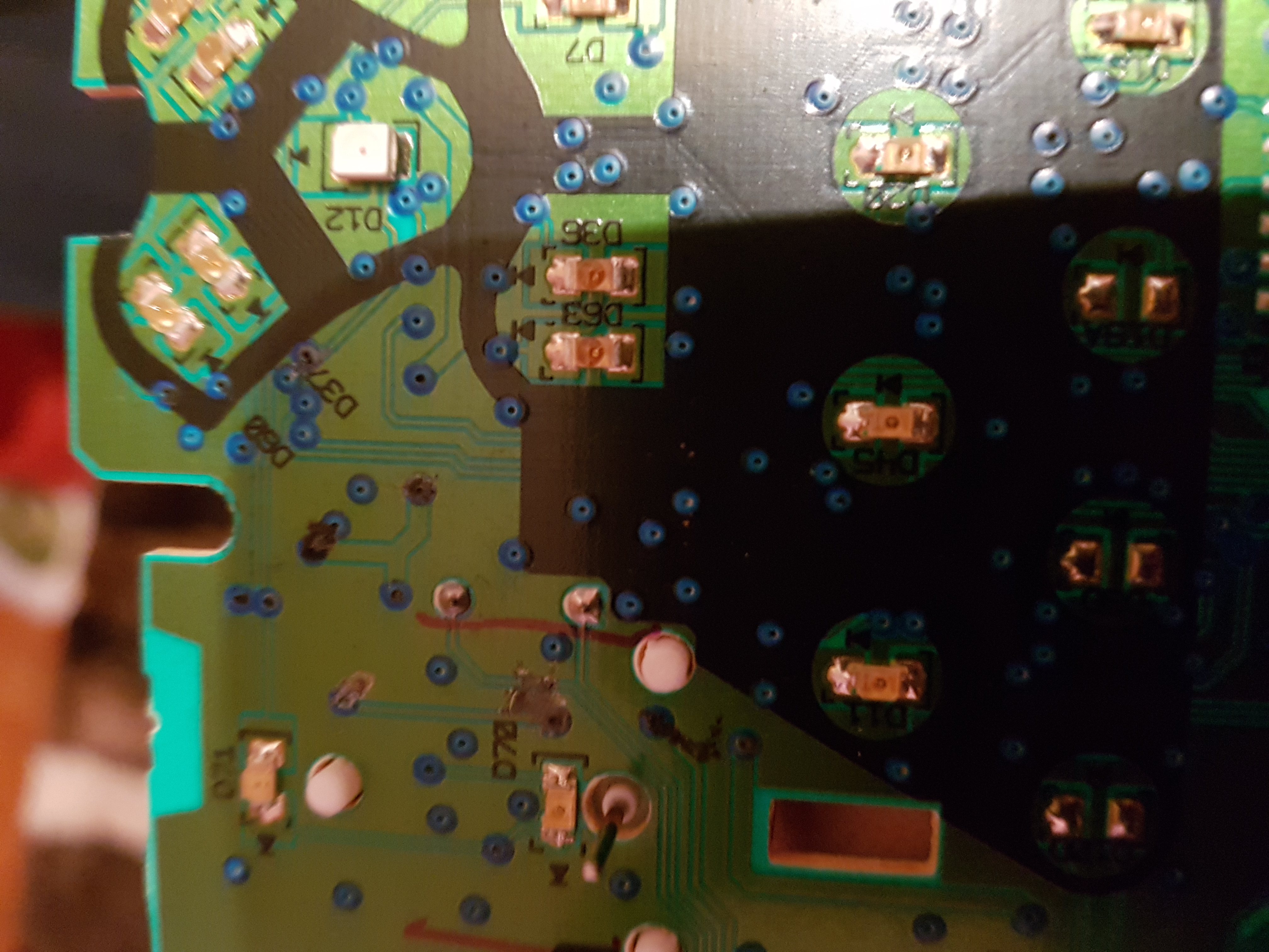

Thanks chris. The battery is fully charged now. The good news is I've got the dashboard to work. I took it out and stripped it just to the circuit board. Cleaned it and use a blow dryer on very small heat. I then put everything back together, even put the needles back on but only two needles are moving, the ref and speed are working. The petrol and C-H needle won't move when I turn the key.
Not sure how much the pin needs to be in with needle?? Sometimes it feels very tight and won't move. When I do get it to move the needle looks like it's hanging on with 2 or 3mm gap?? Is there an easy way for the needles to go on?? The ref and speed counter are ok, the needles went on easy!!
All done now. Taking the dashboard out, stripping it to the circuit board and cleaning it, also using a hairdryer on low heat sorted it out. The needles were tricky but got all four working. Thanks to the ppl who replied to my previous post. The only way to fix things is a good hard look on Google and find your answers!!
