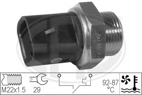

Did someone know where this is or if this models have this?And where is it.
yes i checked on eper is there but on my car i can't find it is not there where it shows on eper.and another problem did someone know where is the jack for the ecu on this model,i need to run an engine test and i cant find the jack

I found the ecu jack and i solve my problem whith the fans.i had an error in the ecu and the ecu doesnt let the fans to run.i cleared the errors and now all is working great.thx for help.
Under the hood on the passenger side my car is have the steering on the left side so the jack is on the right under the hood
