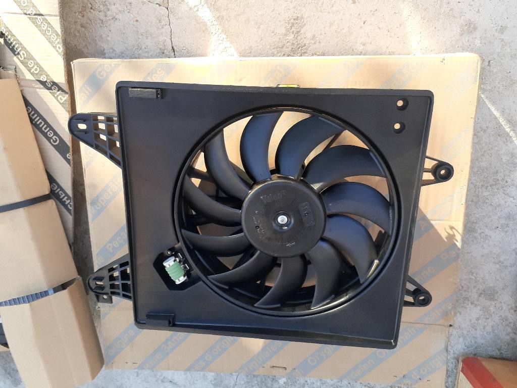

Replace your resistor fan. Its located at the bottom of radiator fan casing. Resistor fan for speed 1.
