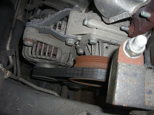

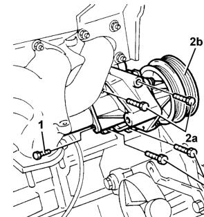

The water pump isn't driven by the cambelt on a 1.6 engine, it's very different from other Stilo engines.
Here it is, above the alternator, driven by the auxilliary belt
It's entirely separate so it wouldn't have any influence on the cambelt. You could change a 1.6 water pump and it's drive belt without even touching the cambelt area so there's no need to change it's water pump just because you're doing the cambelt
