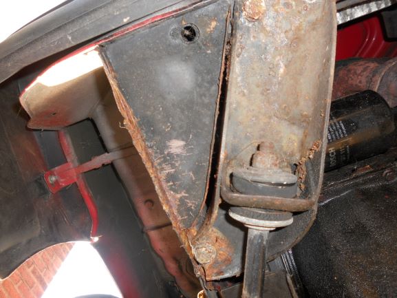

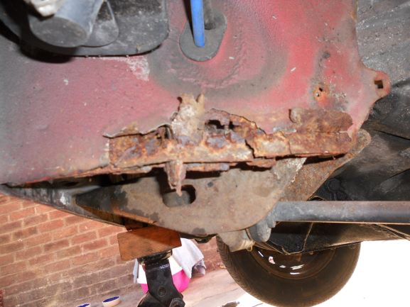

Well I am slowly (very) working my way round the old Panda Colour and I came across a case of tin worm a bit worse than I expected.
On close examination it looks like the chassis leg near the front suspension mount has previously been patched over, no doubt for an mot.
Can that section be safely chopped out and a new piece welded in?
Also when I look from underneath at the front suspension mount area I see that the driver's side has a triangular shaped fillet piece, and the passenger side doesn't (the passenger side is where the above-mentioned rot is).
Is that normal or has a piece gone missing ?
Any comments and advice as always gratefully received.

Thank you. Yes I amk making sure of that, but I don't think the bodge-merchant in the past has done that because the patches themselves have rotted through!
I was just wondering if there is a good way to fix that area of the car.
I guess I will cut / grind off the holed patch and then see what remains!
