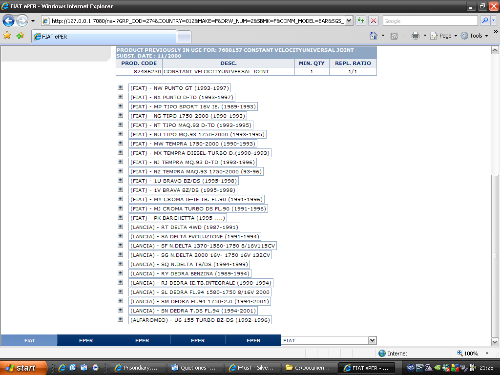

when going backward to street and turning to some side (still going back) then i hear some tup-tup noise from somewhere probably front wheels... it's like flat tire on bike and you can hear when you drive over valve... it's terrible, and only when going back... like i'm driving over some small humps... any ideas?
what's the price of CV joint? do i need originals or they can fit from some other fiat... like tipo? because if i said that i need for barchetta then price will go 2x....
