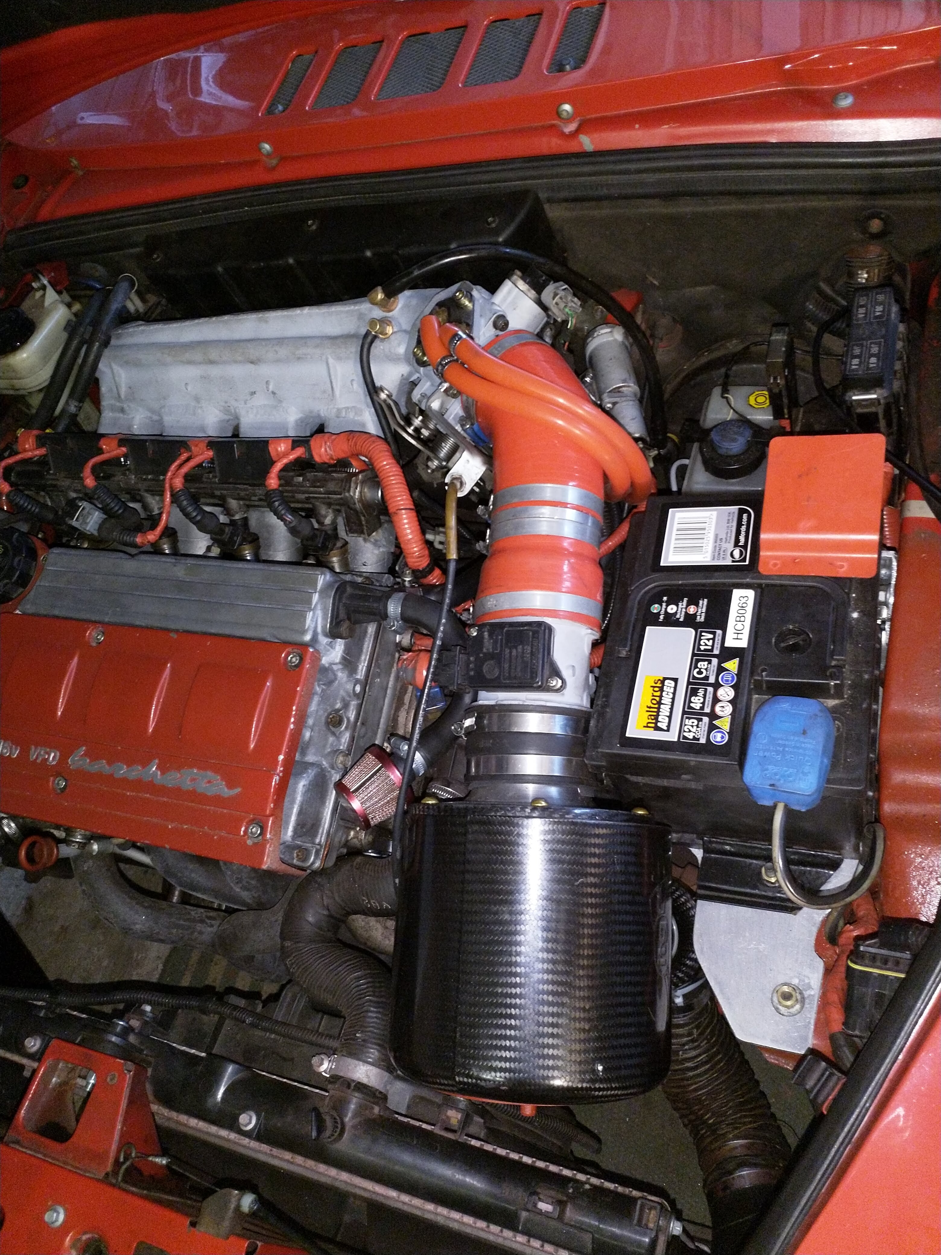

Interesting thoughts, regarding the heat shield. I replaced my shield with a new one from Fiat, probably one of the last ones on their parts shelf. But that very soon cracked and started to resonate. Did consider buying from Henk, but instead had it ceramic coated just to try to retain some of the heat. My original air intake system was cracked and not in good condition. So I fitted a K&N cone filter. This was fine but on warmer days the under bonnet heat just drained the power away from my poor B, despite the ceramic coating.
My latest set up is still the cone filter, but using an Itg maxogen filter, housed in the carbon fibre housing, to ensureI get cool air I have a feed hose from the lower front grill area.
Very pleased with this setup, I don't get any effects of the heat from under the bonnet.

Well your set-up certainly seems to have a much larger air filter than the more tradition small surface area cone filter.
The original Fiat large canister filter set-up is a pretty good use of available engine compartment space. I'm not really sure I can fault it.
Where issues/comments/observations do occur is why they (Fiat) have that long intake path from the the O/S headlamp area across and above the hot exhaust manifolds and also that other large cross front blind resonator chamber.
Just air temperature/density logic would suggest taking the air feed directly from the N/S headlamp/wing forward area.
Your intake system seems to reflect what I was pondering but for both of us the original resonator tracts/chambers and their performance functions need understanding.
