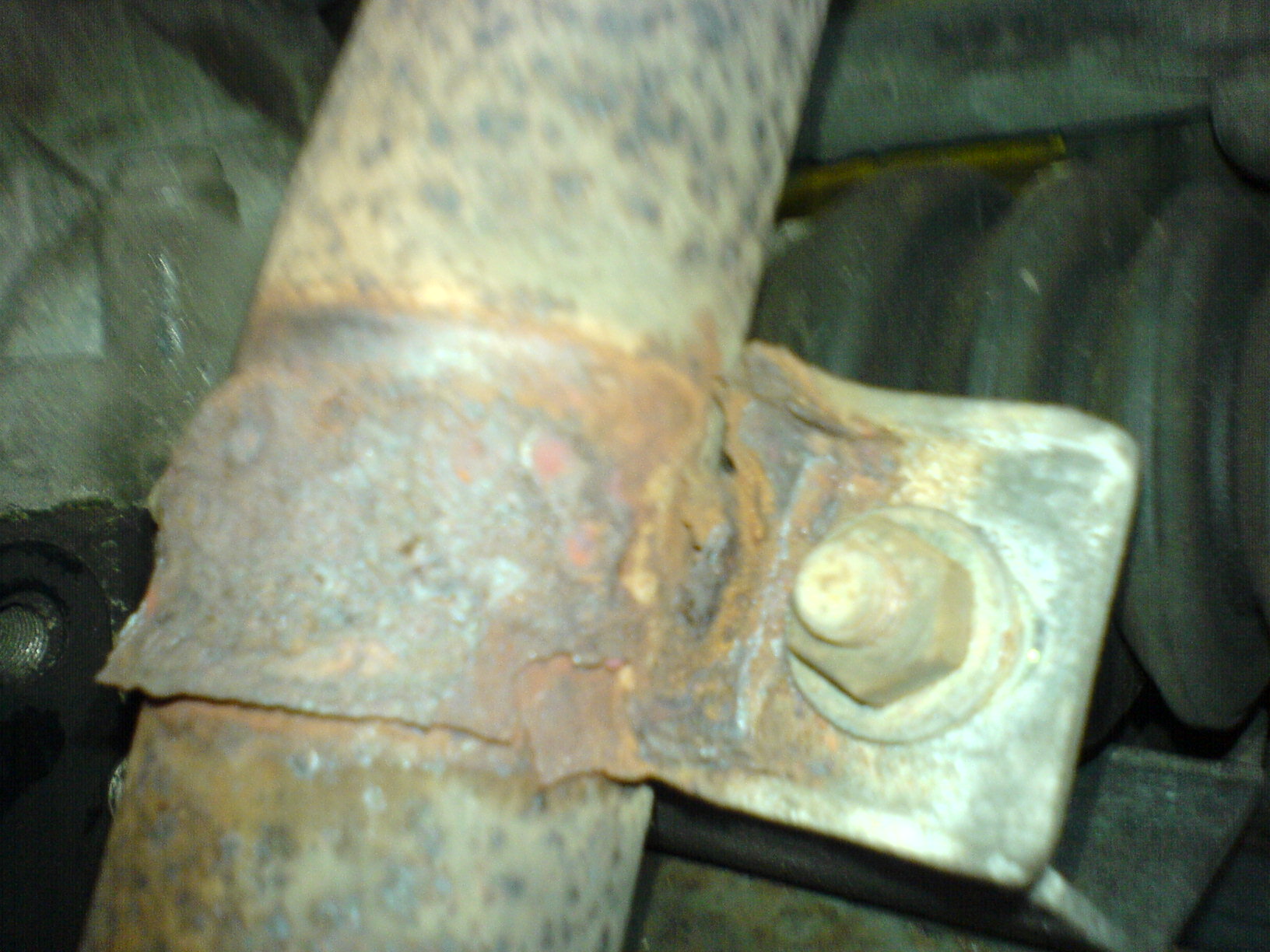

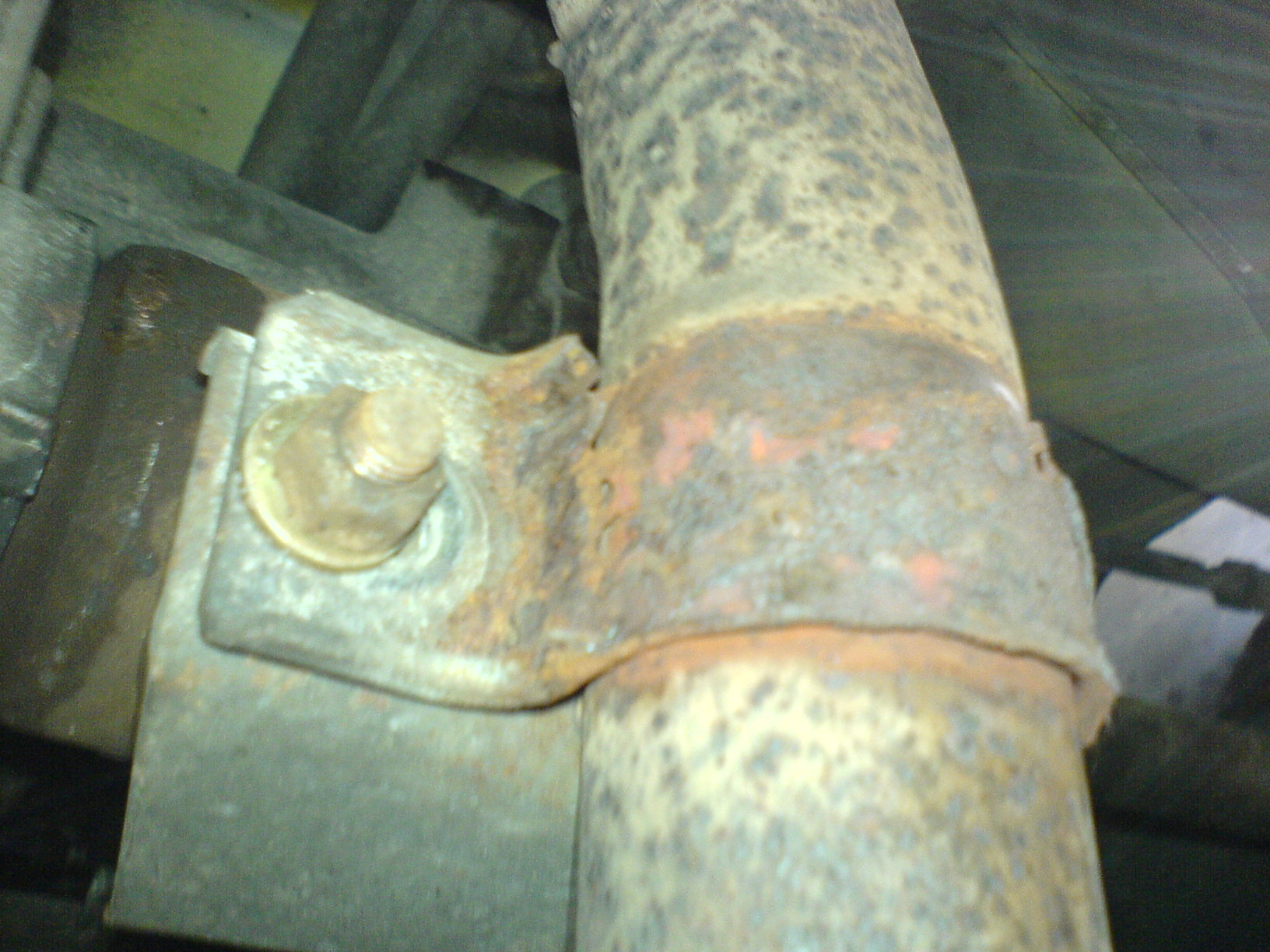

my exhaust bracket on my cinq under the engine, has rusted through, and is causing one hell of a noise, I was trying to find a replacement one, but none on shop4parts and ebay.
I think it should be easyish to fit as the bolts dont seem to be that hard to shift,
any idea where i could find one??

Just come back from getting the part from fiat, put some more WD40 on, but the bolts seem very good condition, gave one a go with a spanner, and it turned a bit, so (y) (y)
Thanks for the help

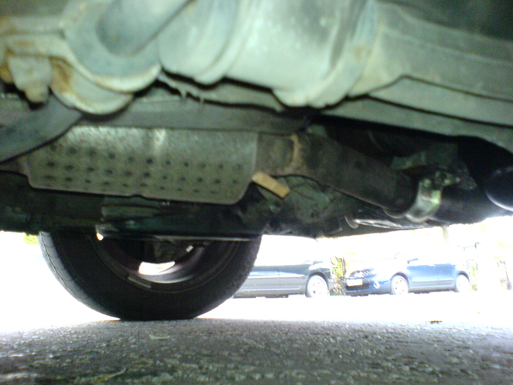

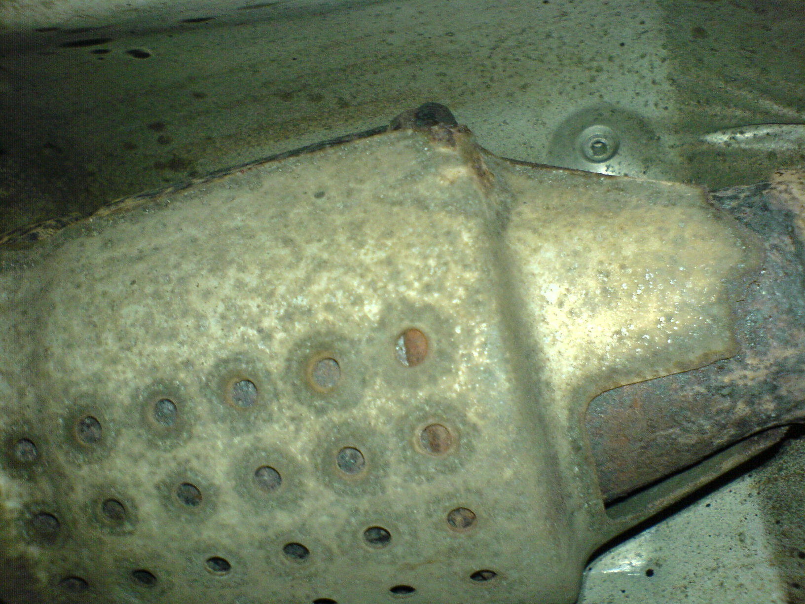

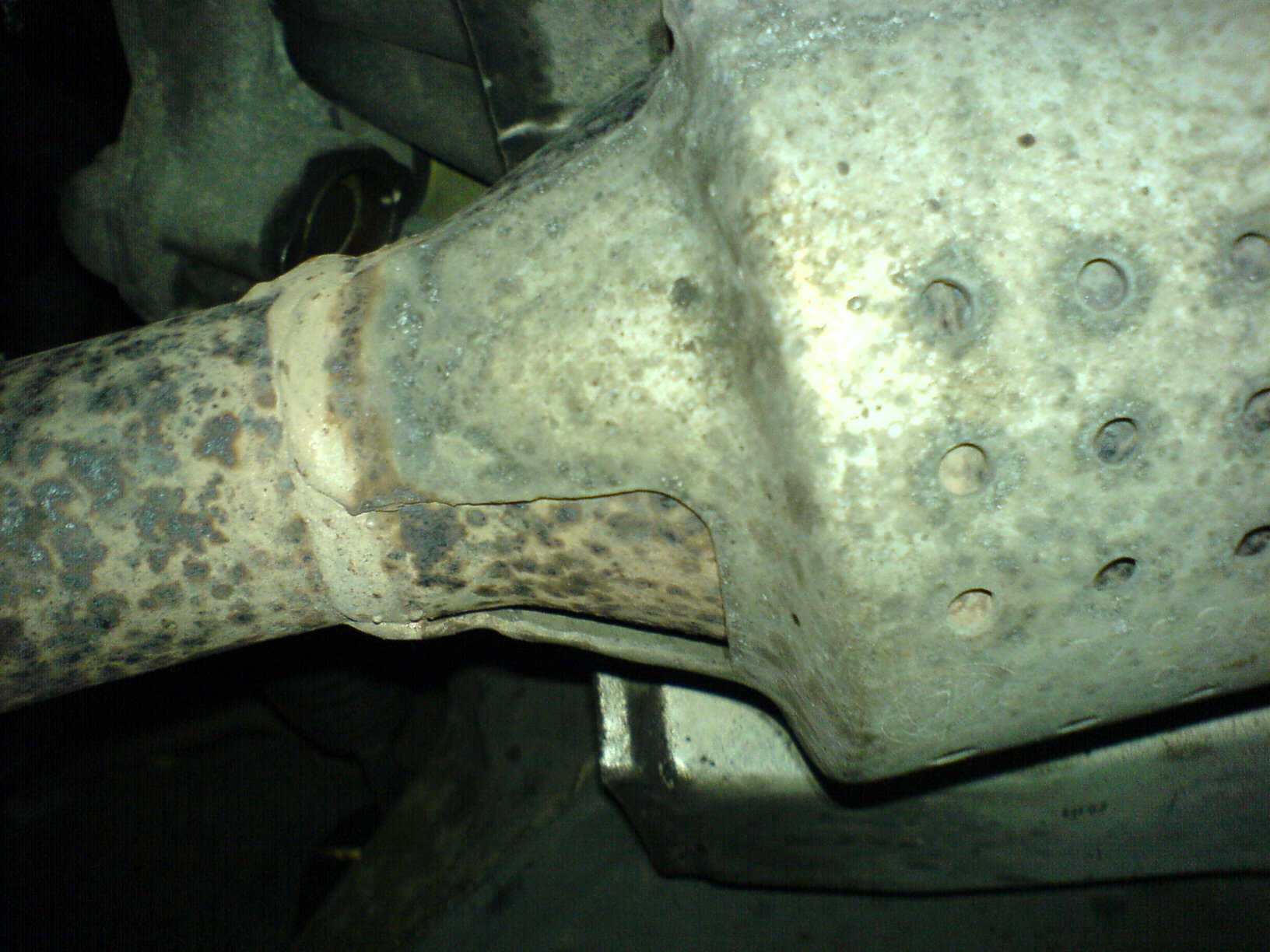

Changed the bracket, that sorted out one rattle, but the other rattle, seems to be coming from the heat shield around the catalytic converter , I put a peg into the gap and it has stopped rattling for now, but with Edinburgh roads i don't think it will stay in very long:bang: :bang:
Is there anything i can do to wedge or remove the heat shield, but i dont know how it is held on in the first place, and access is very tight.
Thanks in advance, I also uploaded some more photos , as you can see in the first picture , where the peg is lodged is the part that is rattling

sorry about the late reply had to do a journey (450 miles) to go back to the house :bang: , kept banging in more pegs when they fell out :D
i will try to bend the shield to stop it rattling, and also as a double measure put some silicone sealant round it, that should get it sorted.
Cheers for your replys:slayer:
just take it off. Mine was loose at one end on my first sporting.
All it is is a shield for the cat, its kinda hard to hit, my current cinq is lowered 40mm and i live in speed hump central and havent managed to hit it :p
does it look like the welds holding the guard are on their way out? a quick wire brush over the part thats gone and a spot of mig weld will sort it.
I would have thought that pegs, and I assume they are wooden ones, would just burn away as the cat gets very hot indeed. Good bodge though, if it works!
nothing like a good bodger!! (y)
