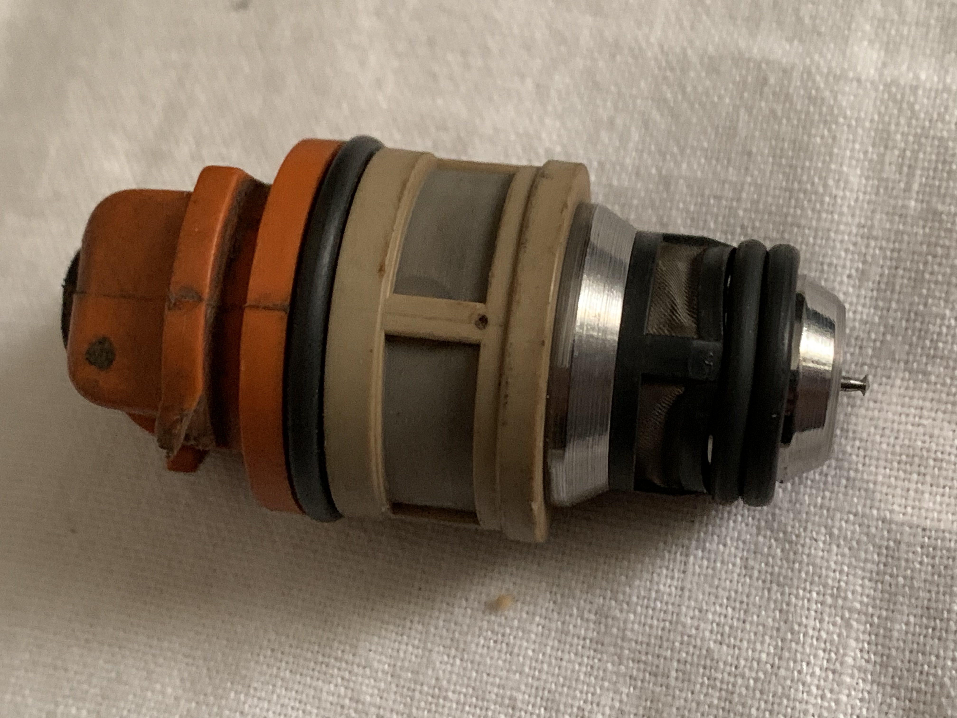

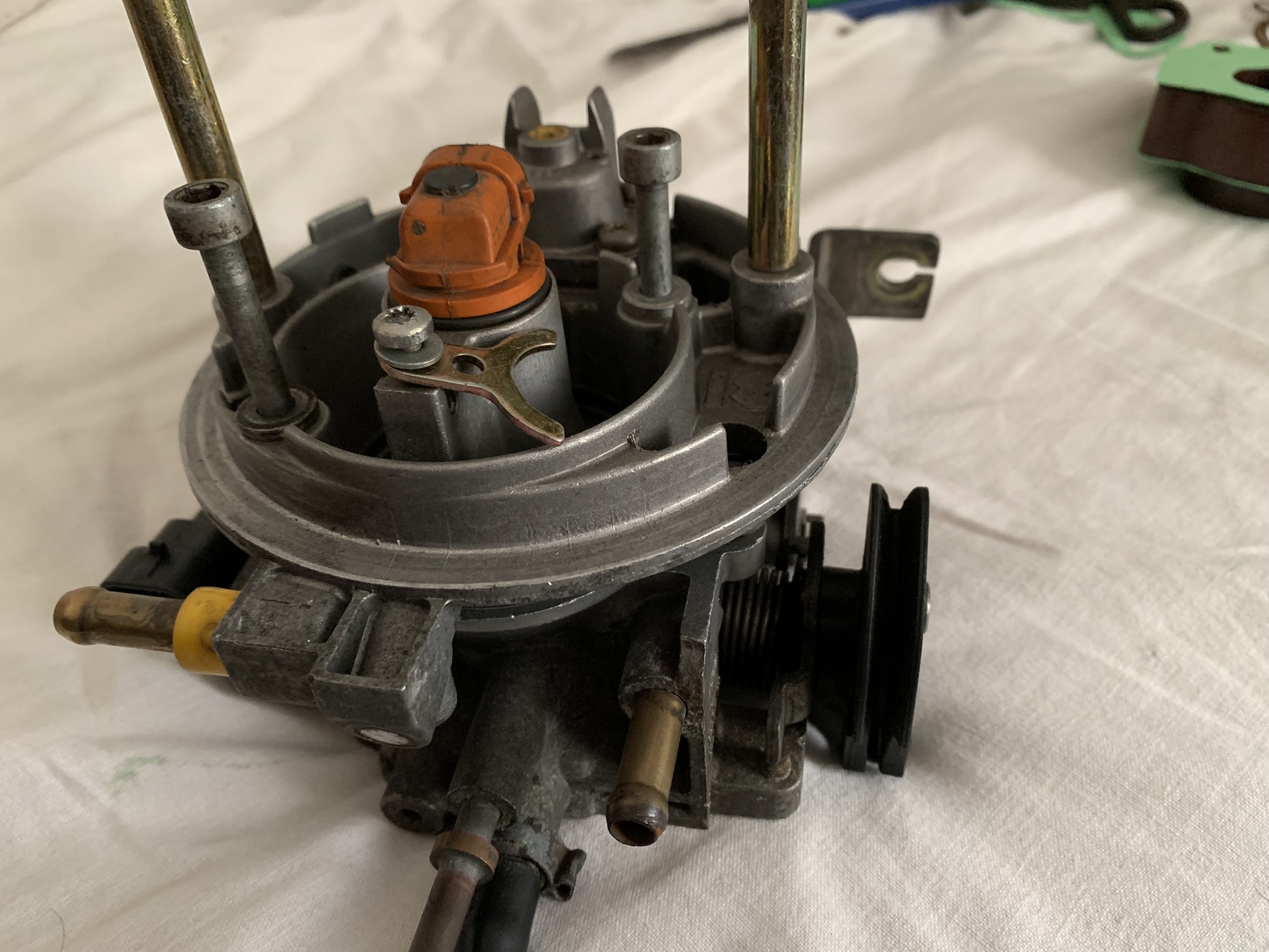

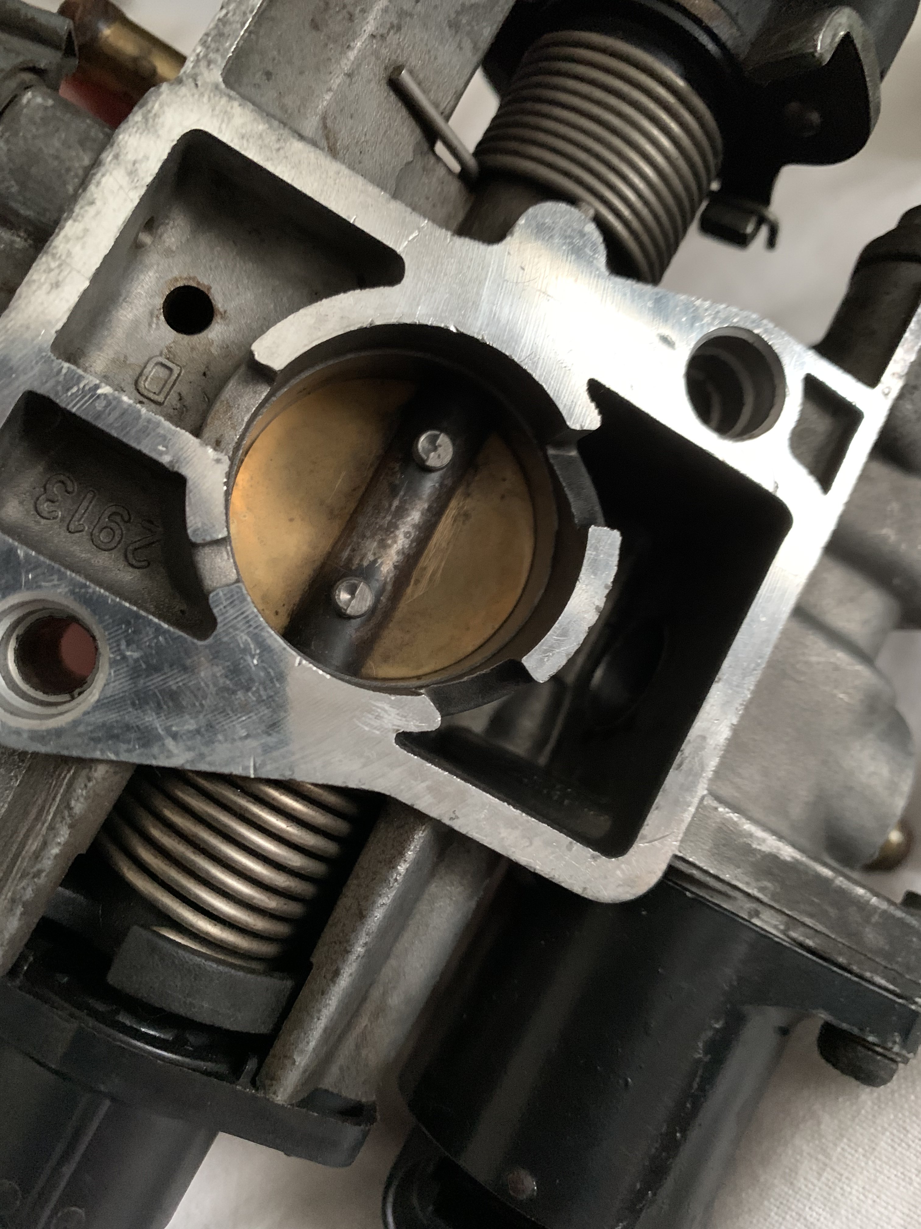

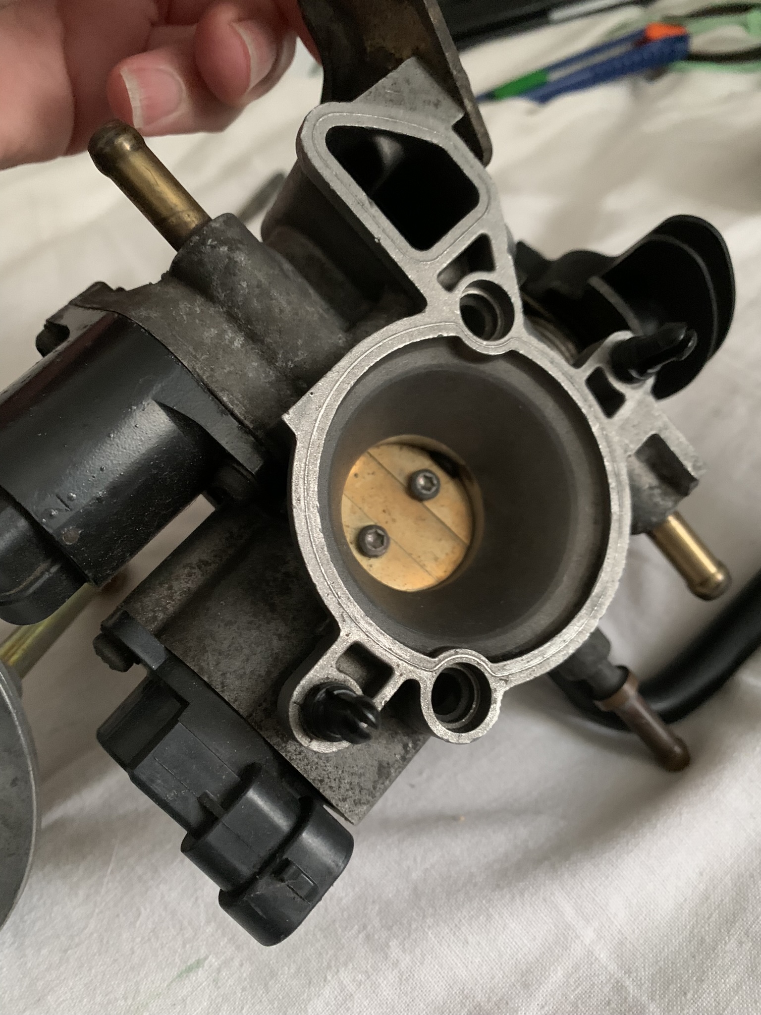

I have another injection body , include the admission collector , I have buyed a more long fuel pipe to test if the injector is not loosing fuel in the o ring , have buyed joint glue to guarantee no false air is entering . In next days I expect I have more news about this.
