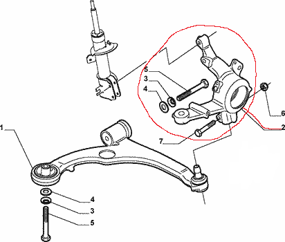

1 the AXLE SHAFTS are from the alfa?
fot the question nr 2 i put a pictuire,
the spindle it's the part from picture that had's the nr 2

So...
1. Regarding the drive shafts, I made new custom ones, which have one end of Alfa Romeo's style and one end of FIAT Stilo's style.
2 & 3. So as you understand, the hubs are the same, (eg. Stilo's OEM).
I hope it is clear for you too. ;)
