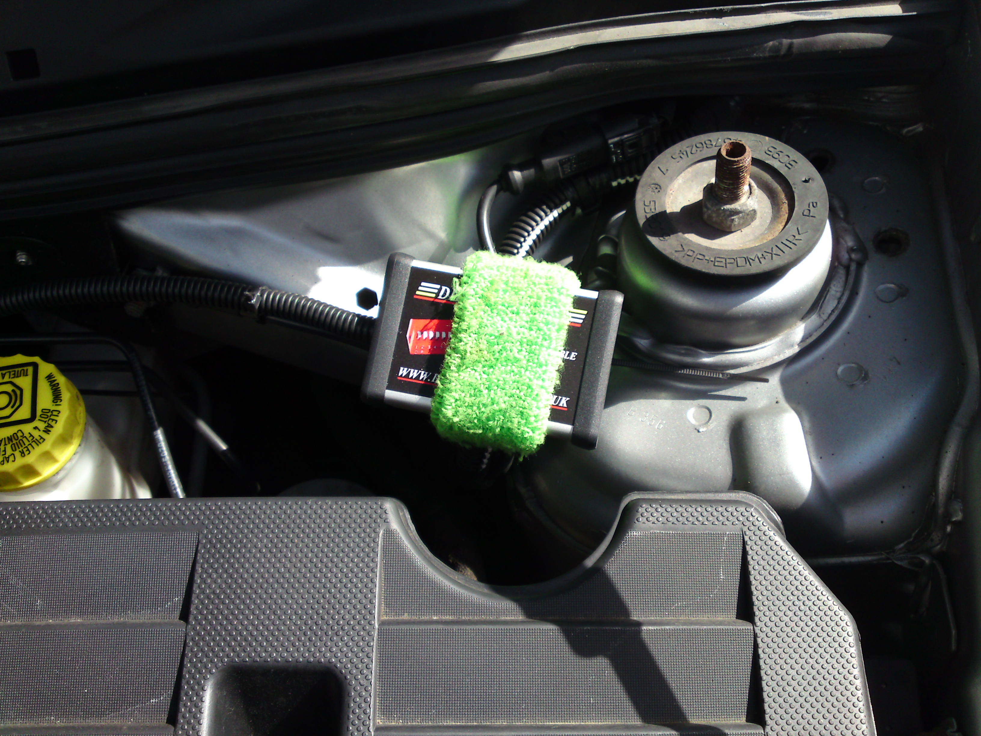

Its not complicated but it is awkward to get to if your like me and have a large pair of mits(hands).
1. Unplug the connector on the end of the common rail.
2. There's 2 connectors on the tuning box, 1 female, 1 male.
3. Plug the male into the common rail.
4. Plug the original connector from the cars wiring into the female connector.
Thats it.
Cable tie it all into place. I used a sweat band to hold the actual unit in place because cushions it from the vibrations of the car and allows me to remove it easily to change the units settings.
Turn the ignition on, wait 60 seconds for eveything to reset, then start as normal.
Full fitting instructions are supplied with the unit.
Make sure the ignition if off and the key out when changing the units settings.
