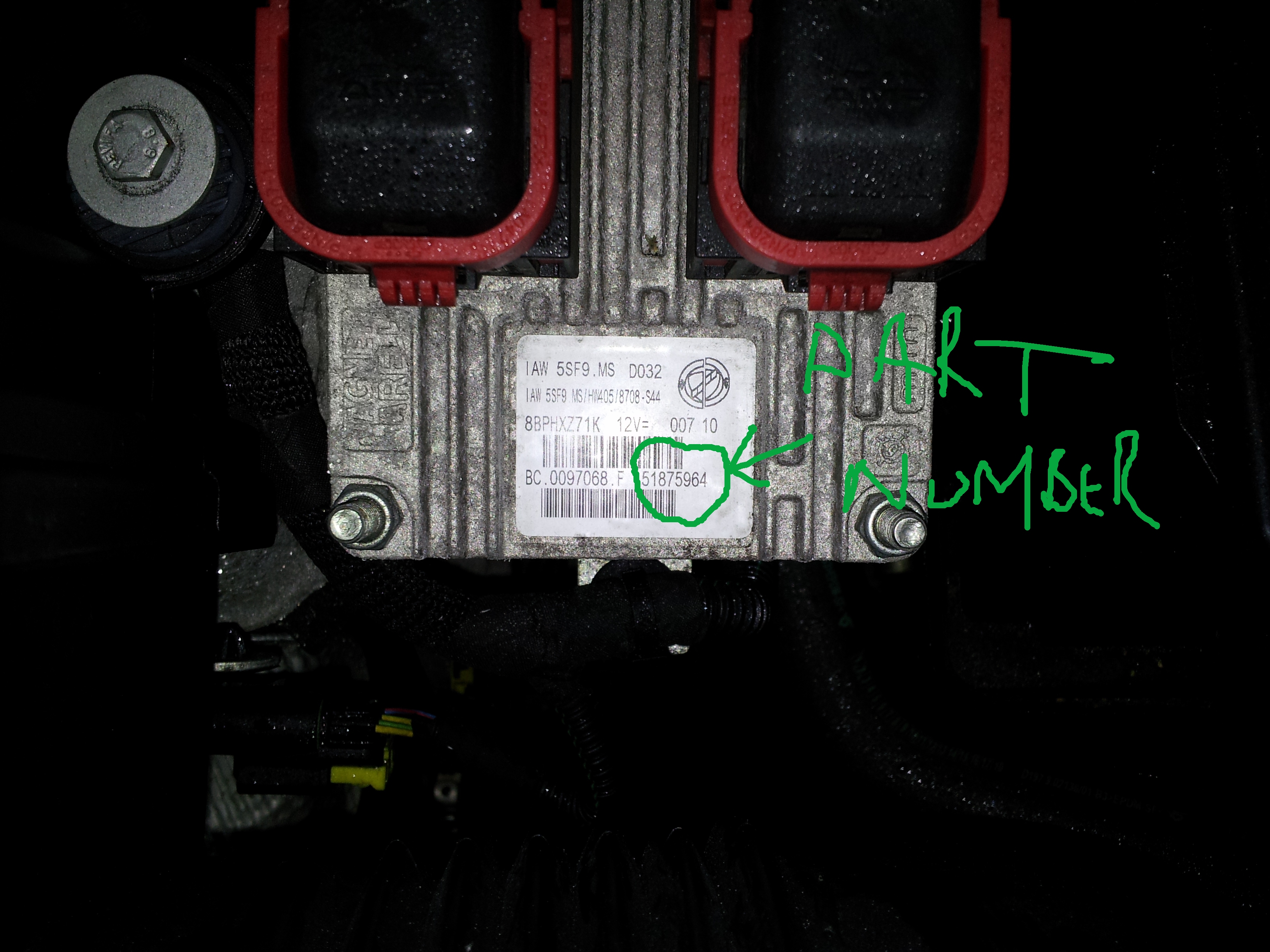

It's time to start collecting ECU part numbers (there've been a few different ones since the 500 was introduced, as a quick troll of ebay will confirm) - if we can associate the fault with a specific ECU part number, then anyone will have a quick way of identifying a car which may have this specific fault.

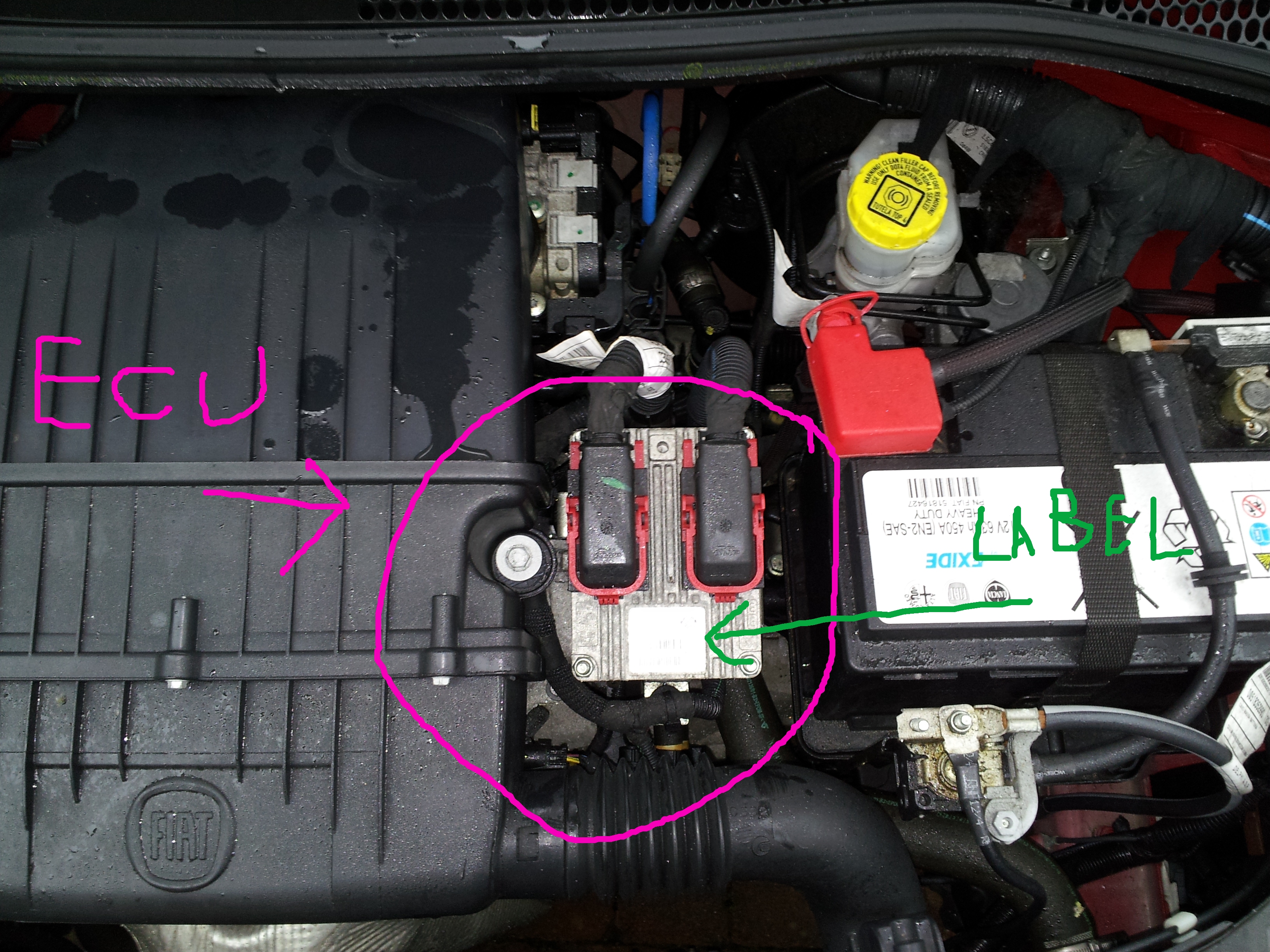

On mine, the ECU & its sticker are just about the first thing you see on lifting the bonnet - pictures attached.
I've shown you mine - now will fellow 1.2 owners please show me yours!
Month/year of your car would help also - what follows is a 2010 Euro 5 1.2 with S/S & the ECU part number is 51875964.

The new ECU part no. will have to wait until I get some daylight on it, but it looks nothing like the one in your photo’s jrkitching, mine is situated in almost the same position but mounted on a bracket which obscures the part no. and is long and thin with the connectors in line on top, not side by side.
I'm making an assumption (which I expect will be confirmed once we have a few more posts & pictures) that the different ECU is one of the changes Fiat made on the Euro 6 cars.
So it looks like we have an easy visual check now.
