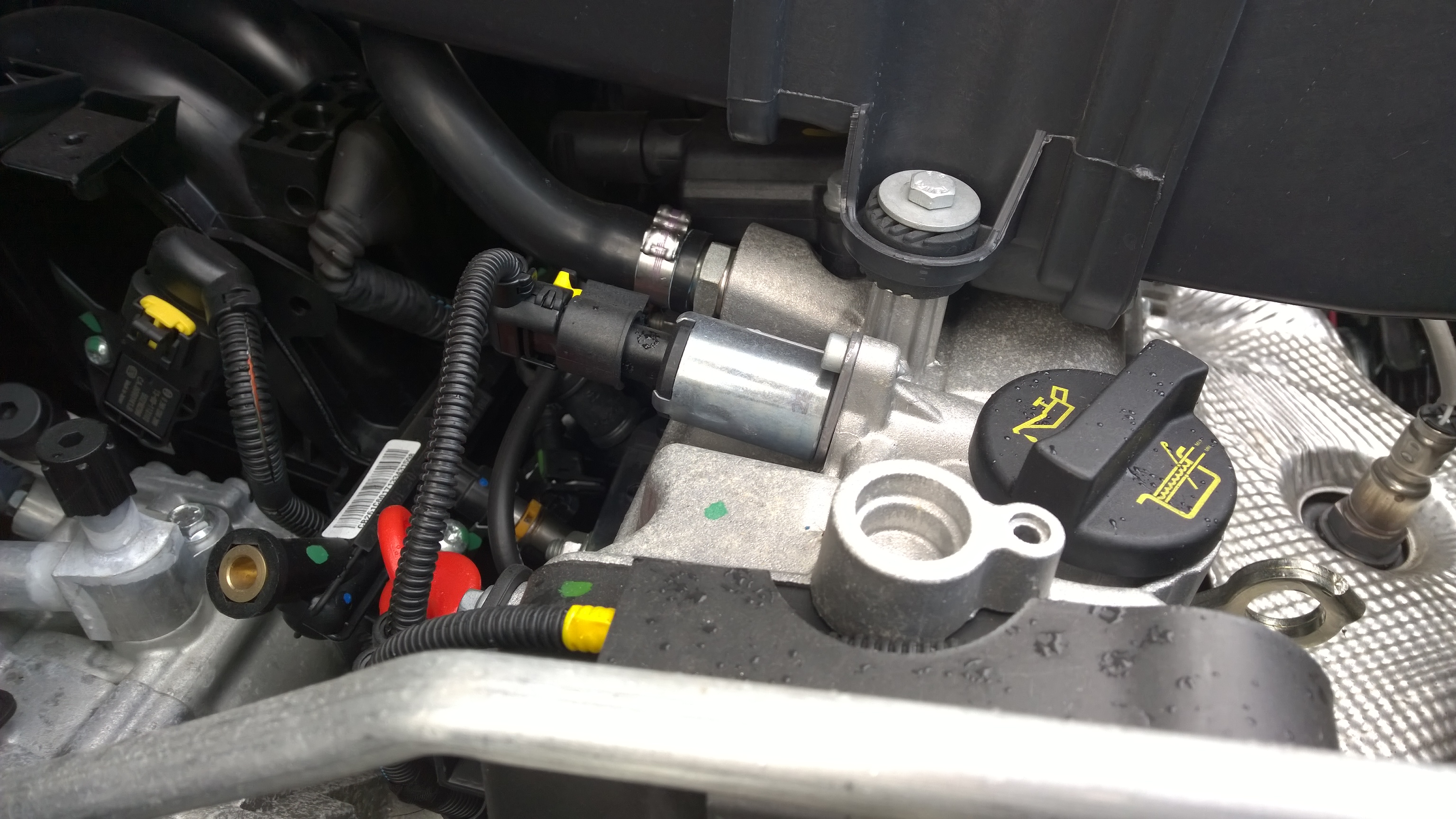

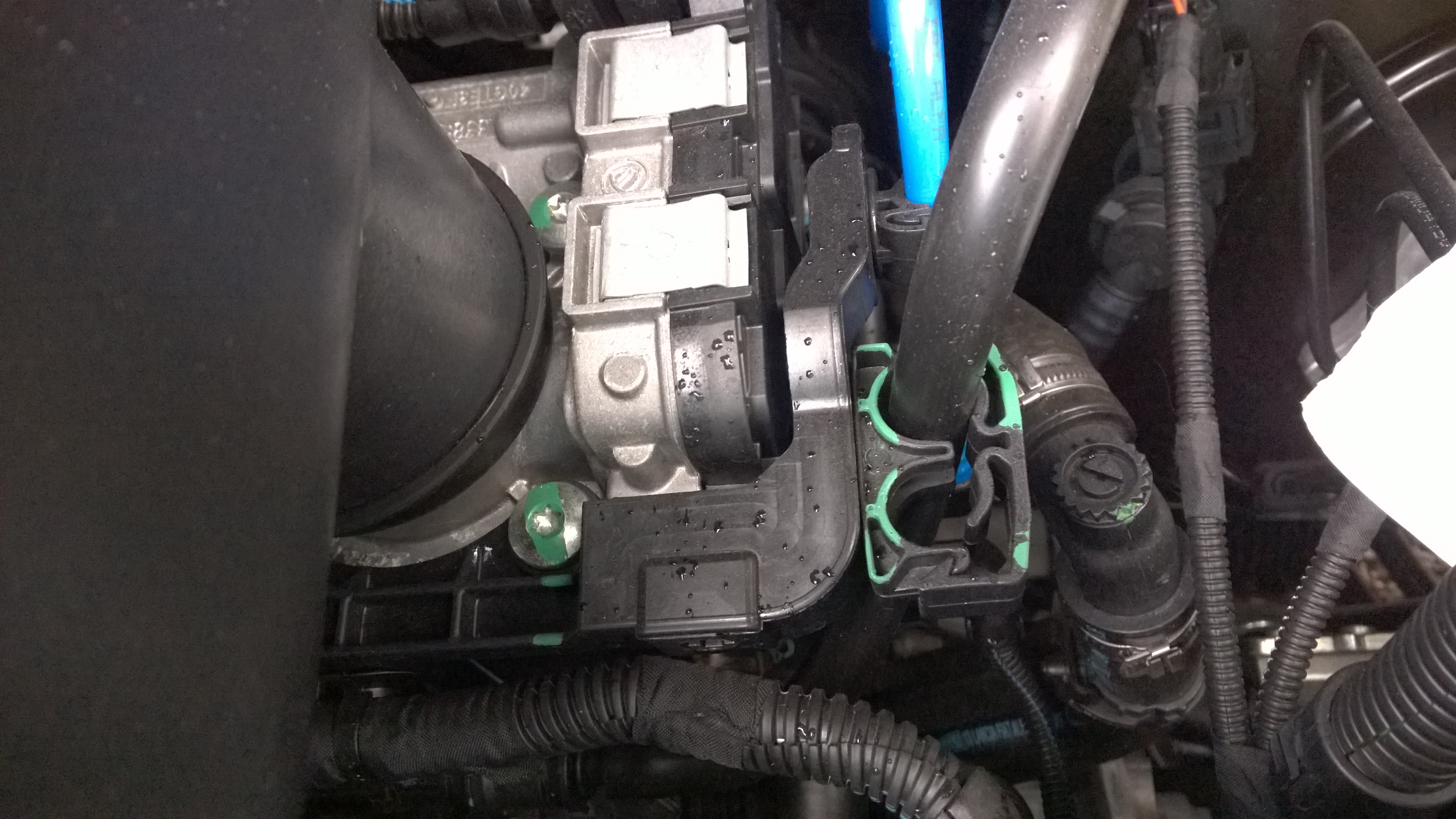

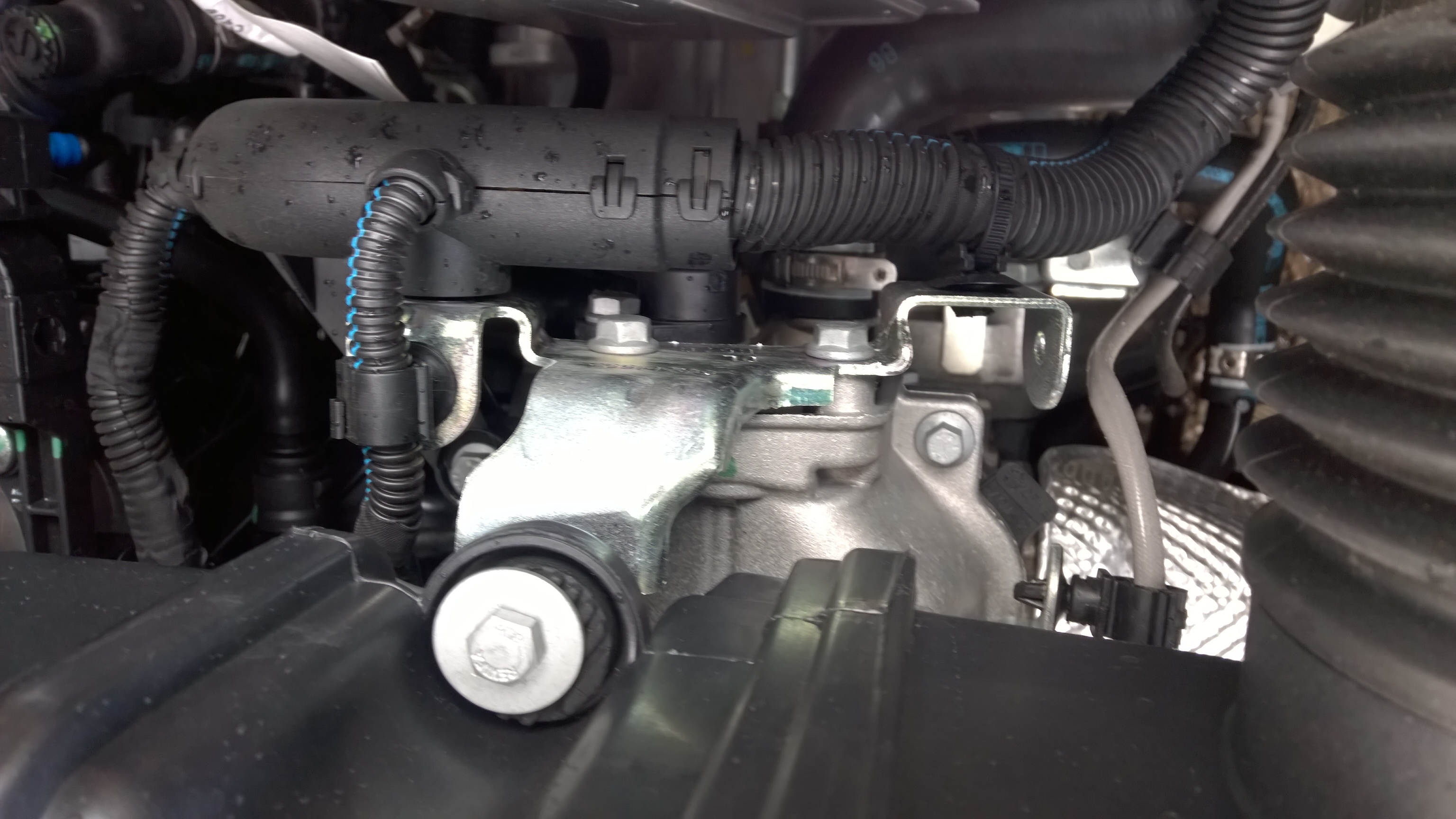

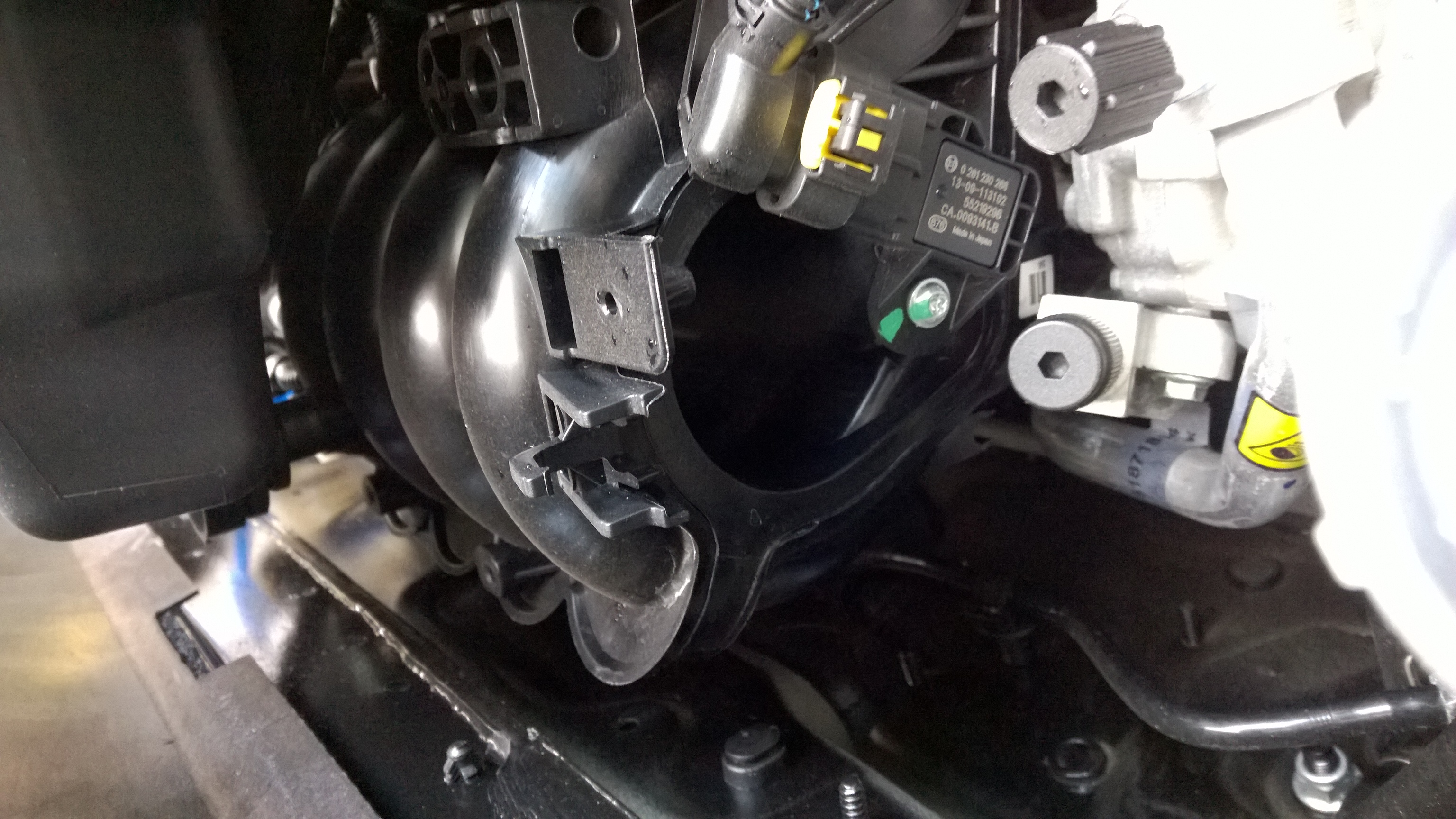

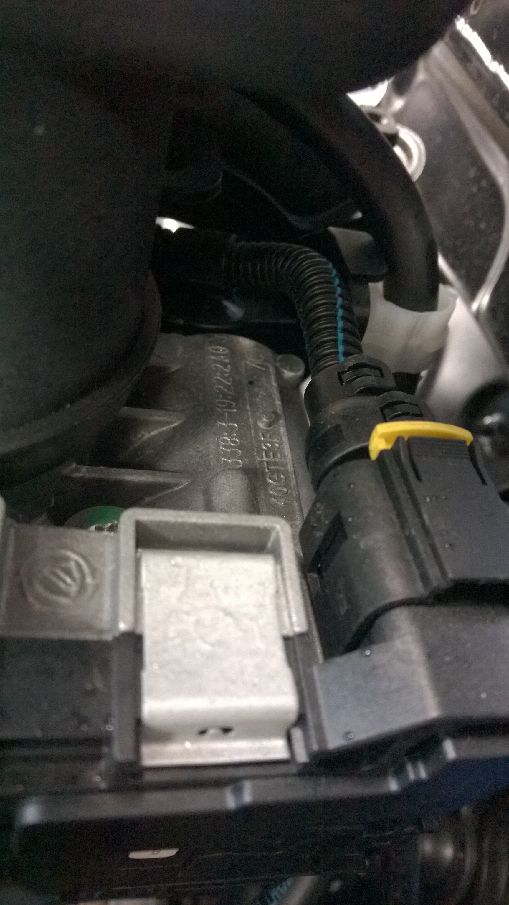

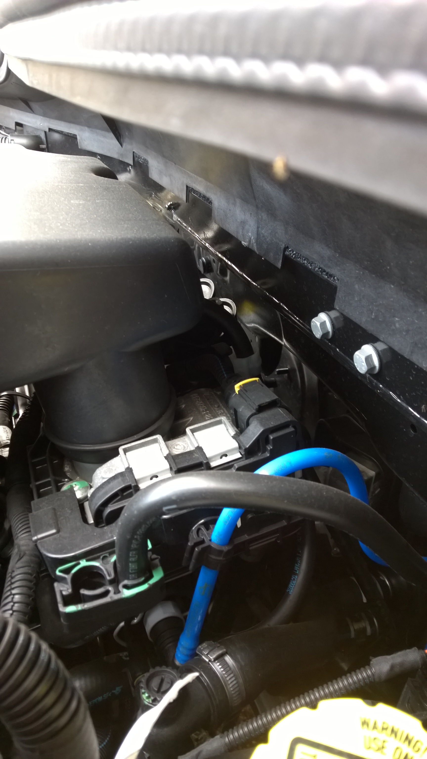

Engine bay photos

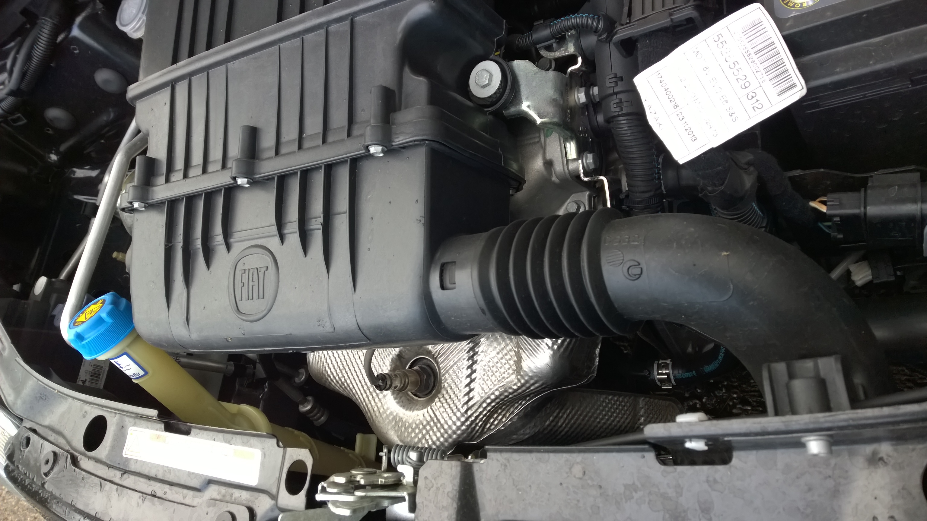

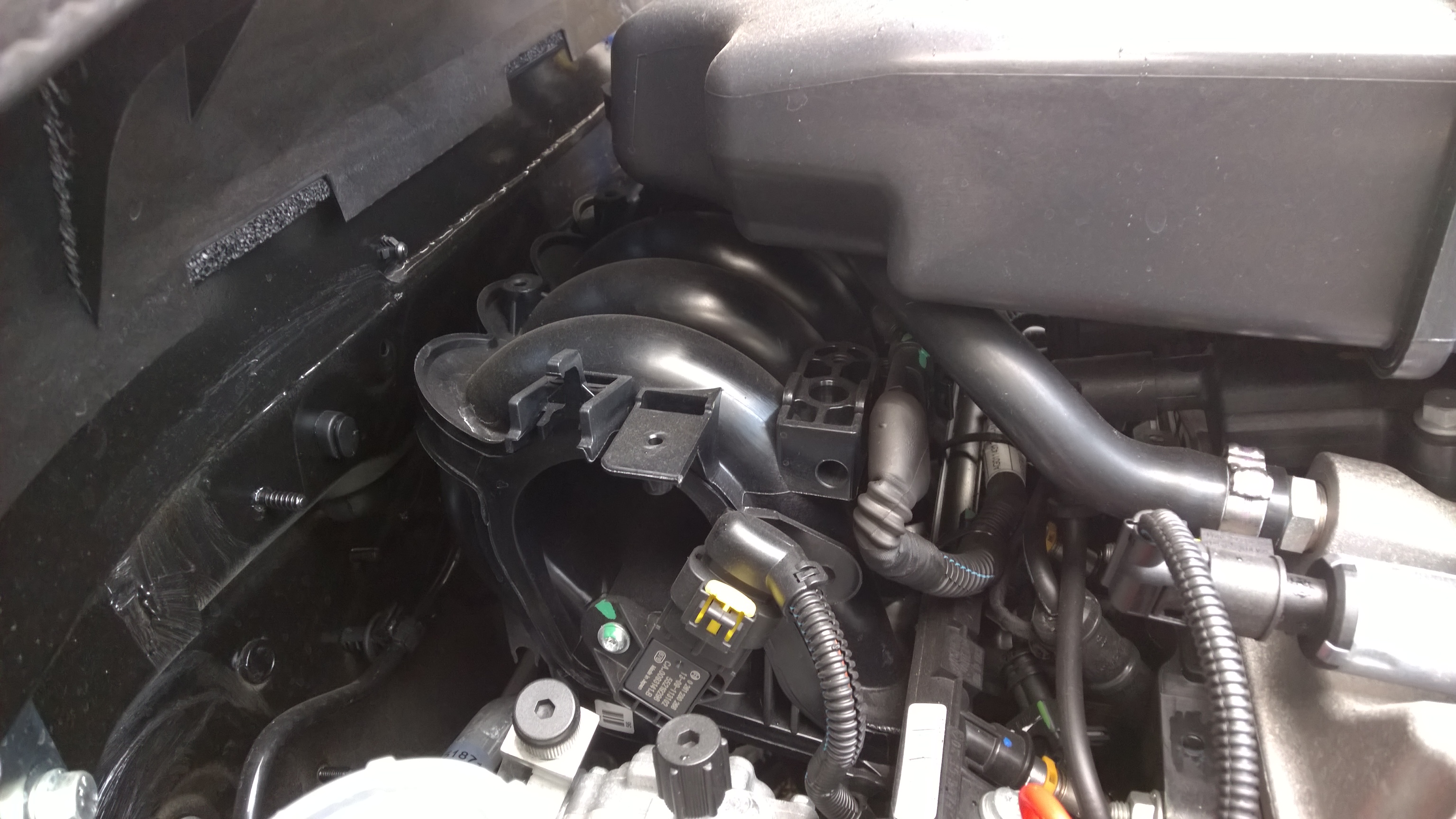

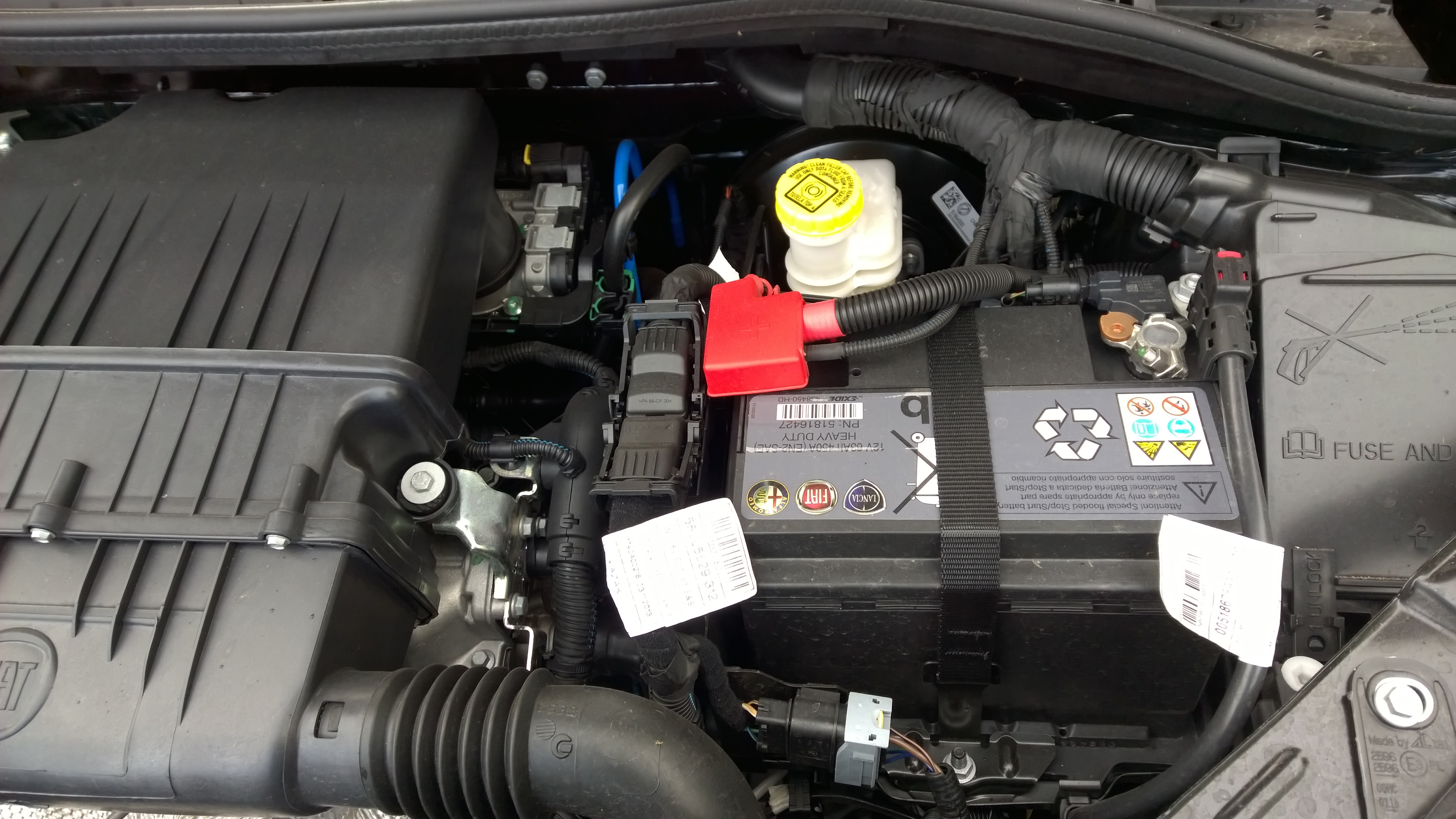

Re: Euro6 1.2 Throttle Response, Hill Start Issues & https://www.youtuWatchdog report
More photos.

If you still have access to it, can you please have a look up in the drivers footwell and see if you can find the supposed clutch position sensor - some photos of that area might be interesting.
We still need an unambiguous key physical feature that anyone can find to differentiate the Euro6 cars.
