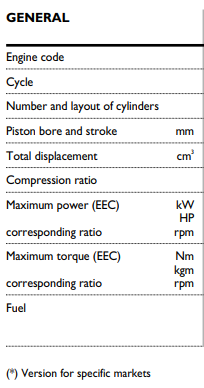

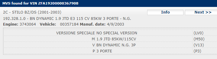

From ePER for your car and Stilo Handbook 2006. I don't have/can't fine a 2003/2004 Stilo Handbook so I suggest you check yours if you have one.
