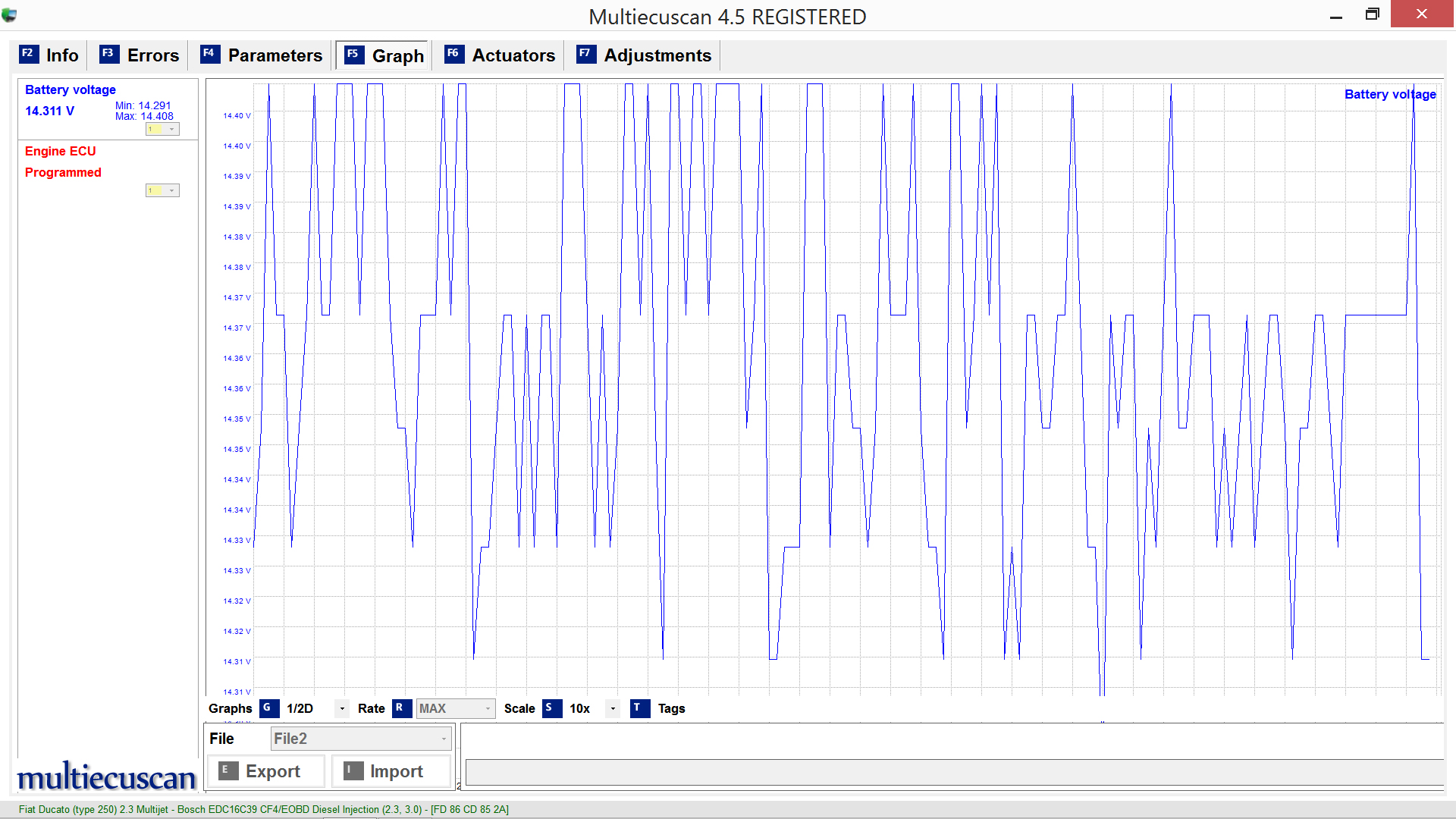

I have opened the node box, solder a wire inside where the damage pin is and cut one of the connect wire that was suppose go with broken pin, solder together now I can reading my Airbag section what the fault is. The new error code is B1004 is 'B' meaning body?, I have check my battery with no cracking is at 12.53 volts when start it go down to 12.36 volts for few seconds then rise up to 14.43 volts on engine runner. Battery knackered?

When the engine is running I have clear the error code the airbag light never come on my 12 miles of driving. It don't come on when turn the ignition on (without starter the engine) it only come on when first turn the cracking. My guts is tell me it need a new battery but the current battery it looks a new to me.
Just a thought as the fault code comes up when actually starting the engine: check/replace the earth cable between gearbox and body....this is a known fault on older vans and can cause sensor issues.
