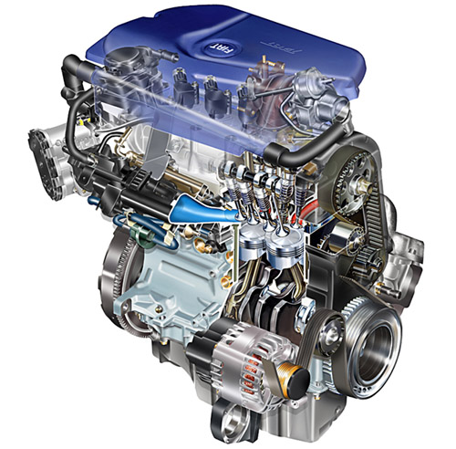

If you Google for images of the Tjet, you'll clearly see the injectors are upstream of the valves-
I don't know where some sites got their info from, although I did find a picture on Italiaspeed from 2006 showing an simulated image of a MultiAir engine with the injector appearing to be in-cylinder, but was clearly a diagram drawn by someone who hadn't physically seen the engine and made no engineering sense.
