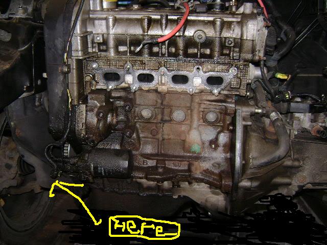

Am i right to think the the crank sensor is at the back of the block, so if im laying under the car its on the lefthand side???
