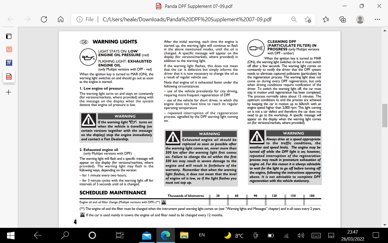

DPF shouldn't throw a flashing engine check light, according to diesel supplement for post 2009, although it wouldn't surprise me if some cars work differently.If this is a petrol engine, it might be indicating a misfire, problem with either ignition or injection, so the codes need to be read to determine the fault and diagnose the cause.
Same applies for diesel, unless it is a diesel with a diesel particulate filter (DPF), which has to regenerate frequently. When the DPF regenerates, there is often a warning light that flashes to indicate this operation. Is that what you saw?
Many cars will flash the DPF light during regeneration, hence my generalised reply. Just because the anyone reports an engine management light, does not mean that is what it is, as many people do not know what the various warnings are.DPF shouldn't throw a flashing engine check light, according to diesel supplement for post 2009, although it wouldn't surprise me if some cars work differently.
