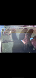

Screen shot of software attached if anyone else has same model/year car
