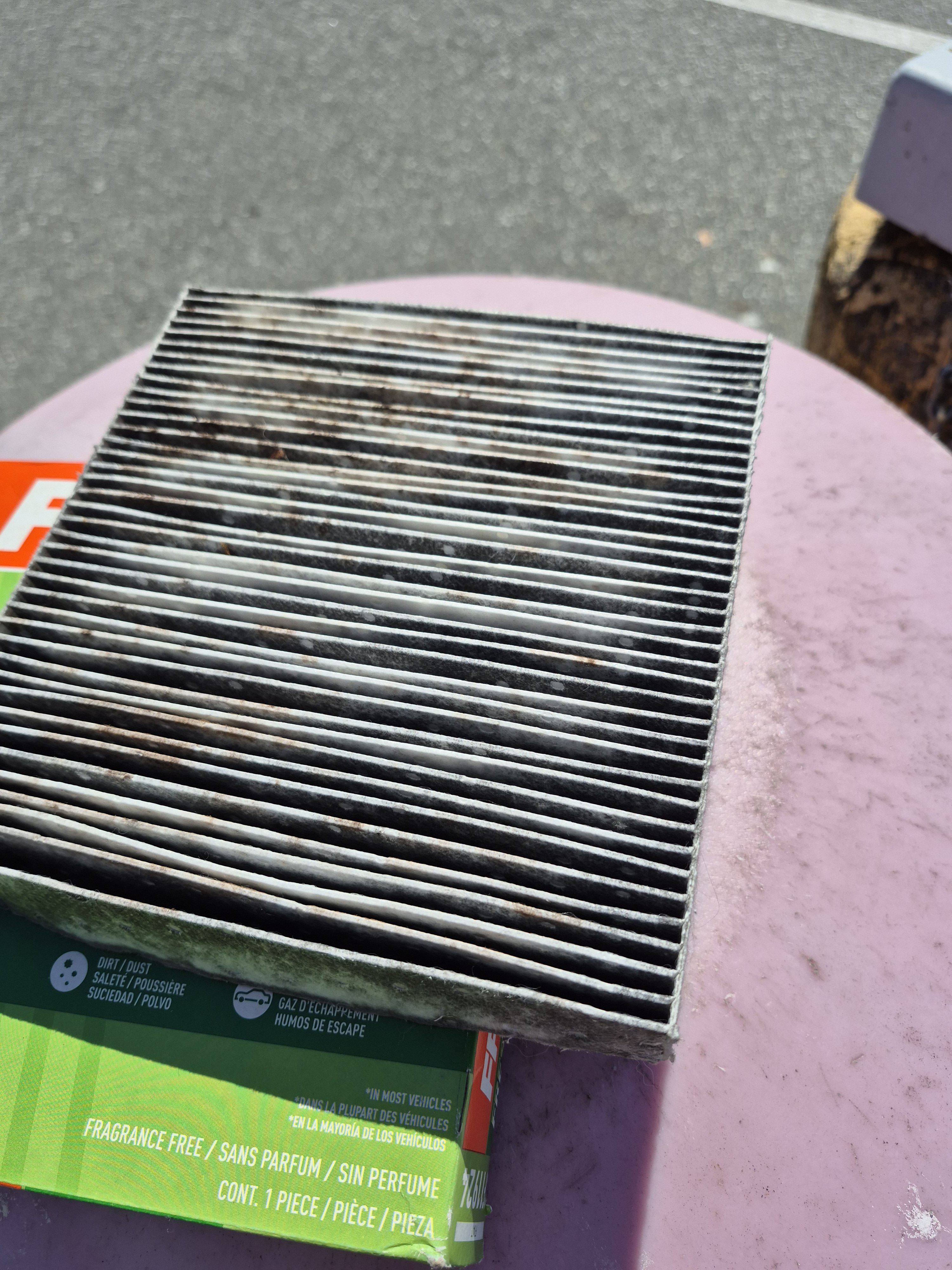

Thanks. I went crazy with servicing when I got the car (for my niece) as it didn’t have a service history, and had done 47k miles, so pretty sure the cabin filter has been done, but I’ll check.
i struggled however finally was successful in replacing the new filter. Not much difference but the weather is 32 celcius and cool air is coming out just not cold.
..... and cool air is coming out just not cold.
You will know if it's working, its very cold. There's no 'maybe' about it, you will definitely notice the difference.

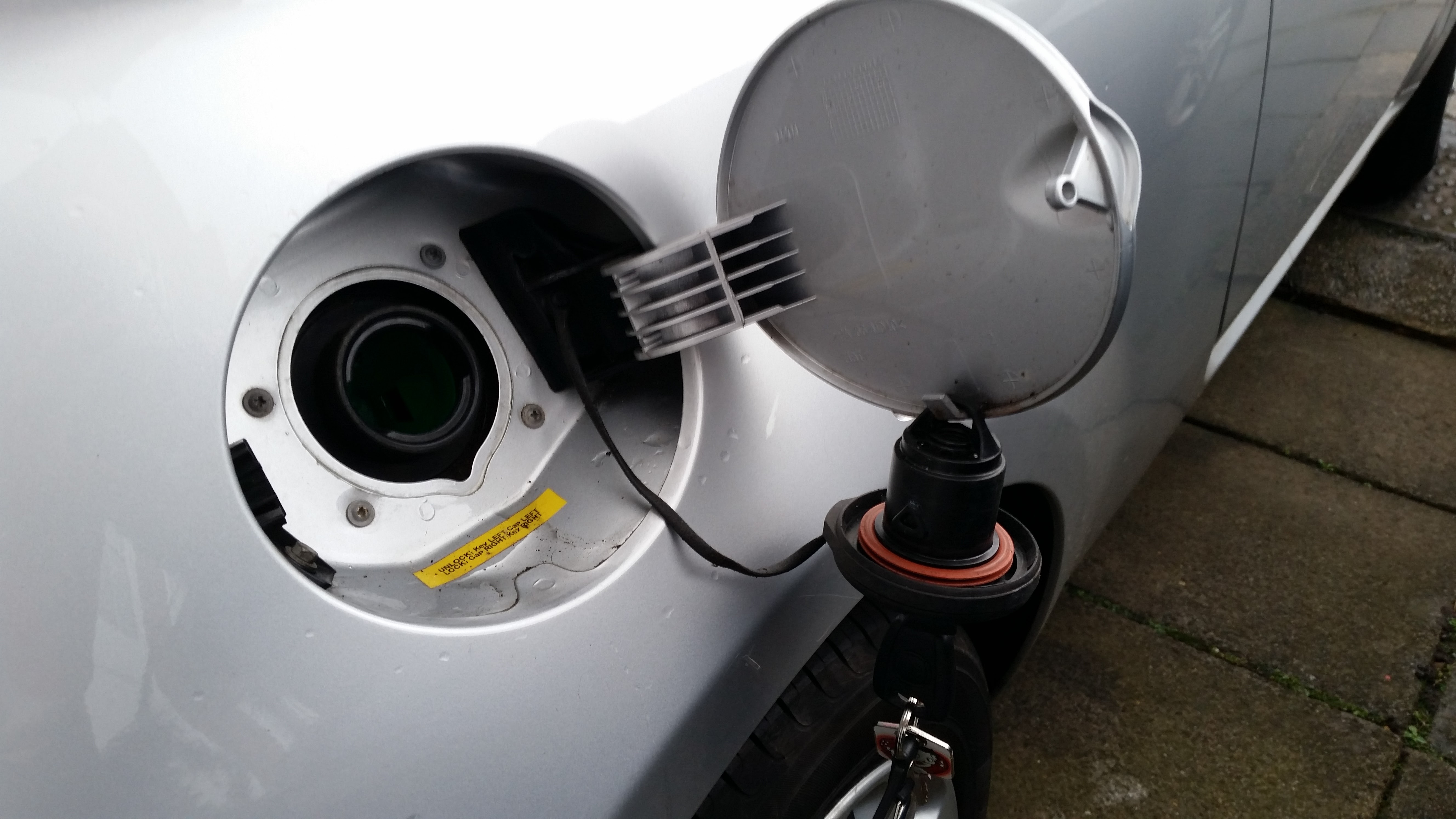

Now leave it on all the time, also here's another newbi picture that you may not know
