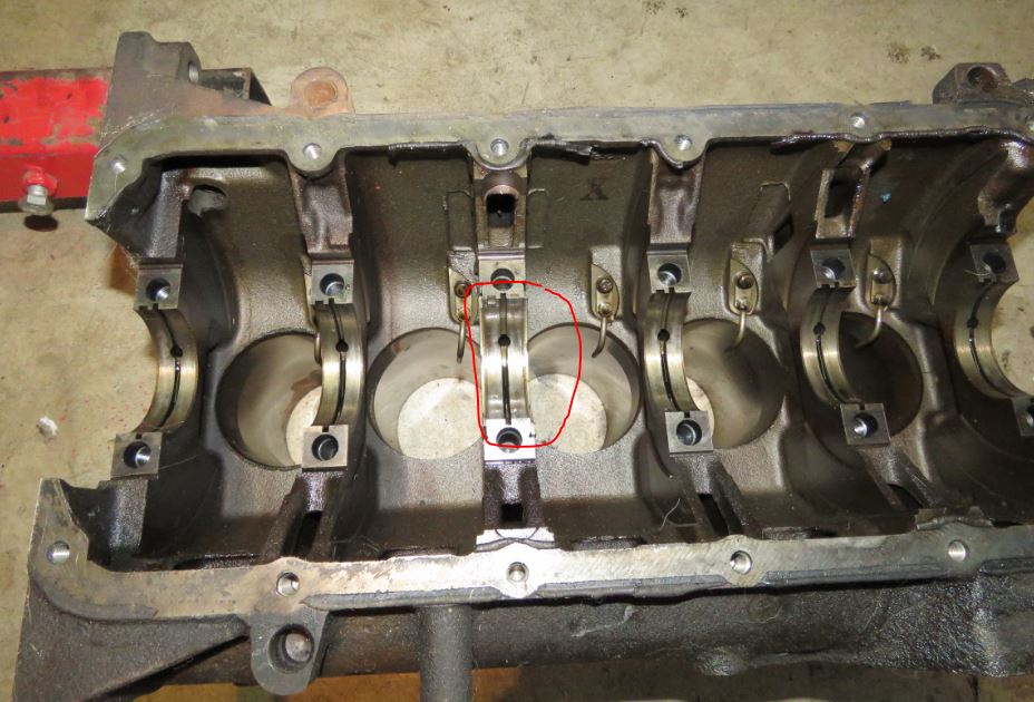

00H15 Enginebottom - Remove Bearing caps (Big end and Main).
Note! Record cap position and direction, thecaps is marked with stripes indicating which bearing starting from the Beltside. (See pictures)
00H05 Engine bottom - Remove crank shaft.
Note! While removing crank and bearings, takenote of positions.

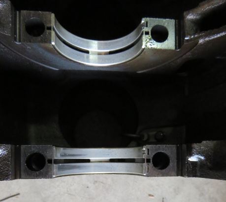

Note! Inspect crank shaft and bearing contactpoints for any excessive wear, if crank shaft is damaged on any bearing itmight require polishing and that bearing halves might be required to bethicker.
Although these should be measured for clearanceslater it can give an indication now of what major work might still be required.
Generally if maintenance were done frequentlythis should not be a problem.

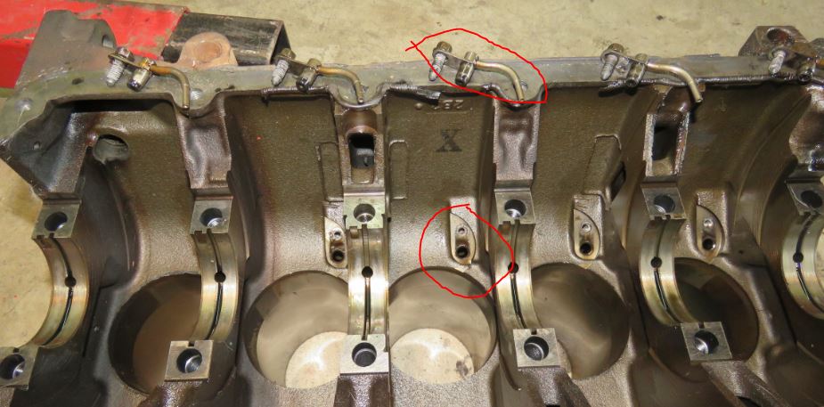

00H05 Engine bottom - Remove oil nozzles.
00H05 Engine bottom - Remove thrust bearings.

I am gladto see after 258 000km's bearings still look good.
No cracksin block, head or major components, so the foundation were designed very good,saying that it also tells of good warming up practices and services.
I drove this car hard, cornering, acceleration etc. but always kept the revs and acceleration low till on working temperatures.

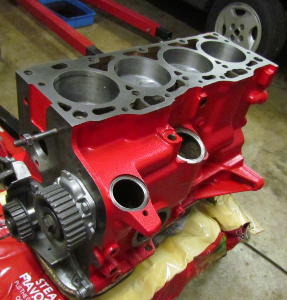

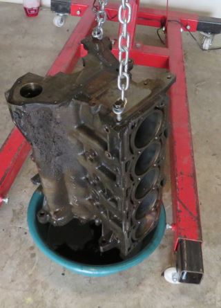

Clean engine block
04H00 Cleaned block, lots of work to remove old oil etc.
So now next step...
Do I just clean
  • or do I spray the same as I did my Uno Turbo engine after the engine rebuild at 350 000km.
The Stilo engine is covered mostly so you won't see much of the paint work.
Plus it won't fit in standard oven to bake the paint

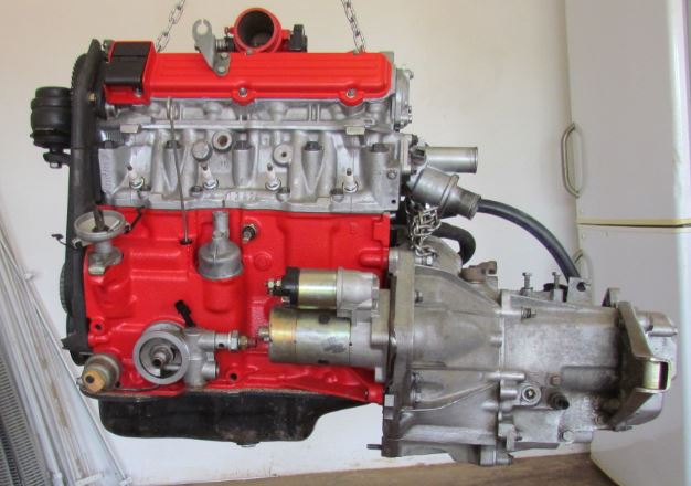

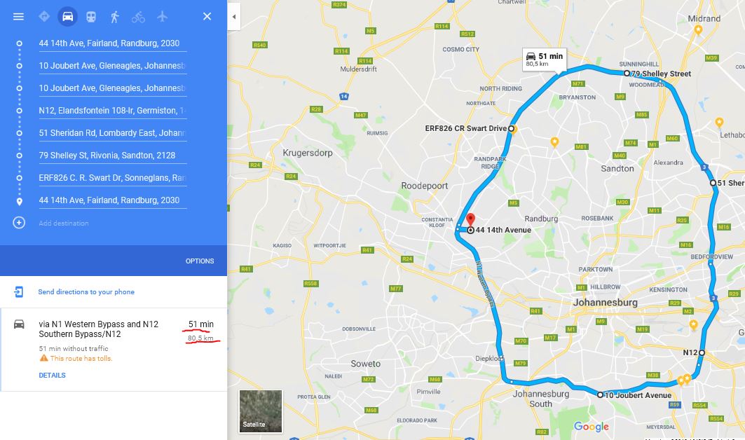

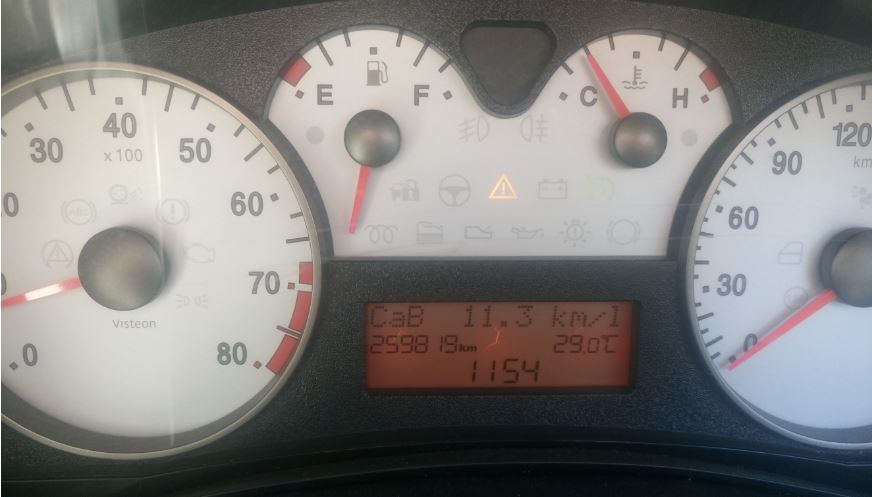

Eco Run :)
Not perfect conditions or controlled but more realistic day to day
Distance covered: 80.7 km
Speed control set: @139, true speed 130 km/hr (Speedo not very accurate)
Consumption: 11.3 km/l
Aircon: On
You will see I must still sort out a broken fuel gauge, coolant temp gauge and then have an alarm for ABS and Air bag.

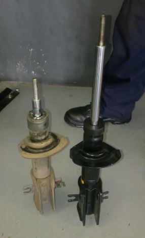

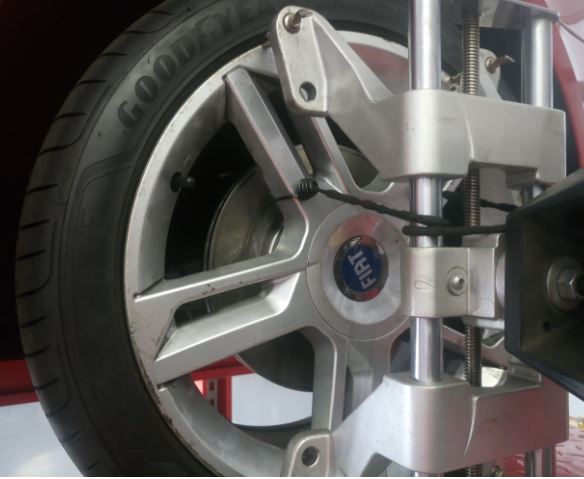

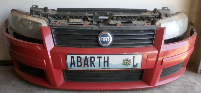

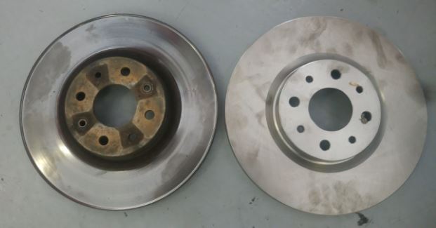

So after rebuilding the motor I also had to do some looooong outstanding maintenance on the front.
- Front Tyres
- Brake Disc's
- Shocks
- Lower Control Arms.
- LH CH boot rubbers.
So first time I changed the shocks
since I bought the car in 2008 ( 1 owner, bought on 24000 km)
Can't remember if the brake disc has ever been changed.

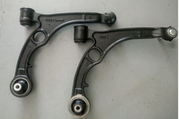

Also changed the lower control arms
, this was a challenge since I bought from a spares shop which shown in the book that the lower control arms important from Italy fits all Stilos, but on the Abarth the one hole is to small.
So I had to increase the size to 14mm.. (Note: I had an engineering company do this at slow speed not to overheat the metal, also clamping the steel bush not to stress the rubber.
On the old front tyres, you can see the wear on the one tyre, hence the front suspension maintenance.
I opted now for Good Year Eagle F1 sync 3. (Front)
I also recharged the air con, Note! the aircon never required refill and I am very impressed how good the Stilo Dual climate control works, compared to X2 and Si4

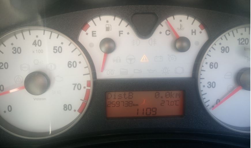

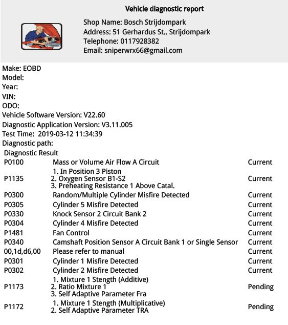

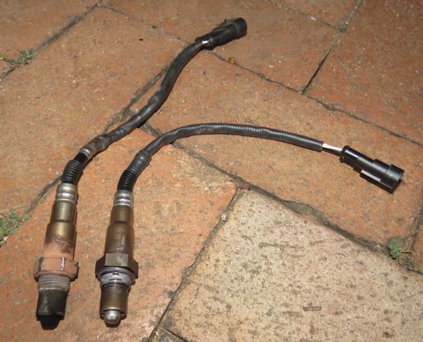

While under the running in period after the schocks, cv's etc where changed I had to look at all the ECU faults.
So I took the car to a BOSCH dealer whom also have a dyno for later use:D
Below you can see the Christmas Tree :)eek: ECU errors)

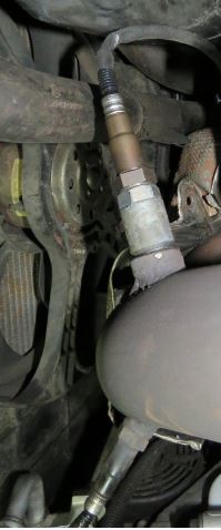

The Bosch snr. technician advised to:
1. Clean MAF sensor
2. New cam sensor
3. New Lambda sensor for nr.2
4. New Knock sensor nr.2
5. Piston 5 ignition coil??
I analyzed the results vs his advise and since all ignition coils and cam speed sensor were giving alarm, I read somewhere on google how a faulty knock sensor will let your ecu advance and retard the timing to try to eliminate the "knock", hence all ignition coils and cam sensor alarms.
So I decided to only:
1. Clean MAF sensor and connections with electrical cleaner (Note I removed the sensor using pliers to "unscrew the 2 odd bolts")
2. Replace Knock sensor 2 (piston 5), was a liitle tricky , had to do it from the bottom.
NB! The knock sensors must only ne tightened to about 3Nm, extremely lightly, just lock it, if you turn to hard you are going to damage the sensor (maybe I did this is why it were broken)
3. Replace Lambda sensor 2 (after catalytic convertor, well after my mini cat)
I also bought a ECU OBD 2 Bluetooth dongle to test myself before going back to Bosch.
After all 3 items done on my list all faults cleared, engine light cleared it self next morning when I started the car, and I could fell an immediate boost in power like seriously much better, took a test drive and stopped by Bosch to check ECU again, all faults cleared

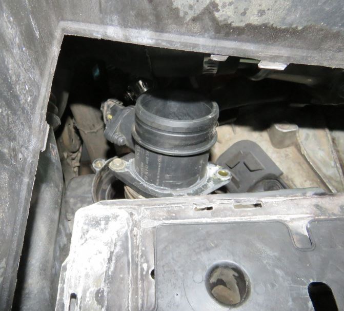

The MAF sensor I still doubt if it were to dirty, Fiat don't use the thin oscillating wires but a temp diode which is much more durable.
To remove the MAF was quite simple:
1. REMOVED the engine and battery covers.
2. REMOVED battery
3. LIFTED the battery plastic cage on the LH front.
4. LOOSENED the clamp.
5. UNSCREW the 2 bolts on the MAF.
6. TWISTED 45% anticlockwise to remove plug.
When I started I thought I would have to remove the whole air box again, luckily not.
