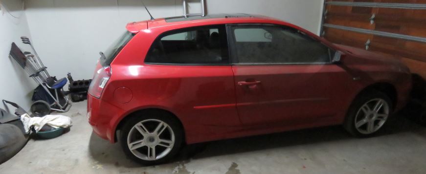

So I though it might be good idea to record times, then this can be used as a guide for someone in the future, obviously some bolts come out easily and some don't etc.
8 Feb 2015
1. 00h02 Removed engine cover
2. 00h02 Removed battery cover
3. 00h02 Removed battery
4. 00h02 Moved fuse box and cables safely out of the way
5. 00h04 Removed battery holder/foot bracket (nr 13 socket)/drip tray
6. 00h15 Removed Air filter box and pipe's (2x metal clamps, 1x air flow meter plug)
7. 01h00 Removed exhaust, from 5 to 1 flange to flange before 1st silencer box (lost time due to long bolts used by shop during decat, grime & dust lie on thread causing it to seize)
Tip: use short bolts and lubricate with copper compound
