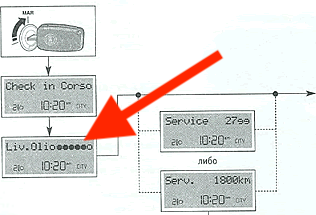

Hello, everyone.
Please tell me, the oil level in the engine at the first start is displayed on the on-Board computer screen only in JTD? (pic attach)
I have a Stilo 1.2 engine, can I programmatically adjust the oil level readings when the key is in the MAR position and the auto self-diagnosis occurs. More precisely, as in diesel engines? Perhaps it is configured in Multiecuscan?
Thanks!

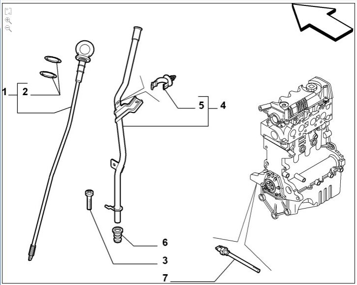

To display oil level, the engine needs an oil level sensor.
Only the JTD engines are fitted with the oil level sensor (Item 7 in the diagram below), so you can't display oil level on any of the petrol engines.

Understand, thanks a lot!
Just for information, the oil level sensor is a hot wire type. This works by passing a current through a thin resistance wire, enough to heat it up. The alloy the wire is made from is designed to have a large change of resistance with temperature. If wire is in oil it conducts the heat away faster than air so the resistance change when high current is flowing is greater in air. If the wire is half immersed the resistance change is half. There is some more electronics involved to compensate for temperature. This sytem only really works well with cold oil which is why it only shows the level at ignition on.
