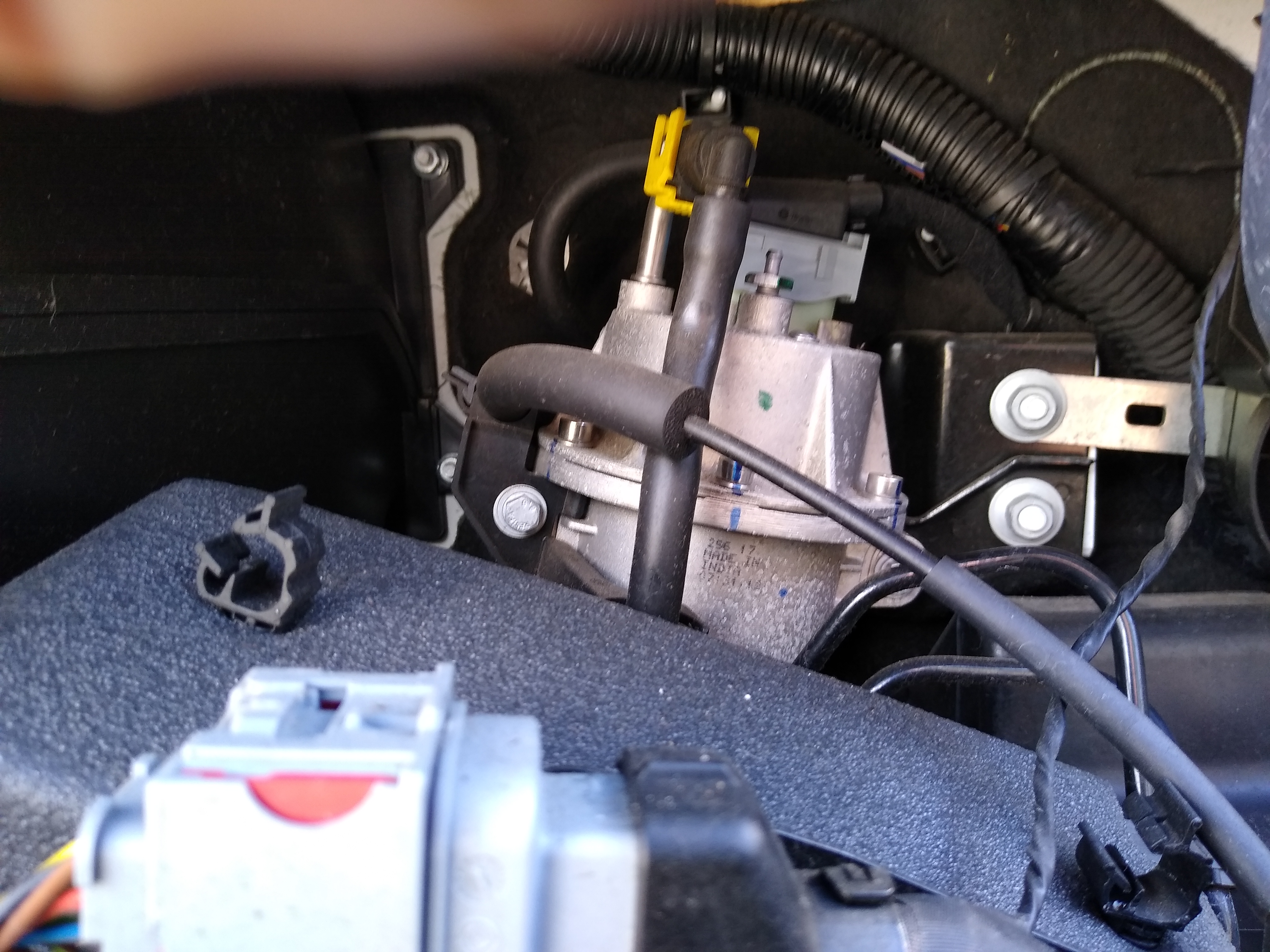

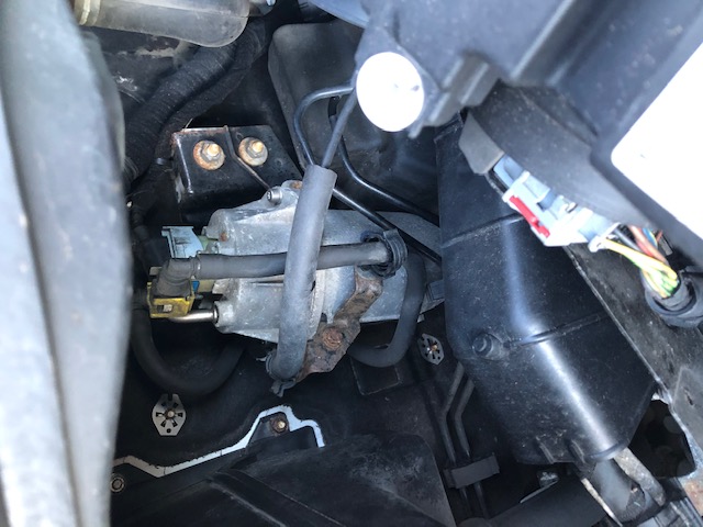

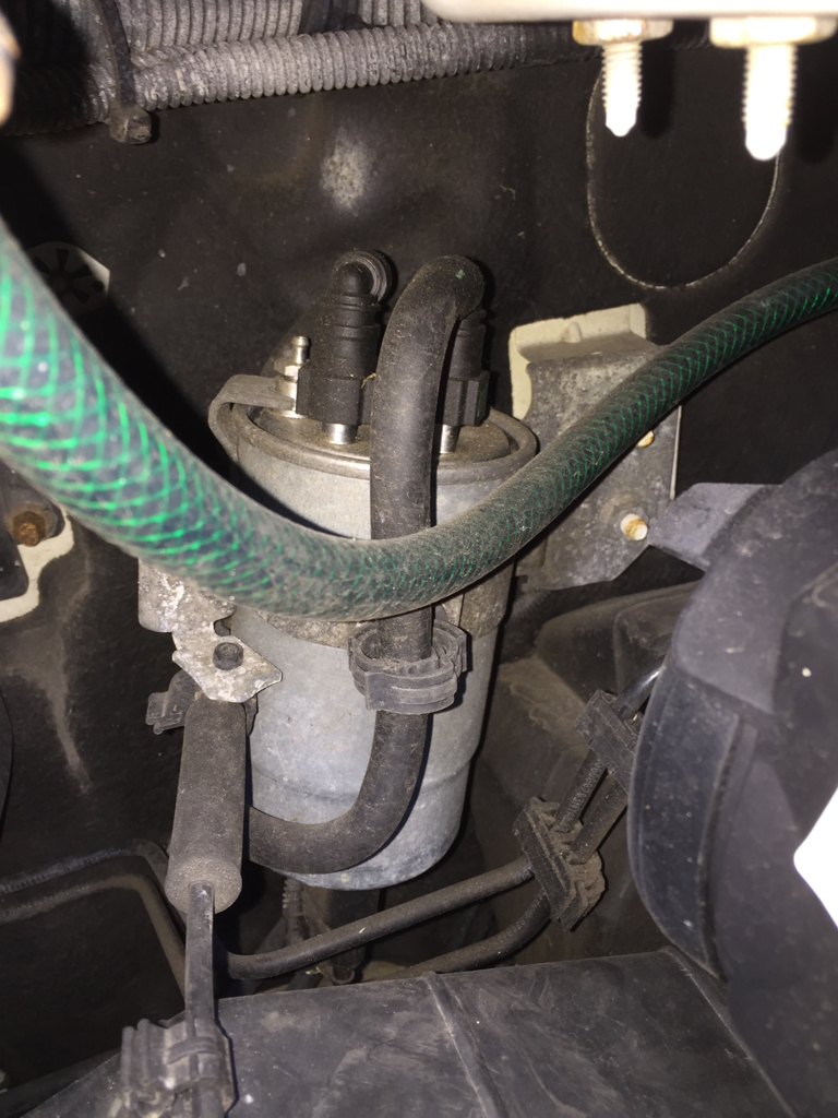

One way of knowing is the type of fuel filter that is fitted. If it is a complete canister replacement it is euro5, if it is a metal canister with replacement element it is euro6.
I also think that a euro6 has a letter in 12th position of the VIN whilst the euro5 is a number.
euro 5 then:)
misread you reply. doh. will try again
12th character is a D also
