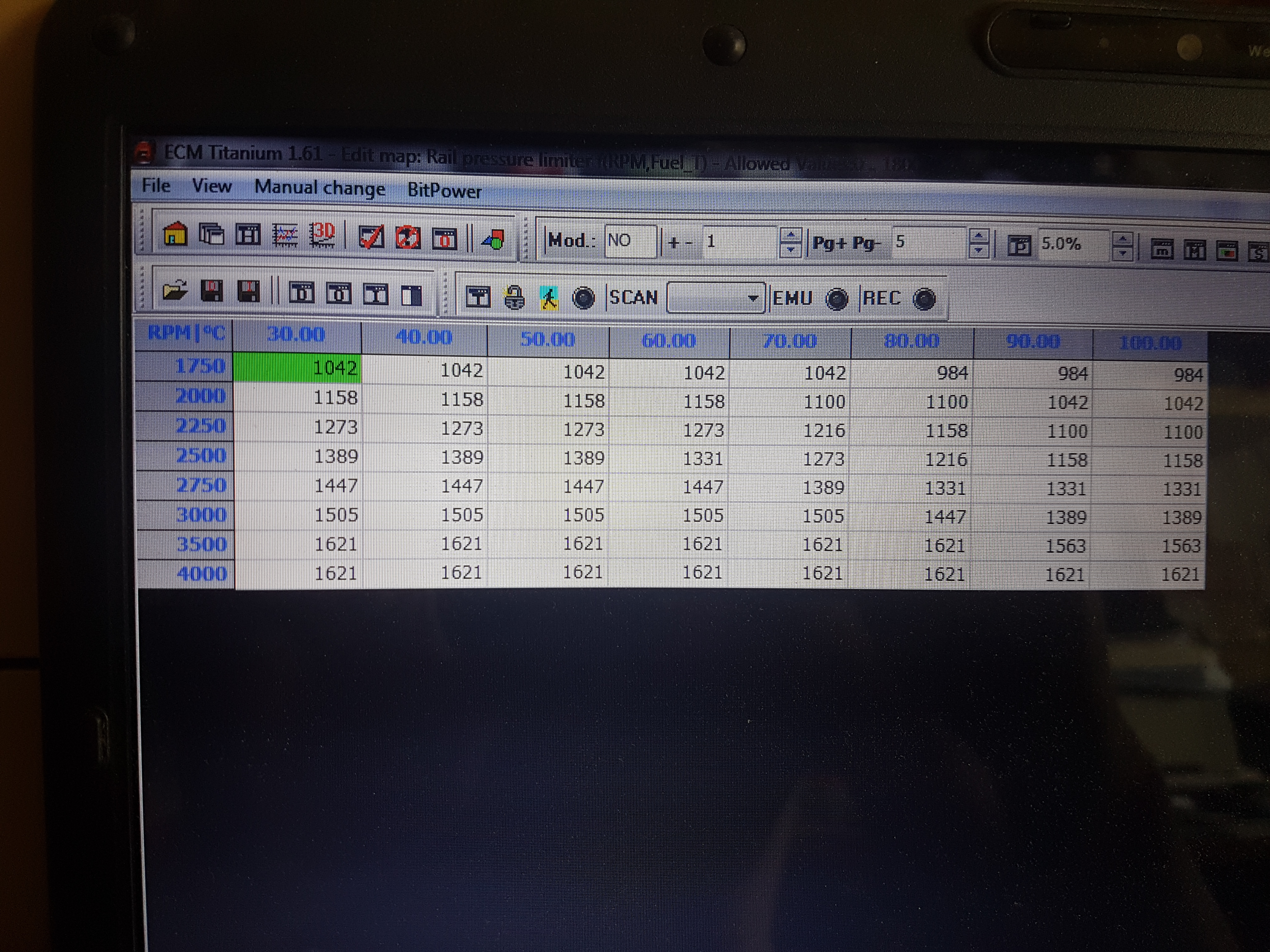

Hi all, newbie on here so sorry if it's already been answered, my doblo has had it mil light on since I've had it with no adverse problems but its now time for an upgrade so I wanted to get it fixed for the new owner, the code is P0180 , can't find a fuel temp sensor anywhere, its has a canister type fuel filter with push fittings and a water sensor with 5 wires in it. Doblo cargo 1.9 2007.
Thanks
Just clear the code and drive. I was driving with that code on and off for months with no issue until I loaded a custom tune and used a dtc remover to permanently delete that code. The only perimeter that fuel temp sensor alters is the fuel rail pressure limit which does not change much if any as you drive. The picture attached show you the perimeter and the one and only table that the fuel temp plays a role in and i can tell you you need not worry about this check engine light fault code.
