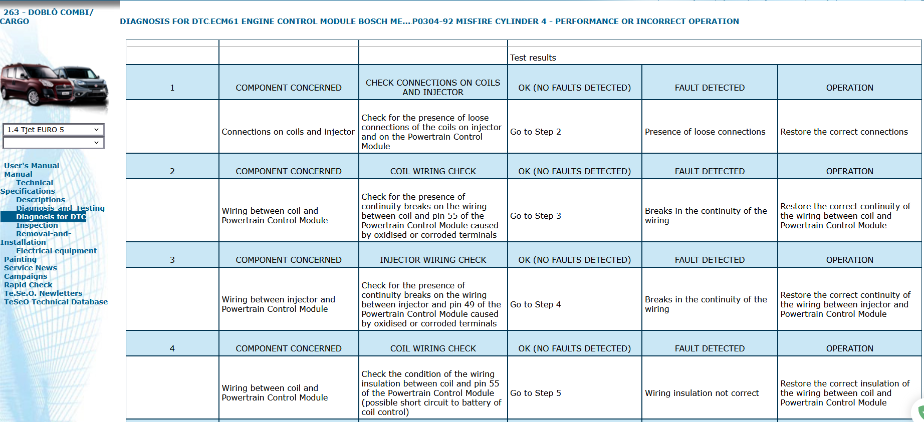

Hello ladies and gents,
Could someone help me with a suggestion please ? Its a fiat doblo 2018 , 1.4 t jet . Sometimes I get misfires and also I get very weird cold starts ( shaking for the first 5 , 6 seconds, the engine wants to stall) . Many thanks.
