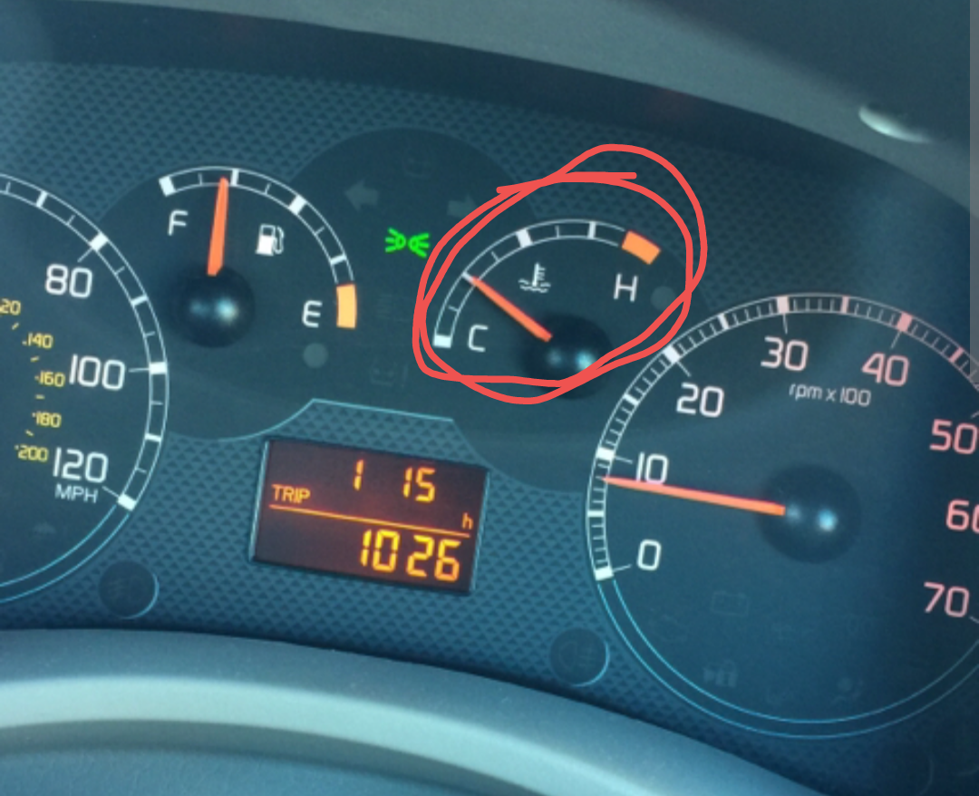

Does the ECT engine coolant temperature reading right
Is the dial correct on the dash

Is this gauge registering C at ignition on, is it quickly and smoothly climbing to the midway and staying there, No jumping around
Ah! I get what you mean now. Yes it starts at C and after about five minutes driving it now goes up to the halfway mark and stays there. Heater works fine, both recirculating and drawing from the engine. It did take me a while to get the thermostat and get it fitted. Could driving it with the faulty thermostat have caused another issue down the line?
