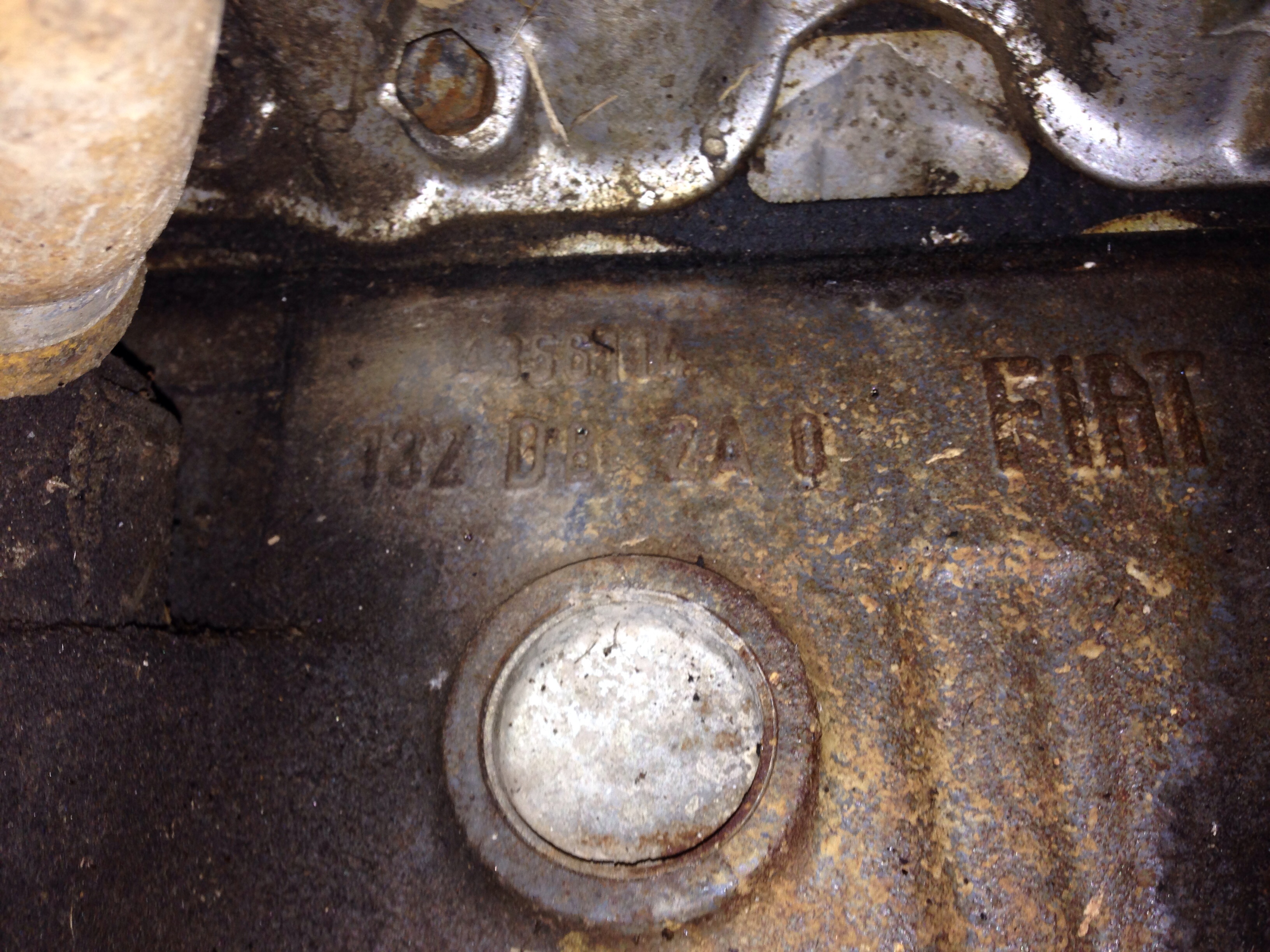

Hi guys, I'm pretty new to fiats just looking for some help identifying an engine. I can't seem find the engine numbers on any of the list I've found online, numbers are as follows 132 C2 023 this is what's stamped on the square part near the oil filter

It's a petrol 4 cylinder twin cam alloy head on cast block. Oil filter is at the front on the inlet side of the engine.
Attached is a photo of the cast numbers under the intake manifold
And the stamped numbers near the oil filter.

Can you stand a little further back with camera and get the engine in shot? From those angles I'd hazard a guess that you have a 1600 eight valve from a 128, 130 or 131.
The second photo is the engine number so you should be able to check online. ;)

Have you tried Googling the cast number on the block?- 132 DB 2A0
They mention that casting number in the thread below, plus the engine number beginning with "132 C2"-
http://131mirafiori.com/smf/index.php?topic=3293.15
http://www.netikka.net/ville.vieri/tc/tclist.htm (From the thread above)
Hope that helps. (y)
Classic Fiat Twincam 4cyl. as fitted from the 60's through the 90's. 70's and 80's were most common. Looks like a 2L (1995cc) as fitted to later cars like 131, 132, Croma, Argenta, Spider 2000, Azzurra, Spidereuropa, Fiat Coupe, etc, as well as other models produced under license elsewhere in the world. Great engines, thus the long production run.
This pre-dates the Fire engines and much of the 90's. Likely a 8v model before 16v was added to the block. Could have come with carb, or FI. They were never fitted to the 128 (even tho they were in Ritmo Abarth ala Lancia Beta and Delta). Not sure about 130, where the V6 would have been common.
