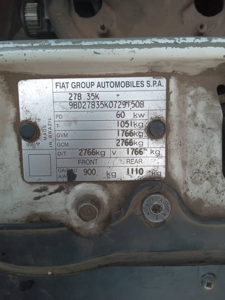

I'm having a hard time to replace my 1.4 fire engine for a 2007 Fiat strada working.Are there any other Fiat models that have an engine that can fit in a strada 1.4

Looks like the european Palio / Palio Weekend / Siena / Albea. They all had the 1.4 engine, but no idea if it was the same.
Fire 1.4 as far as I remember where installed in the Uno, so probably also the 1st gen Punto.
The question is what was imported to Zimbabwe and from where (European / SouthAmerican factories).
Looking to replace my faulty engine a 1.4 engine number : 178F503896411504. Does the 1.2 16 valve Fiat PALIO /PUNTO engine 188A5000 fit on a my 2007 strada working
the working?
It should work with the 1.2 palio/strada engine.
