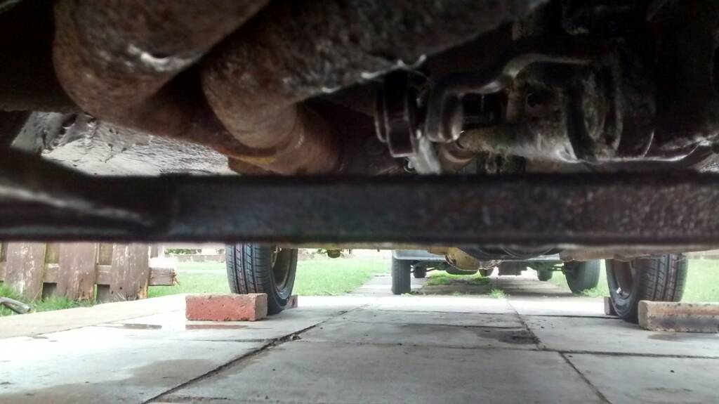

I'm hoping with a bit more height I should be able to apply more strength to it, I'm 26 and 16.5 stone, I feel like I really shouldn't be struggling with it as much as I am!
I've just done it! Had to use another long clamp to get the exhaust away from the joint. Then used a huge set of pipe grips to crush the two together. took for or five attempts and was really hard whilst laying on my back under the car.
I have to thank you mate, you gave me the motivation to ramp up the front of my car this evening, and with the increased height and a small block of wood to lever with, I managed to get the bush on! Thanks man! A good weekend all round then :)
Gears are selecting perfectly, its like a brand new gear selection like out a new car!
The photos make it look like its loose or something, its only because I didn't have the other end of the rod connected when I took the photo :)
I need to get a new bushing for the gearstick end now. any idea where i can get one?
