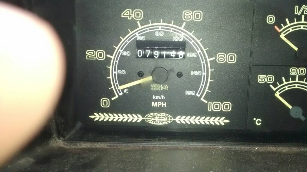

How fast have you driven the car, if only slow speed it may not show on the speedo. Jack the front wheels up and run it in gear if you are not able to drive it above 10mph.
Its funny you should say that, I had a message from the previous owner today. She just remembered that it seems to wake up at higher speeds (on the motorway was the example she used) but not sure about recreating motorway speeds on axle stands to find out?

Wow thanks for the show of support guys, I will let you know by the end of the day, I am going to test today by running the cable on a drill to see if the clocks move, and then driving the car with the bonnet open to see if my wife can see the cable turning internally. That should let me know which end the fault is at?
Presuming it is the gearbox end I would love an explanation of how to fix if you could kindly oblige?
Right so done some testing, let me know thoughts guys?
I couldn't get my drill into the opening for the gearbox end of the cable, so I turned it with pliers, I wasn't expecting much reaction from the needle, but asked my wife to look for any reaction, she reported the needle wiggled slightly under turning. So that told me that (albeit I can't yet completely say the dial is fine for reasons I will explain now) the gearbox end must be the source of the problem. I then took it off at that end and reinstalled it trying to feel for the cable entering properly in case the problem had been my installation in the first place. I then cleared my driveway and tried to test it under more speed. (I have a longish driveway) in reverse on the first run the needle didn't register anything, on going forward at more speed however it went up to the shown speed in the photo... And then stayed there. I then took it in reverse again, at which point it reset to absolute zero, and going forward again produced the same results.
Any ideas before I do more testing with the car up on axle stands?
if your speedo ever does that annoying "waving" when you go at a set speed stick some "food lube chain spray" on it.. makes the needle run really smooth and its food grade! :D
The parade does that. the needle seems smooth on this one so far though, though does seem to get stuck. I will lubricate it and hopefully job should be a good one :)
Took the Sisley a run down to the bottom of the street and back, (I live on a closed road officer) and while I didn't get out of second gear the speedo seemed to react accordingly, also it doesn't work in reverse, but neither does the parade, didn't know that. So all in all I would say from testing that it is working. Happy days.

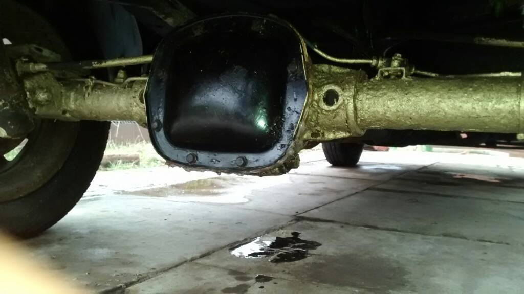

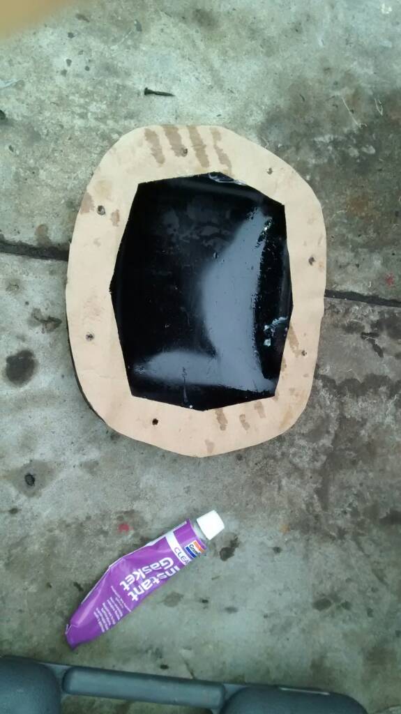

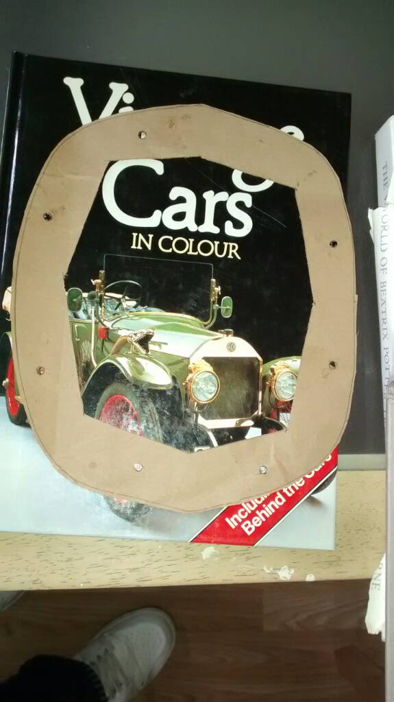

Took off the rear diff cover today, made a brown paper gasket and refitted as it was leaking from the bottom side before. I am leaving it overnight to cure, it's supposed to be instant but I reckon I did it too quickly before. Hopefully it will be oiltight tomorrow.

Diff is filled with oil and doesn't appear to be leaking with the new gasket in place, hopefully a success then.

Make sure rear axle air vent is clear from any dirt / gunk.
attachment.php
It is semi-sferical cap on the top of axle case - passenger side, cap should be free around the air vent nipple but still attached to it.
If it's solid, some pressure might build up internally damaging shaft seals or diff cover gasket.

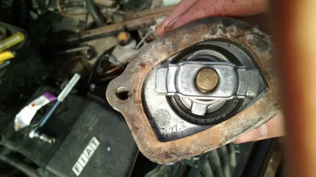

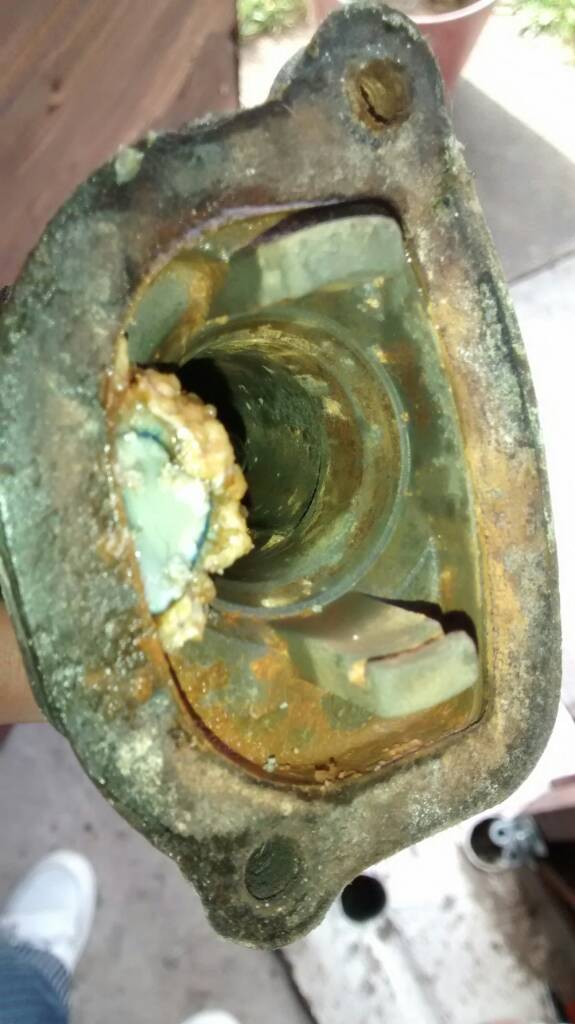

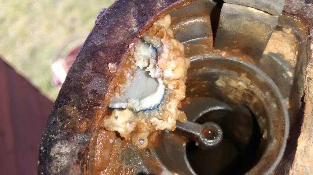

Today I changed the radiator, which in and of itself was extremely easy, what made it take me a relatively long time was that the three jubilee clips I needed to remove were so rusty it was unbelievable. But it managed :) I also inspected, and ultimately changed the thermostat for one my dad had given me (its great that he still has loads of old parts from when he had these cars new!) Because of buildup of deposits, and the fact that the old thermostat had been removed from inside the housing, I couldn't believe it when i saw it, prepare for the photos to be particularly disgusting by the way!
I have a water pump to fit too, but didn't get that done today, I expect to be able to do it quite quickly next weekend.
As always I will post the video update for those interested once I have finished uploading it.
