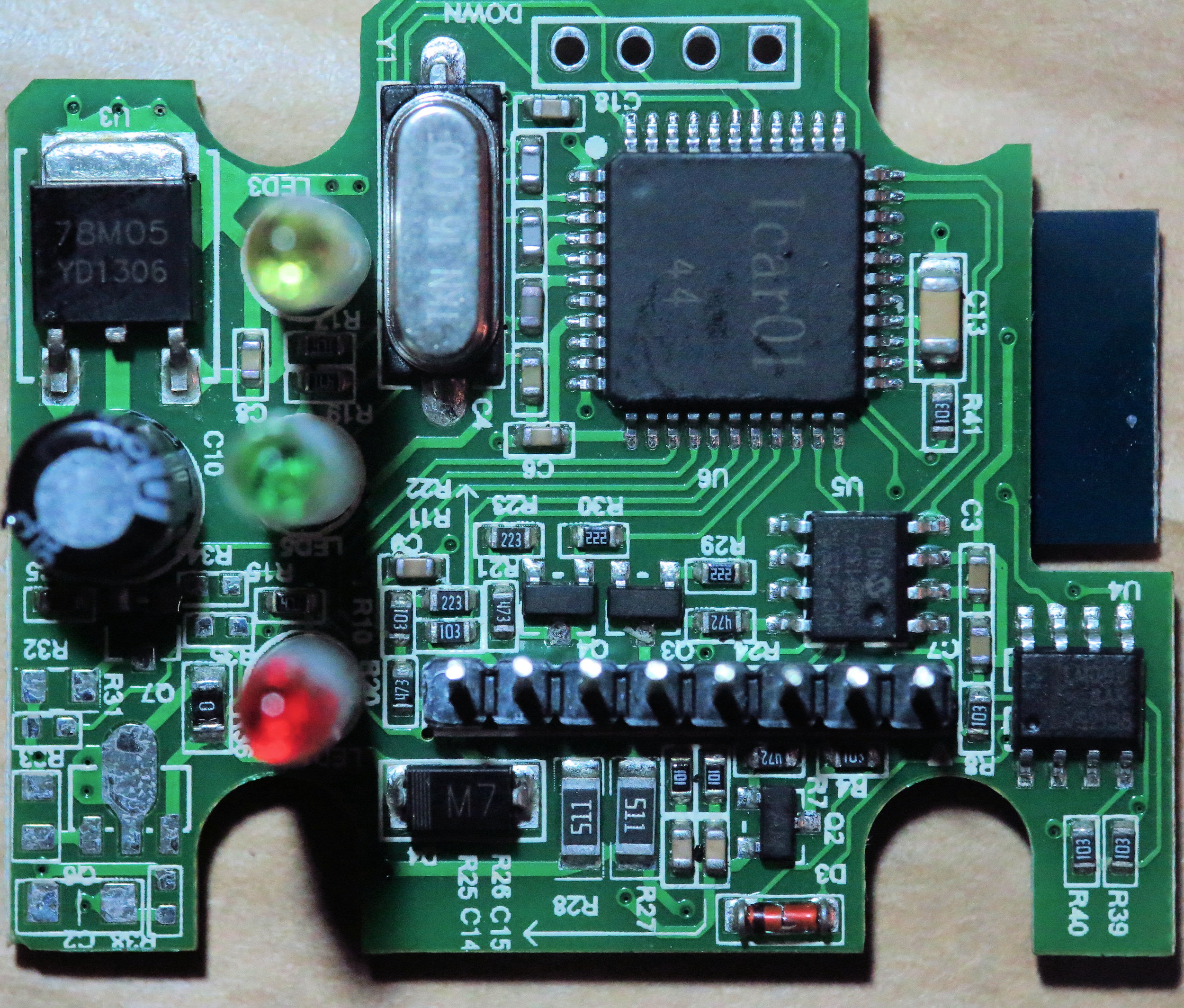

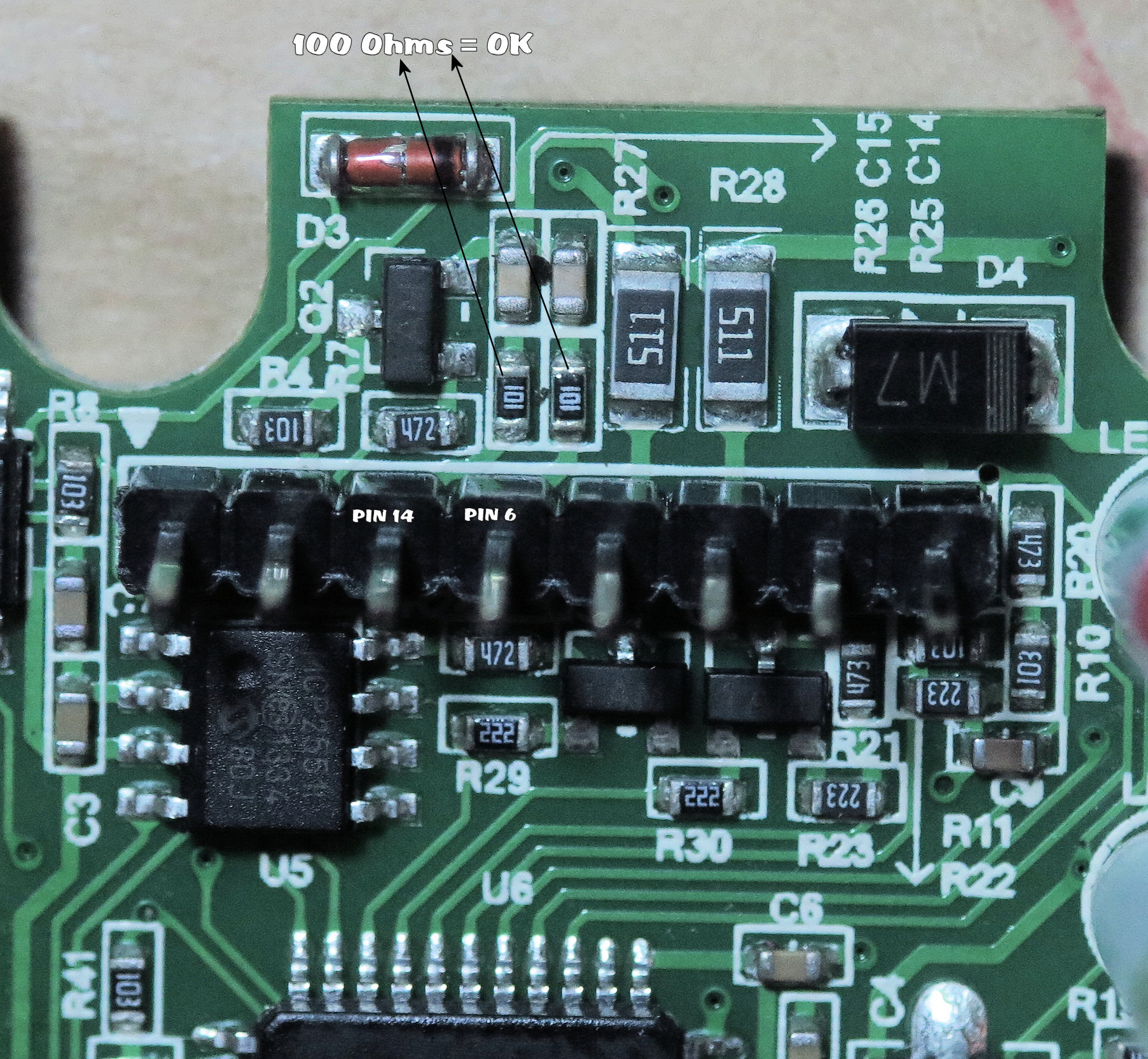

Damn it: my resistors are 100Ohms as should be... however I realized that post is 117pages! I have to dig my answer very hard!
(n)

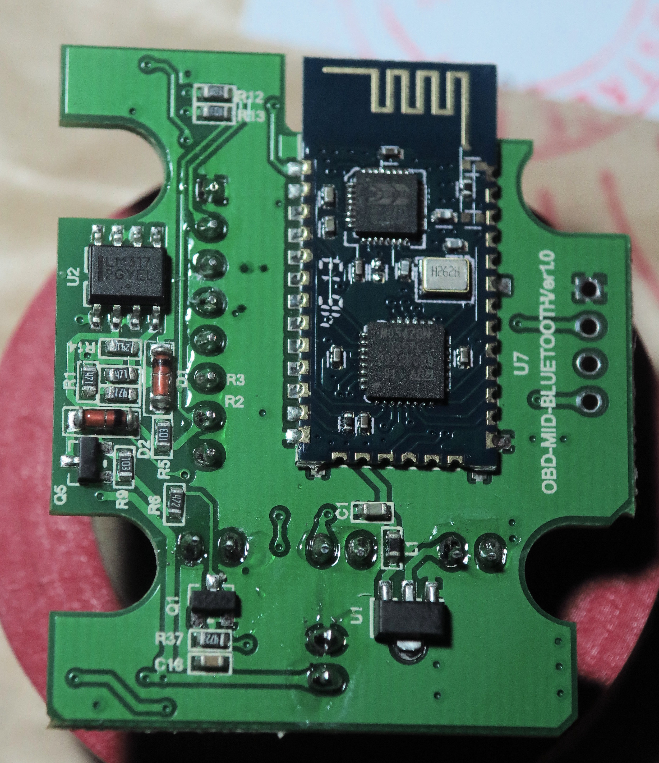

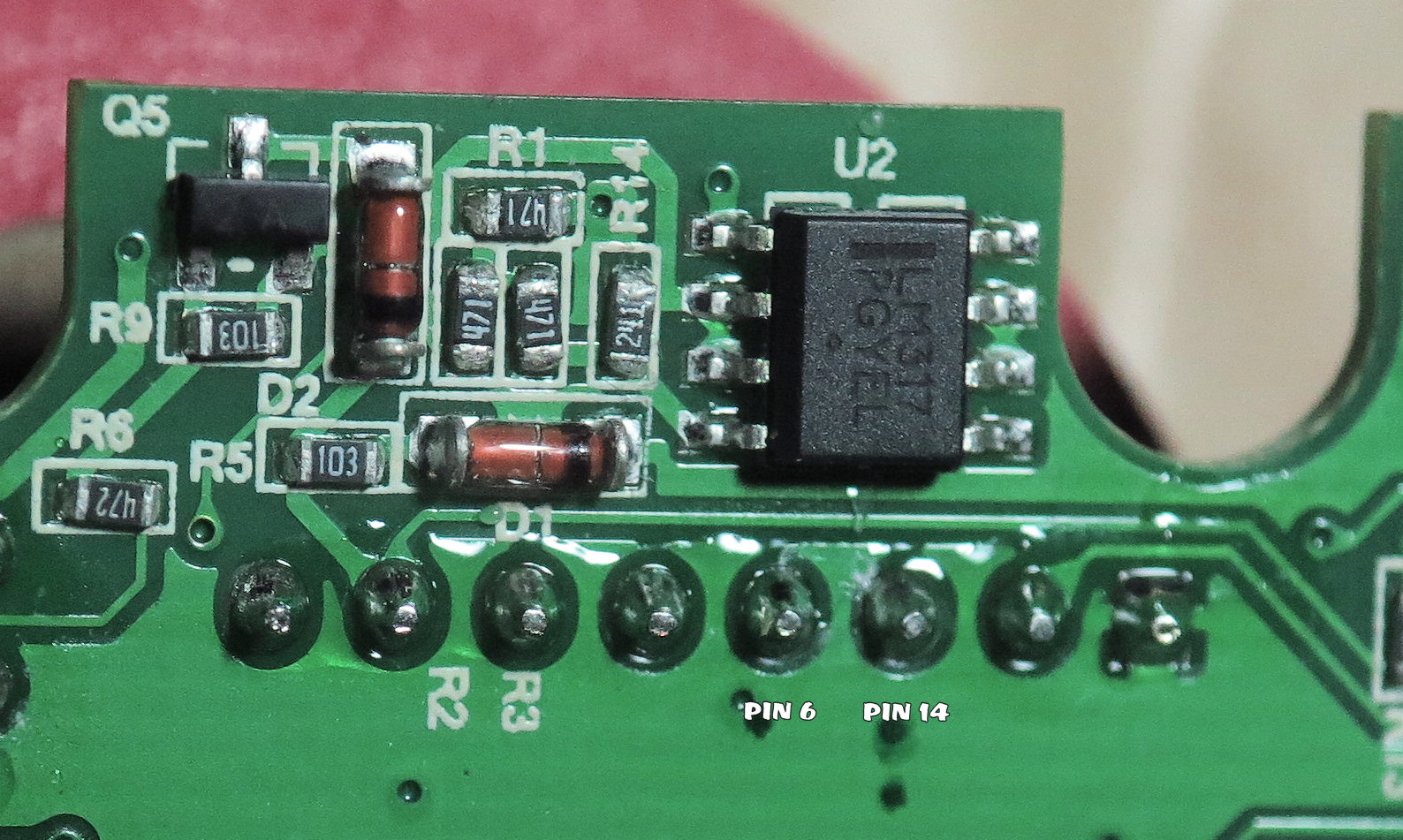

I found mine had the correct value resistor but instead of being connected to ground two of the pins where commoned together with the resistor allowing the output to float so I simply removed the resistor and all was well
Here is my Interface. I am a bit skeptical to remove the risistors and will eave that as a last resort
