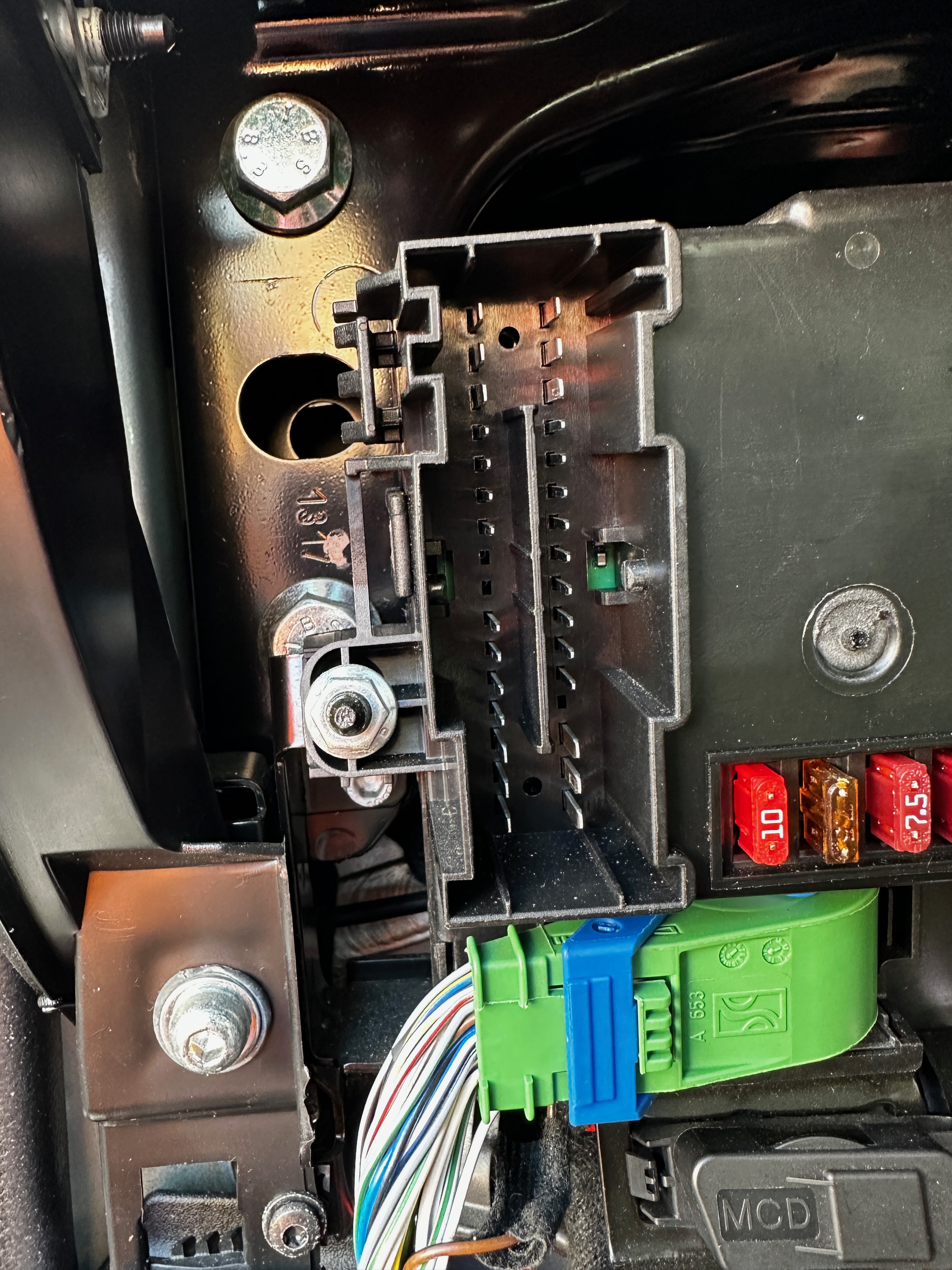

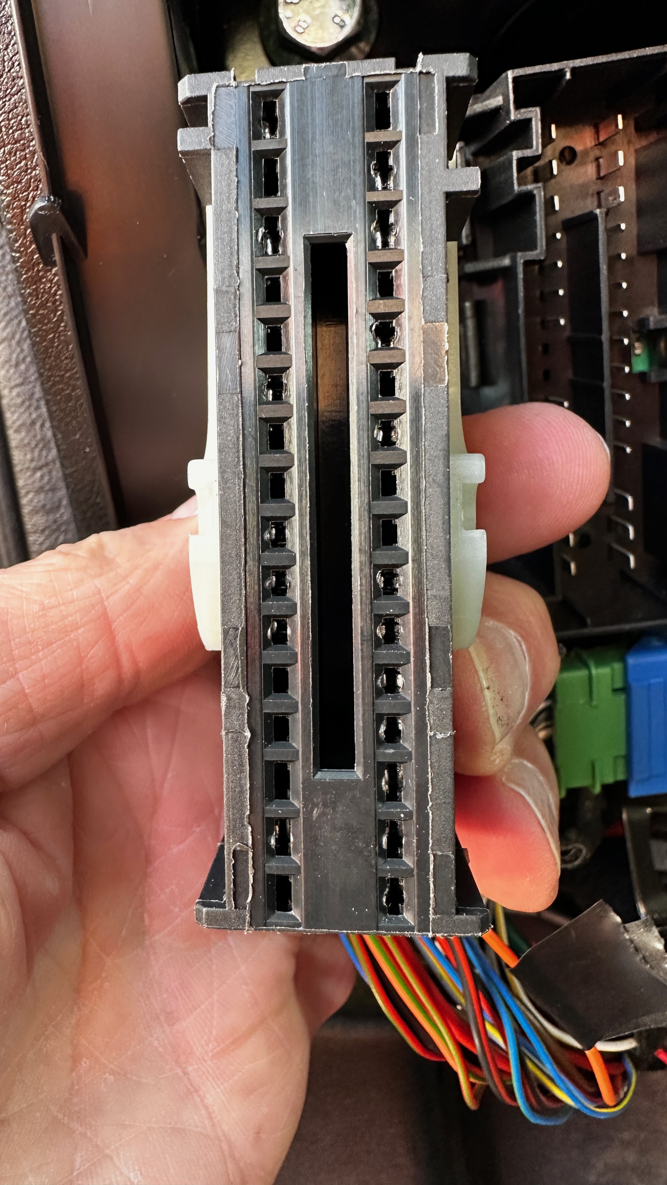

Hello All, I have a weird electrical problem with my Fiat Ducato. When I turn off the engine and take the key out of the contact lock the dash board remains on. I can only switch it off by taking the mass from the battery or pull the large connector from the BSI1 fuse box in the cabin (see pictures). Has anyone encountered this before or has any idea where the problem may be?
Your support will be highly appreciated, thank you
Best regards.

Unlikely to be this, but several years ago I had an Iveco Daily I bought second hand that had tracking and after market alarm removed, it did as you described and eventually I found the cause was an extra wire feed had been connected to the brake pedal switch.

Thank you very much, I will have a look!
