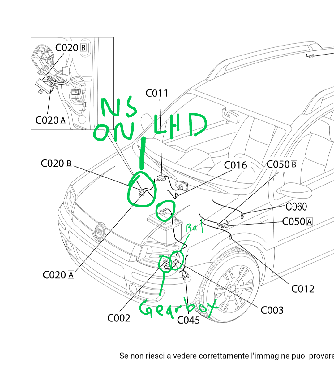

Are there any diagrams for the earth leads ground ect
Sure

Id start thith the battery terminal and chassis rail/leg
The BSI is earthed to the chassis via a connector on the passengers door A post, But is the chassis could already be hit so check the rail fist
Clean the top of the lead battery negative terminal to shiny metal one probe here
File a bit of the top of stud on the chassis rail to shiny metal, other probe here
