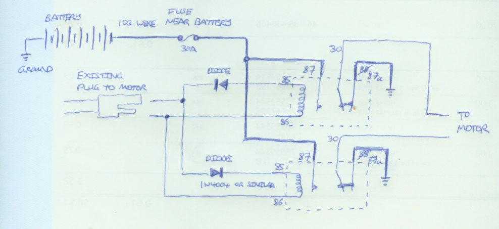

Now for the 2013 revival... I linked to this from the temp Turbo Collective forum as someone needs the relay setup (y)
I'll not use it as I have winders in my Uno Turbo, and it's not been out the garage for 7 years :(

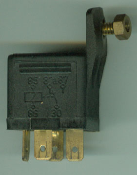

Alex this is perfect help, should have my lecky windows back to normal again.
that be me then lol
thanks Louie
You're both too kind :eek:
Good luck with it... For my Uno I found it useful to pour some engine oil (with an oilcan) into the translucent plastic tube that takes the 'excess' flexible rack as the window winds down.
