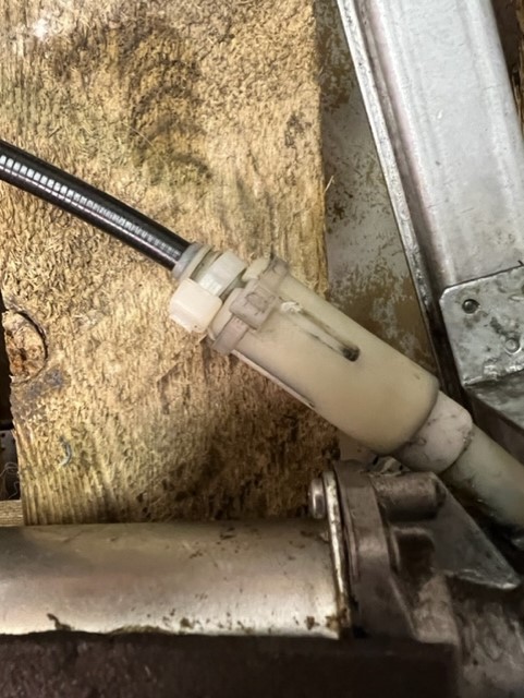

Update 3:
I kindly received feedback from Panagiotis Boudaniotis via YouTube that the mission of the spring loaded contraption is to adjust the wire tension, but in my case time has taken its toll on the plastic teeth. In the picture below you can see how the teeth are supposed to look like on the first two rows from the left as compared to the ones thereafter.
My theory is that the flexibility, because of the tooth degradation, has become too generous, and the wire inside the "gearbox" with too much slack leaves its track and jumps up over its neighbouring wire (moving in the opposite direction) causing noise and high friction. At worst this results in a jammed window. With Murphy's law that will be in rain, sleet, snow or all of it at once.
Buying a new window driver assembly will fully sort this problem out, but having to buy new everything (€413 for the drivers side) just because a small plastic thing worth €1 has worn out bugs me, not to speak of the environmental aspect. My solution, that should at best be temporary, involves two cable ties, please see picture below:
At first I sorted the bungled wires out in the "gearbox" and thereafter ran the window driver assembly (without the cable ties). Already after the first run, the noise was back and thereafter the driver started getting obstructed. I could see how the wire tension adjustor was moving both left and right depending on if the driver was moving up or down.
After adding the cable ties the wire tension adjustor's movement to the left has been arrested, it can only move to the right (becoming tighter). Since then the driver "gearbox" problem has not re-appeared during a handful of test runs. My main concern is if the cable ties will be pushed out of position by the rather violent jolts from the window driver. I'll run the driver some more, and then I might attempt to glue the cable ties in position, before attempting to re-install the driver.
Update 4:
I decided to chance it and see how long my hack might work.
I did alter the setup somewhat by replacing the one larger cable tie (on the left cable side) with three smaller ones. First I filed down the broken teeth to hopefully get a more snug fit. The remaining teeth in good condition should also offer some support. After tightening up the three cable ties I added some hot glue for shock absorption and hoping it might assist in keeping the cable ties in place. After running the window driver assembly some more out of the door without noise and/or jamming, I re-installed it in the door including attaching the window. It works fine so far...

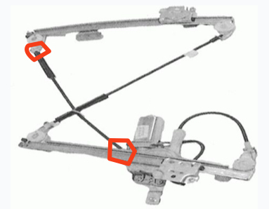

Now what to do...:
Purchase new assembly (ePER 51742726)? It seems unique for barchetta, is out of stock and/or ridiculously expensive.
Purchase used? Might be aged plastic/rubber parts there as well.
Repair? Questionable longevity.
Purchase similar new assembly and pick it for parts? This is the best alternative I believe...
Anyone got suggestions on source and/or OE part number for "best" similar assembly (the parts I want to source are the adjusters, at both ends of the cable, circled in pic)?

Update 7:
Being left abandoned by all y'all, I ended up keeping the old assembly and doing some more replacing and hacking...
1) I ordered new dampeners from/via Temu, they fit and seem to do the job and have a good soft (low (40?) Shore value) for the jolting impact from the sleds/elevators/window holders(?). I ended up replacing all four.
2) the upper left adjustor (see red circle in pic in #10) was replaced by an aluminum mountain bike cable adjustor from the local bike shop. It's a good fit (hopefully it'll fit inside the door as well). I'm a bit concerned about how bad the alu. is going to react with the iron/moisture combo plus the jolting movement of the regulator on the soft threads... The lower right red ring adjustor (#10 (and close ups in #7)) got a slightly oversized hose clamp replacing one of the cable ties (to stop the tensioner from going in the wrong direction). I hope it'll hold longer than the cable ties' 2,5yrs.
3) the electric motor has a cylindrical anti-vibration mount. The mount had come apart already last time I worked on the assembly. Without much conviction, I hot-glued it together. It did not last... This time around I ordered a new mount (low Shore count, M6, 10x20mm, double studs). I found them on a RC boat web site.
I'm also applying Locktite 243 on the various threads as I don't know the torque, and several nuts came loose from last time.
