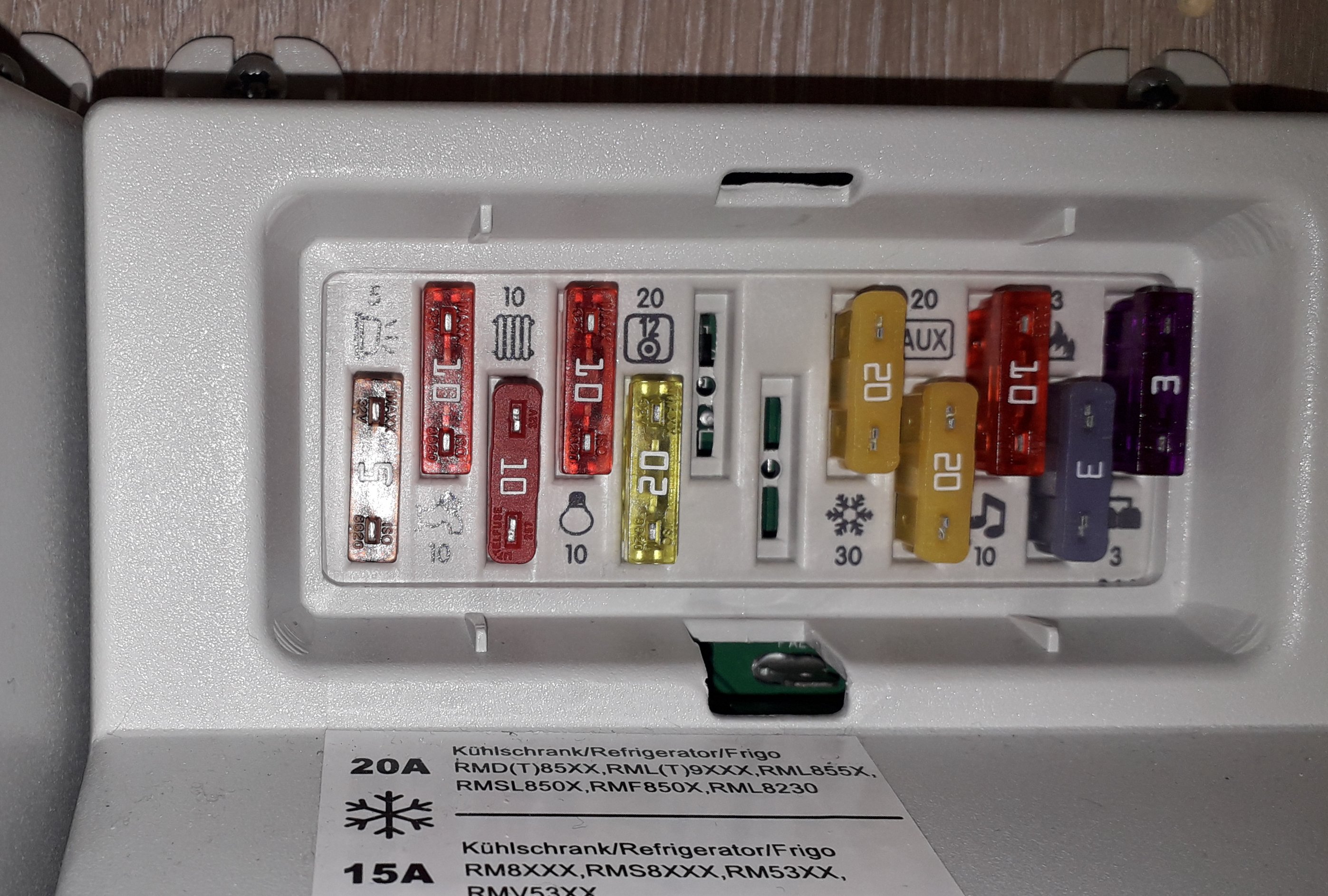

Hi, I have a 2015 Fuat Ducato Rapido 600FF and the electric drop down bed has stopped working and no power getting to the control panel. Can someone point me in the direction of the firebox that controls the bed. I have found the one under the dash and also in cupboard in bathroom but both don’t have the fuse in question. Thank you

Hello,
It's 100% Rapido specific. Have you got their owner's manual? If not, contact them, they should be able to provide you one. Or tell where the fuse should be located.
In the standard Ducato that were delivered to the converter companies there are 3 fuseboxes: the one by the driver's outside knee, the one in the engine bay by the ECU and on the bottom of the B-pillar on the right hand side. This one was optionnal, but it facilitates the connections, so I assume most of the converters ordered it.
Usually the converter connects the MH part of the installation to this last one factory fusebox and usually adds his own fuseboxes further on to control the MH part. So, as stated in the beginning, if you don't have the Rapido manual or it is not listed there, contact them directly.
aTTACHED Fuse box is from a Rapido 604ff 2017 the model that superceeds yours. i suspect you have a simular cbe fusebox . I have had grief with the programming of the bed but never had fuse go. Possibly one of the 20A fuses (aux most likely). edit location of my fuse box is in the Ski cupboard.
Have you got project 2000 bed details? i will post if requiredView attachment 464314
Yes I have the same but bed is not in there
